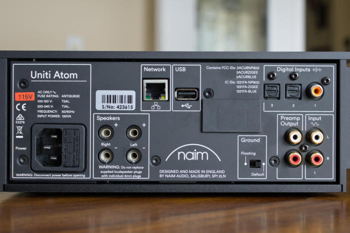

Any conclusions from the earth/ground tests? My guess is that any effect will be system-equipment chain dependent so a switchable 'float/ground' option may be best. Noted this option in the new streamer from Naim...
Yeap thats exactly what we will have (sw floating / ground)
