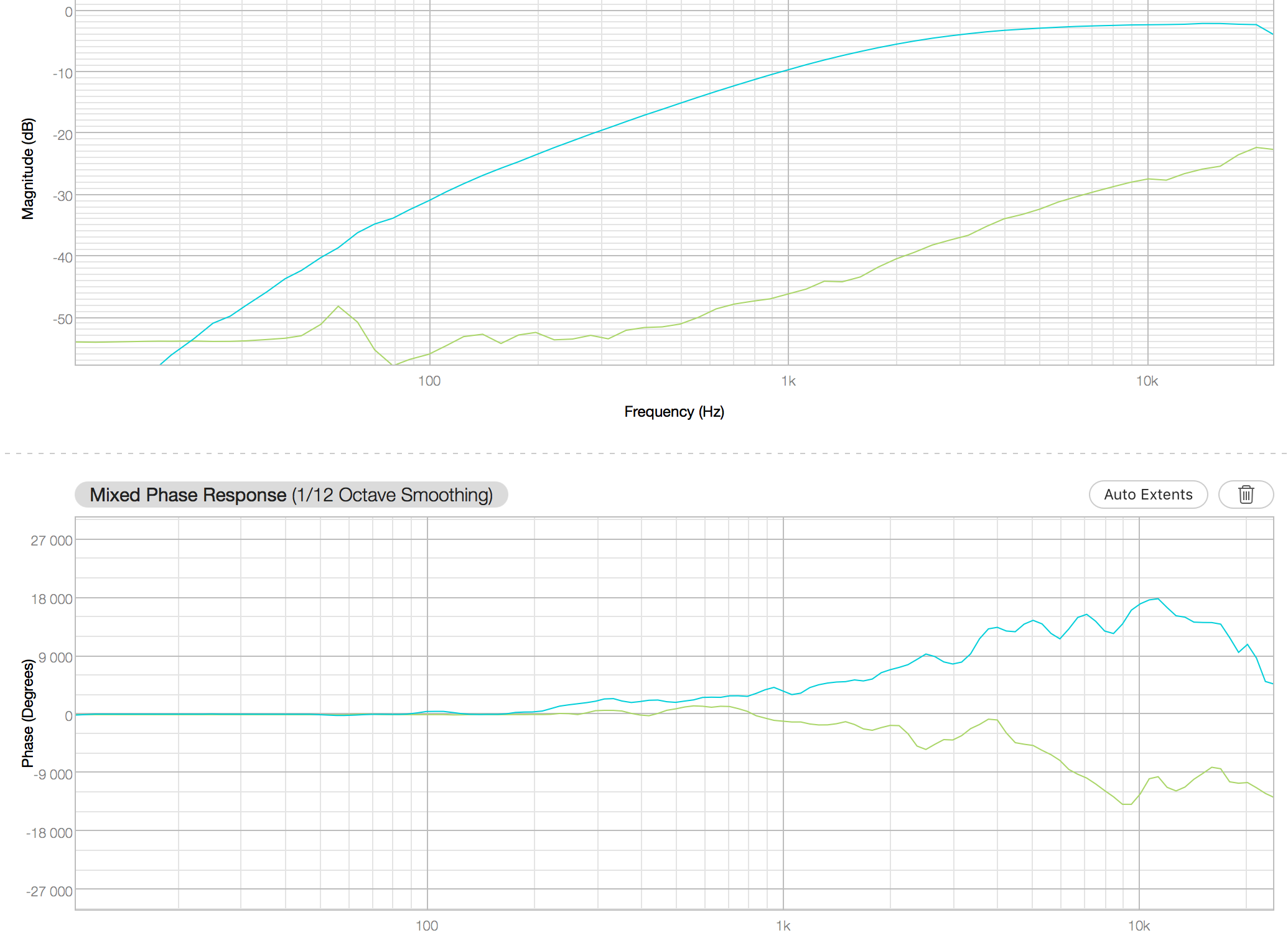

Try measuring the reference channel as well then taking the difference. That way the capacitor in the headphone output will be cancelled out and you should get a straight line for blue.
You should also make a measurement with a short circuit across the DUT connection point, and one with say a 1 ohm resistor in place of the DUT, these three measurements can then be used to calibrate the instrument.
Regards, Dan.
Regards, Dan.

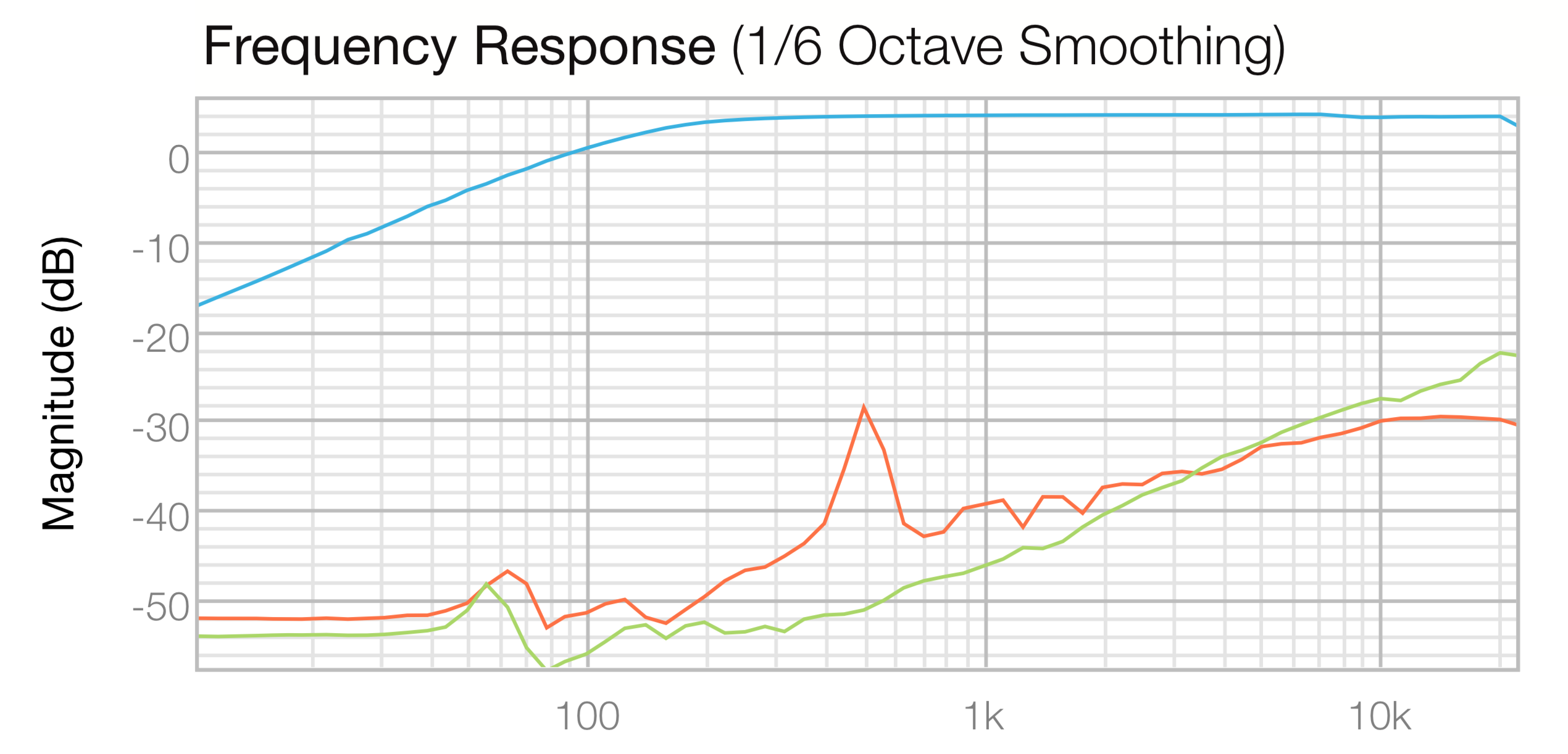

Green: Short instead of DUT
Red: 2r2 instead of DUT

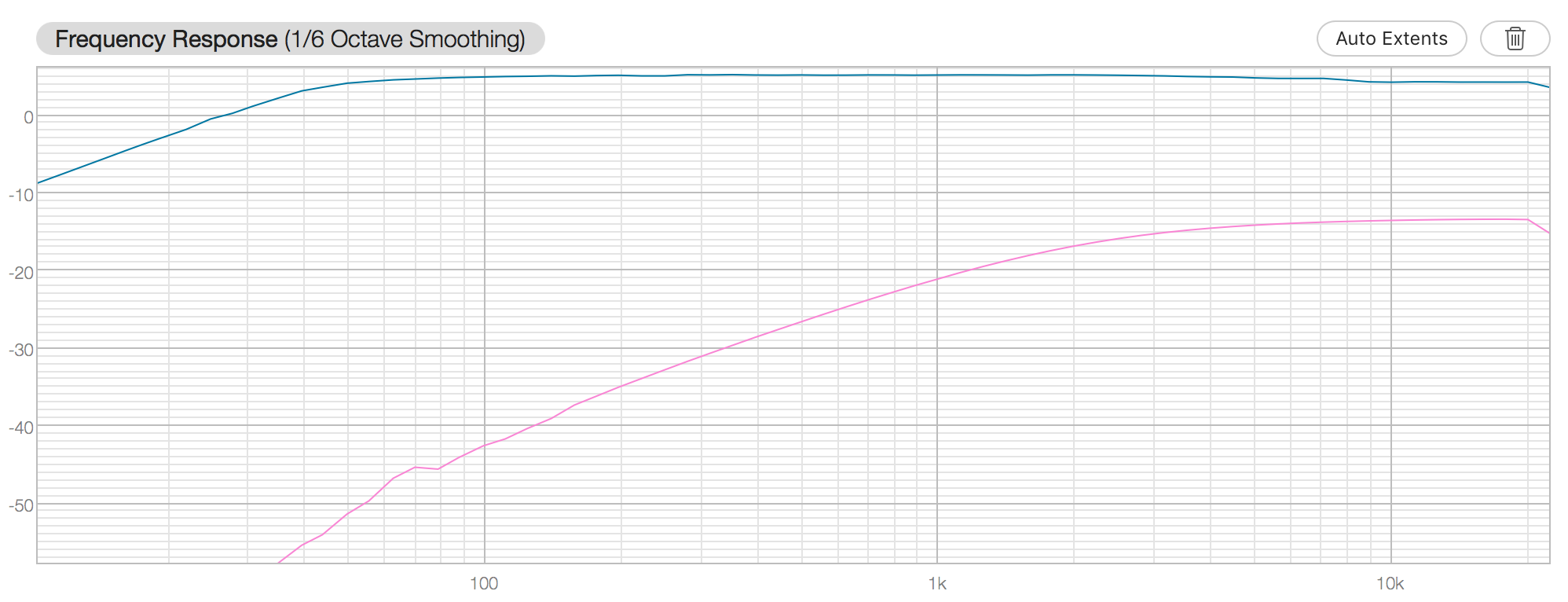

In-2 view.
Both cases has load connected!
Ignore above post!
In-2 view.
Ignore above post!

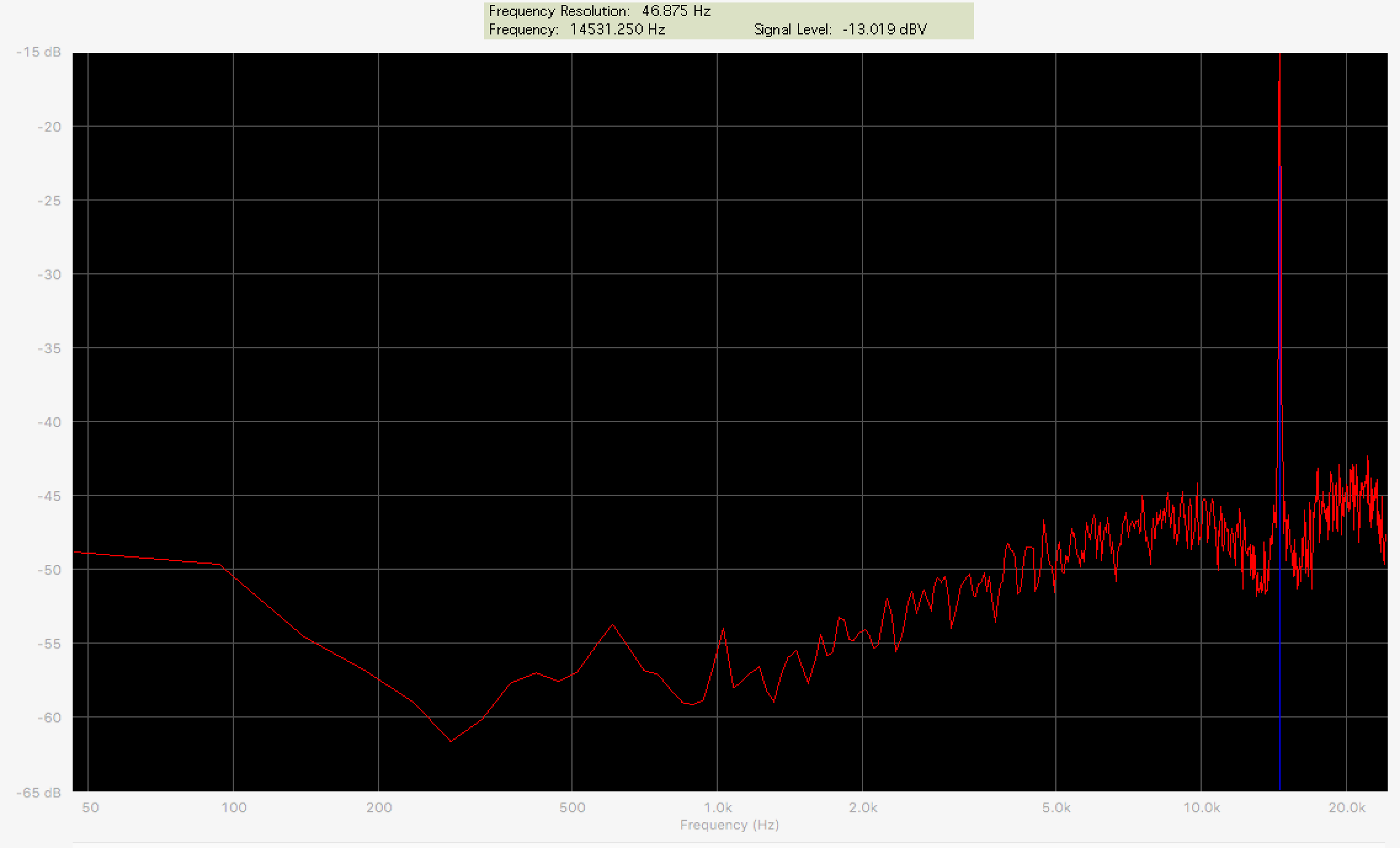

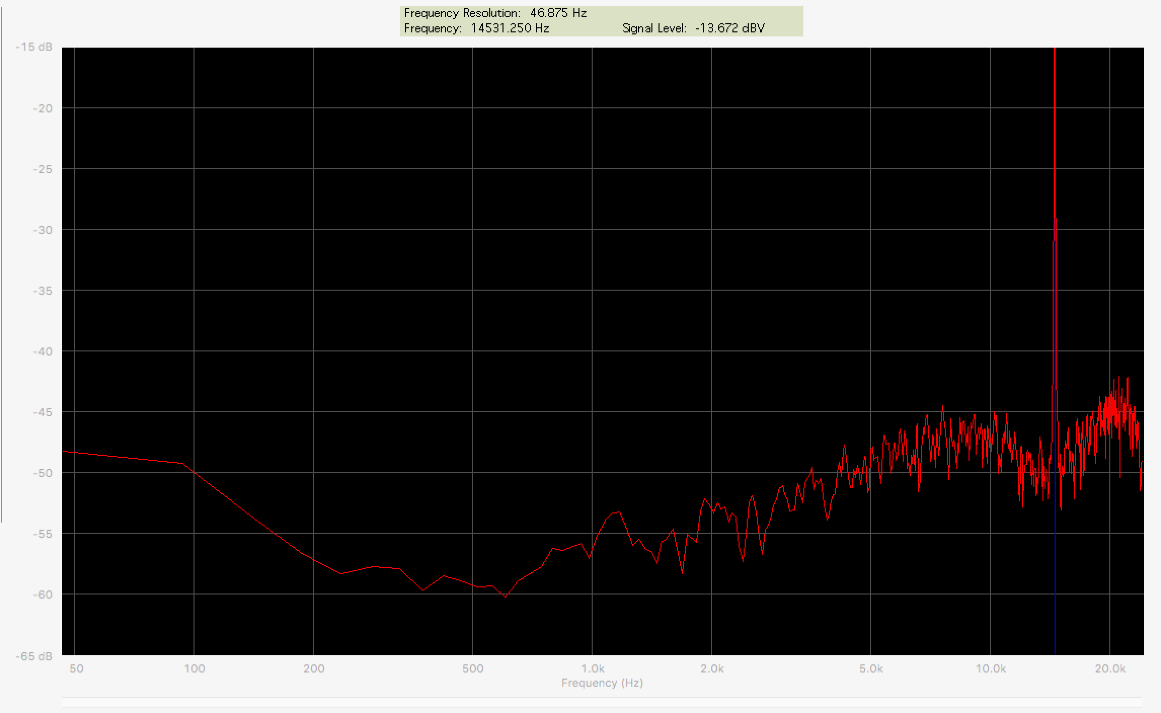

J-P was correct. I did indeed not have a PE. I looked at the outlet today and no PE 8-o. So here new measurements comparing no PE and PE connected.
Still, no diff really...
No PE first, the with PE.

Something odd going on there, with the DUT shorted out you should clearly be seeing just the sound card self noise plus any crosstalk on in2, I would expect a line down around -100dBFs or so!
Of course Ideally your measures would be referenced to In1, but the shorted case should still clearly be WAAAY down in the grass.
A 2.2 ohm resistor with 22 ohms as the source impedance should be giving you a line about 20dB below the In 1 level.
Either that sound card has the crosstalk very much worse then I would expect of this place or something else is very wrong.
Regards, Dan.
