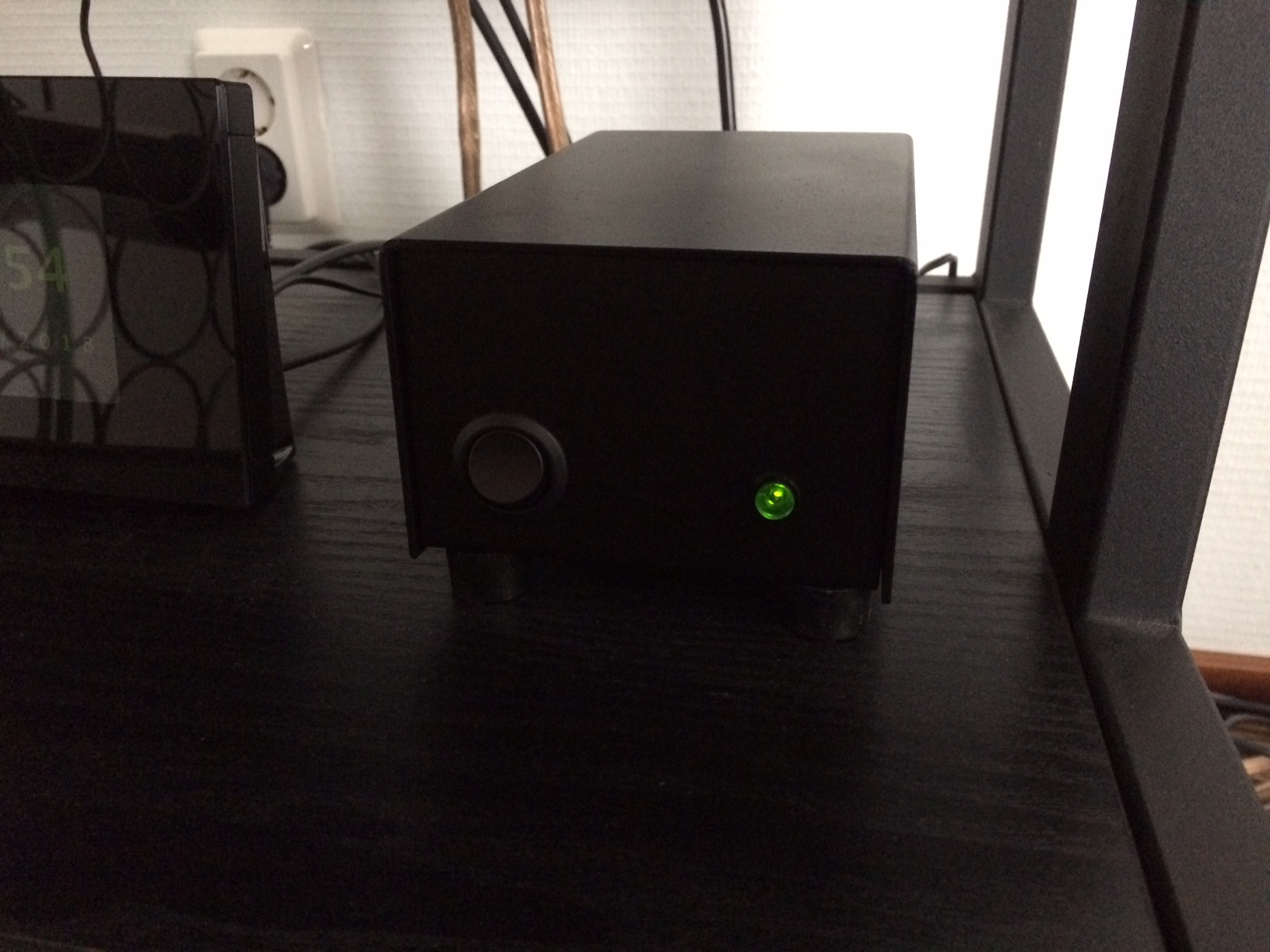

So... many choices but what does the average serious audiophile want ? 1, 2 or 3 outputs ? I would think/assume that 2 outputs will do just fine for most. On the picture you see the way I solved the adapter issue. It's small, reliable, low noise and has a true mains switch. Off means off.

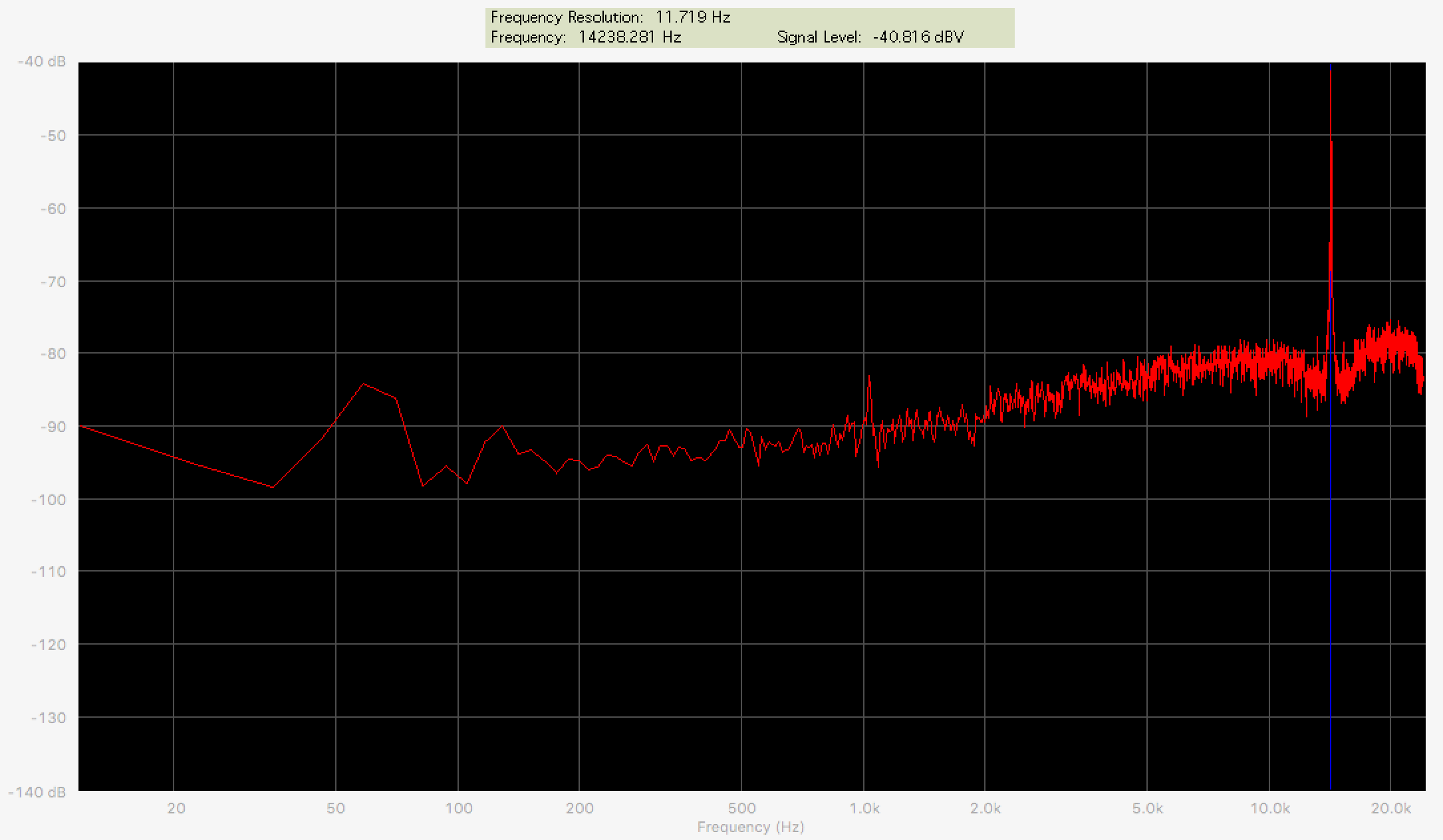

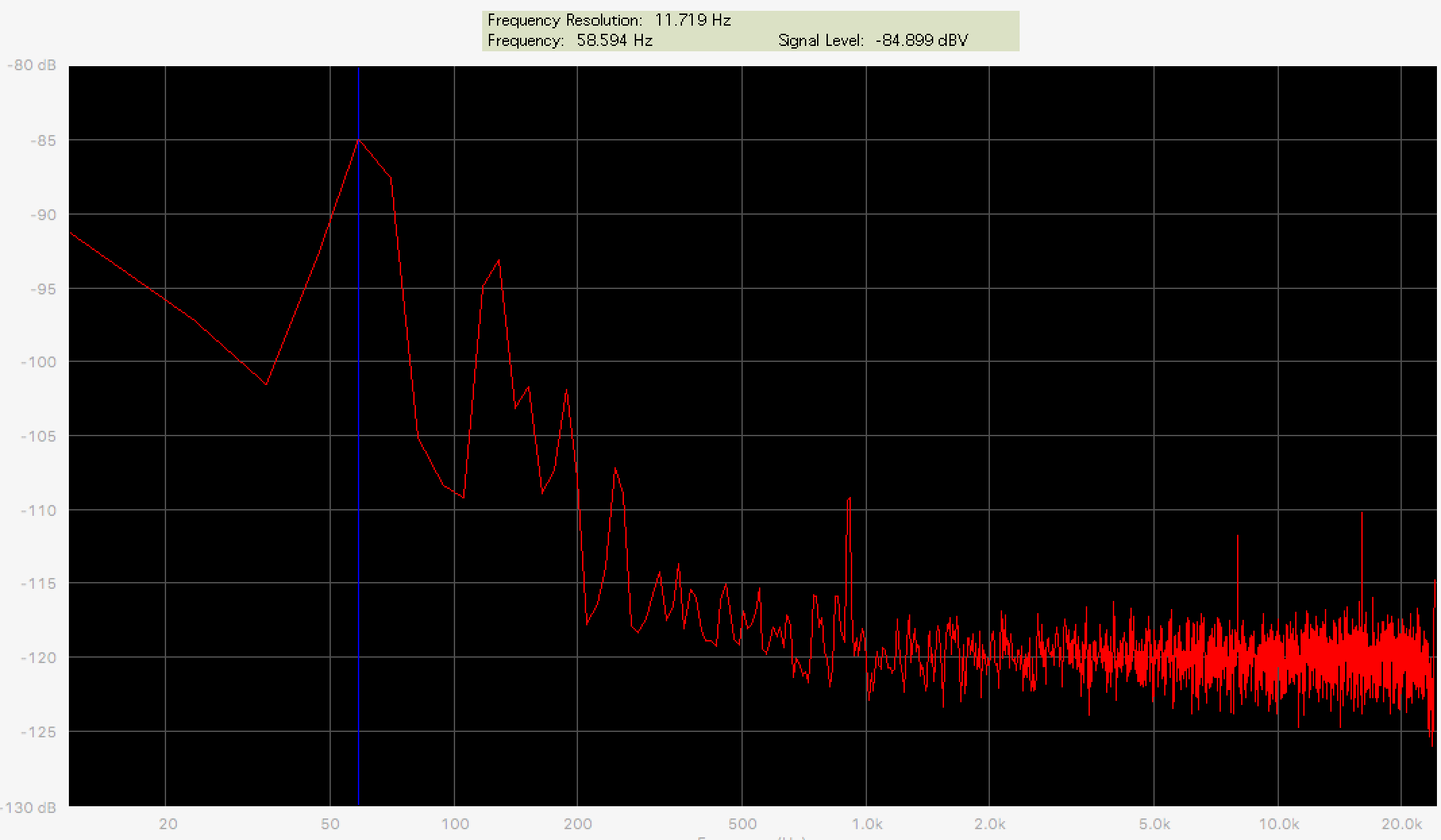

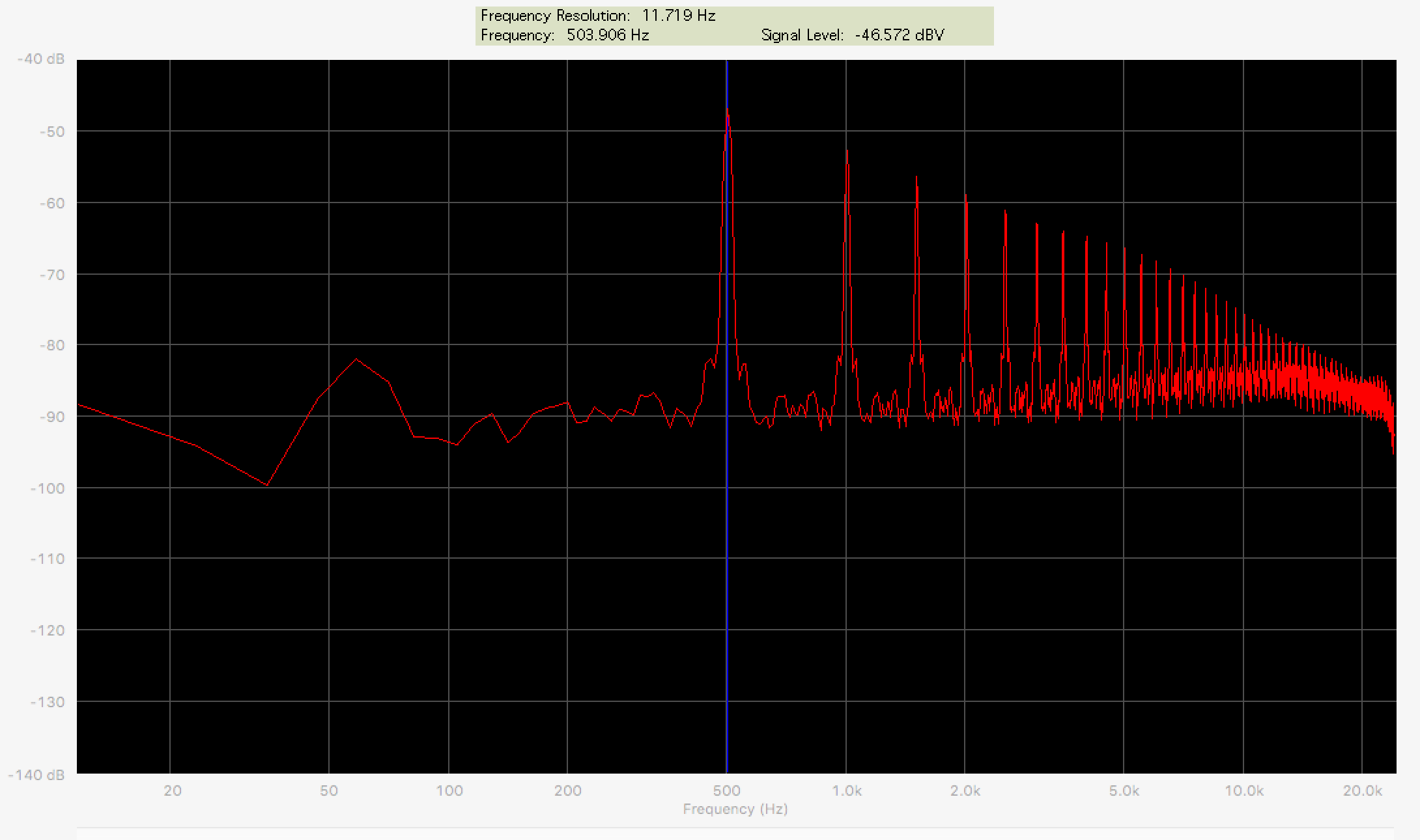

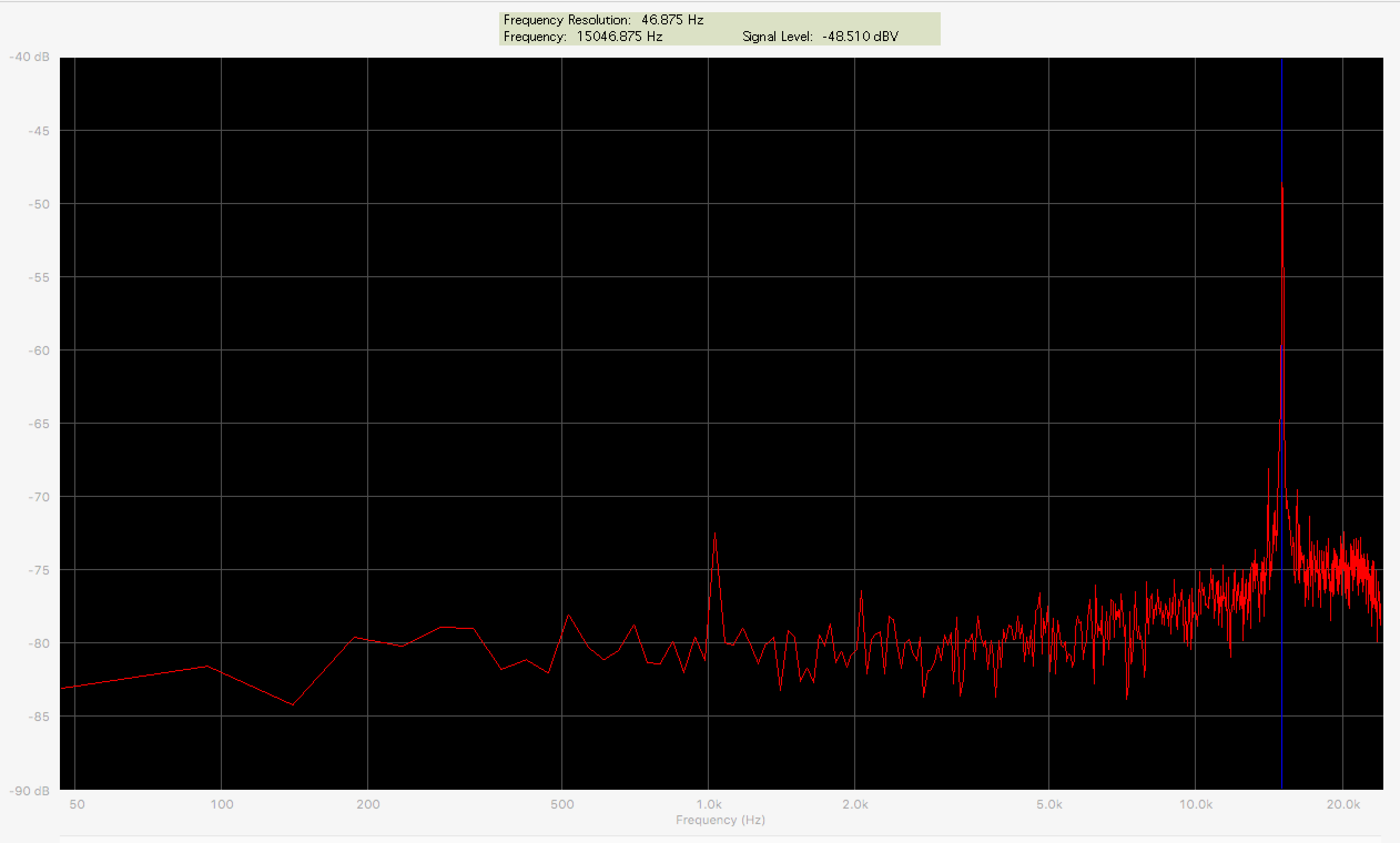

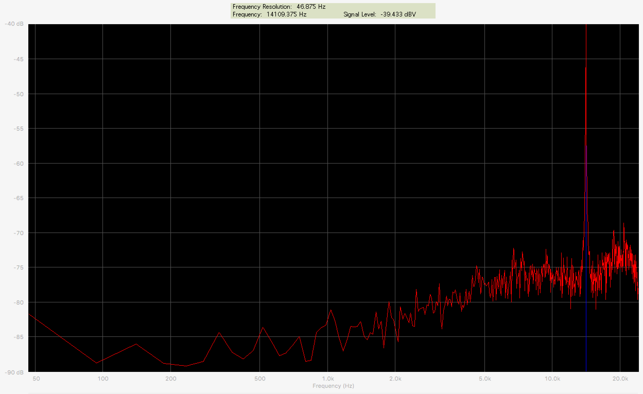

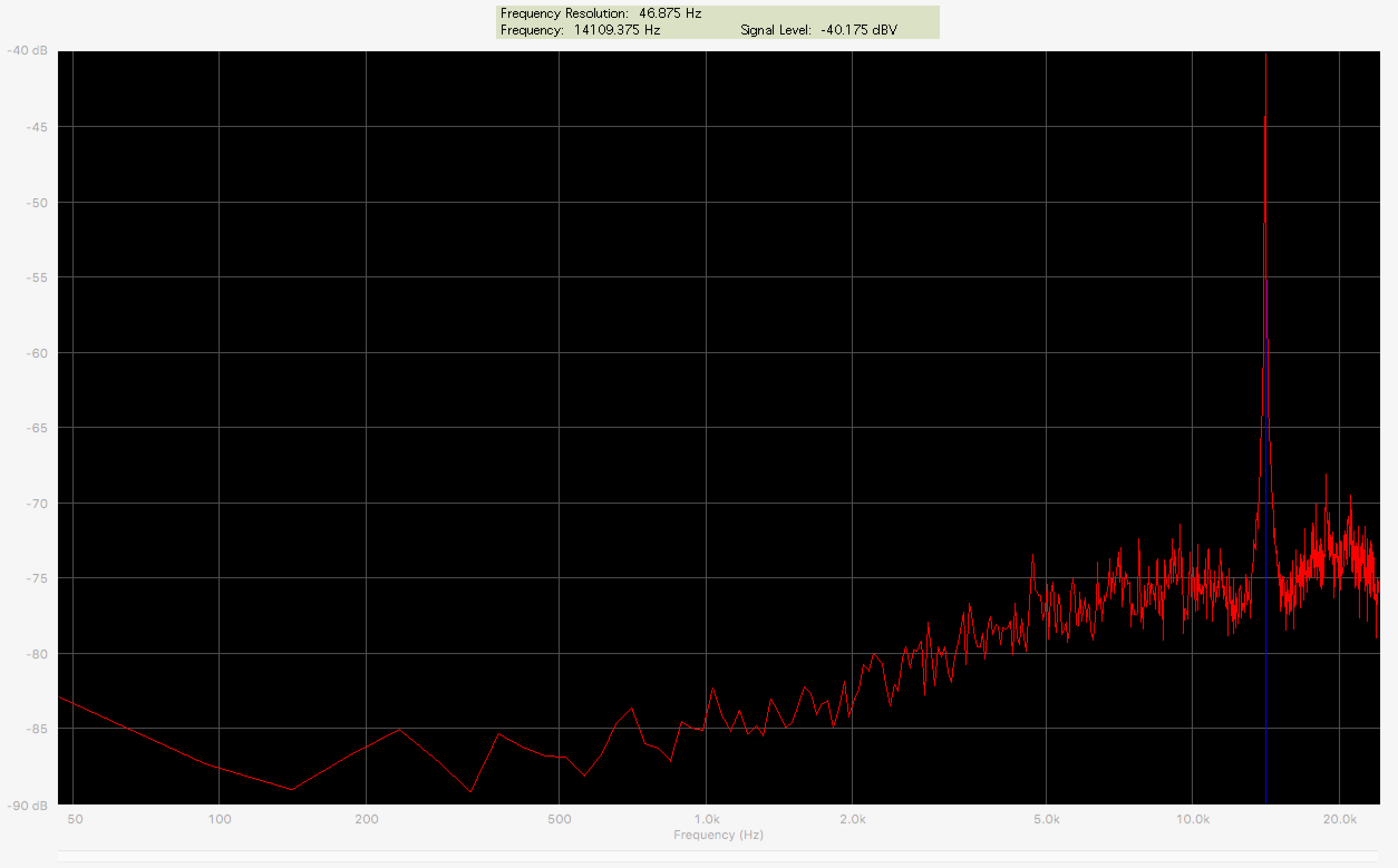

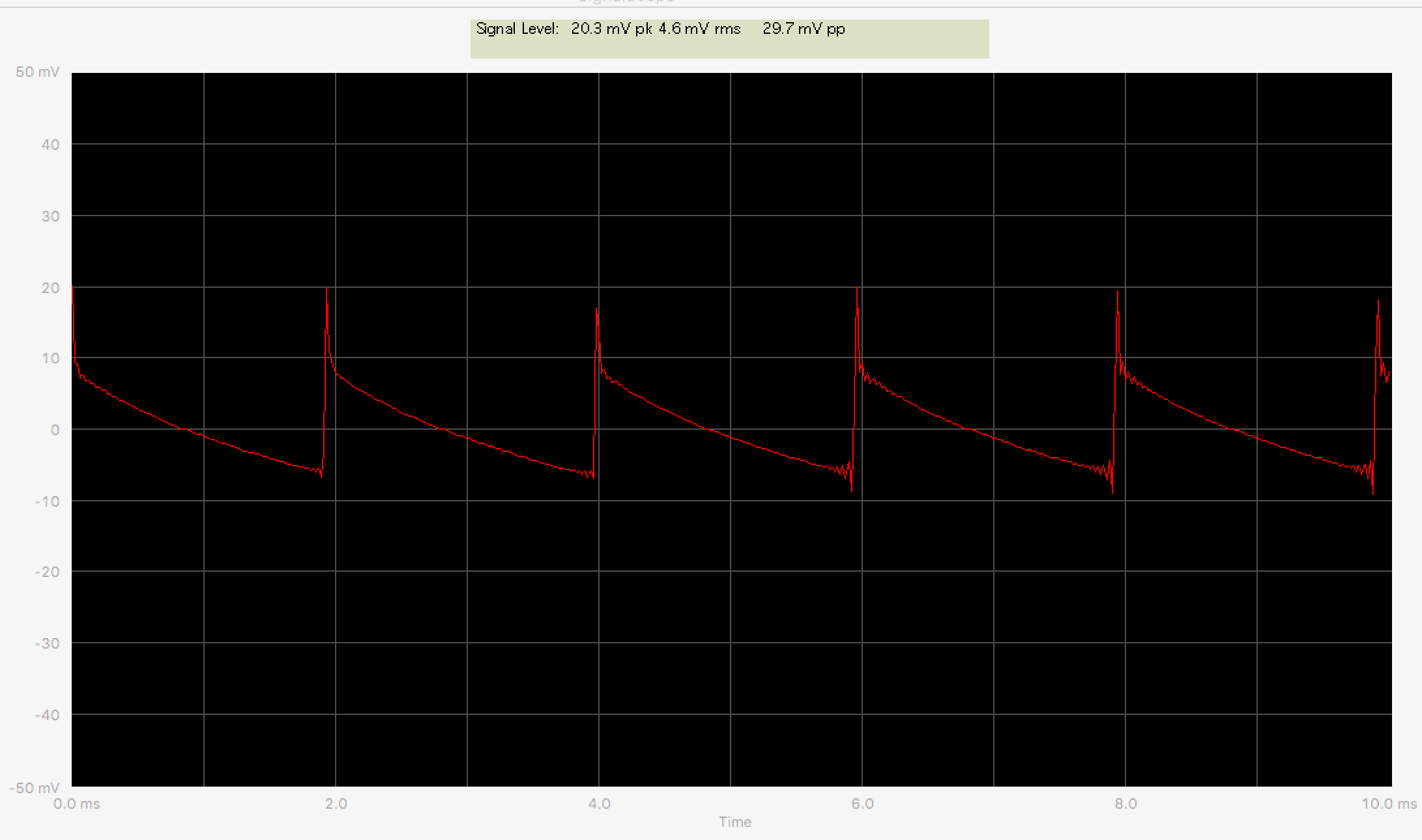

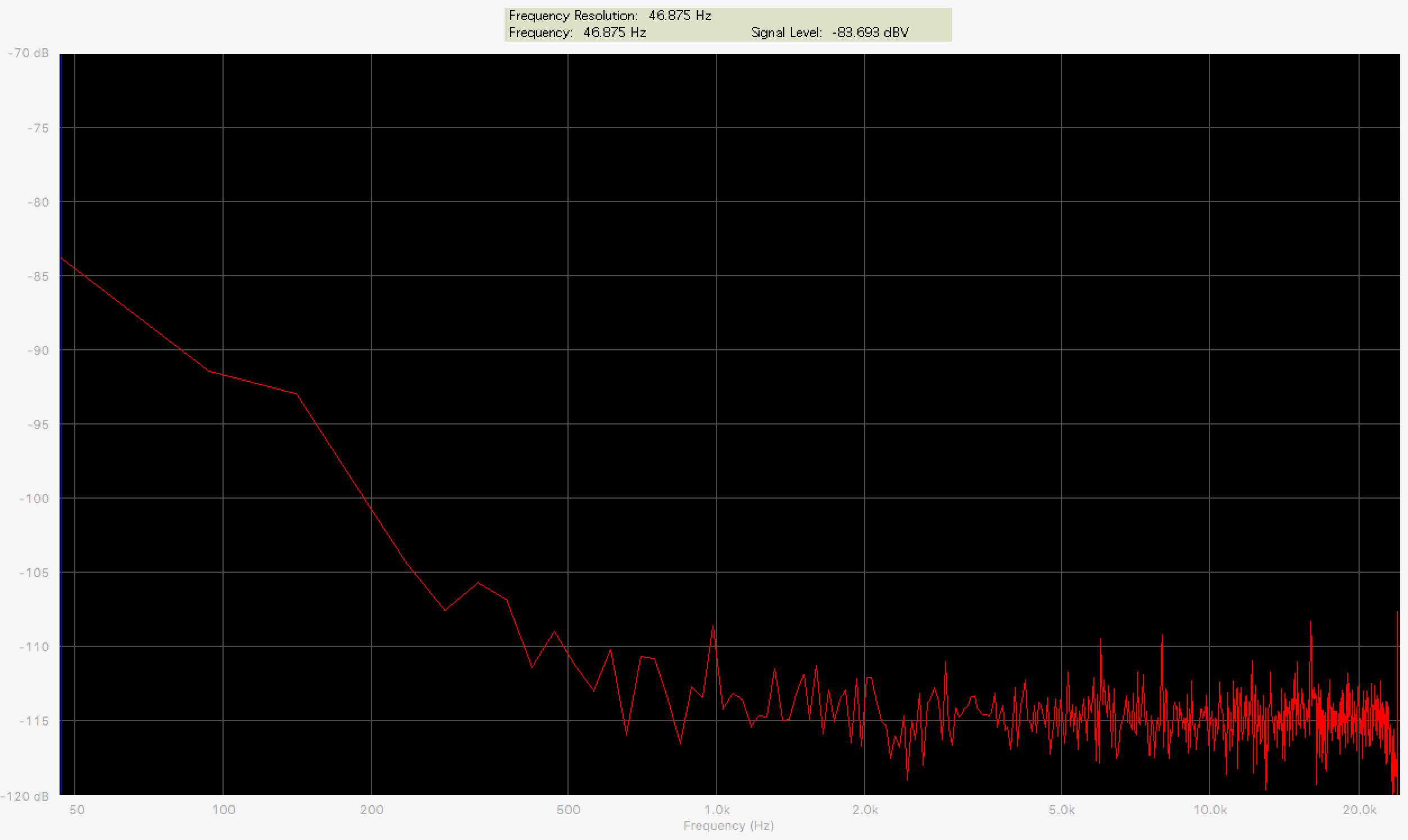

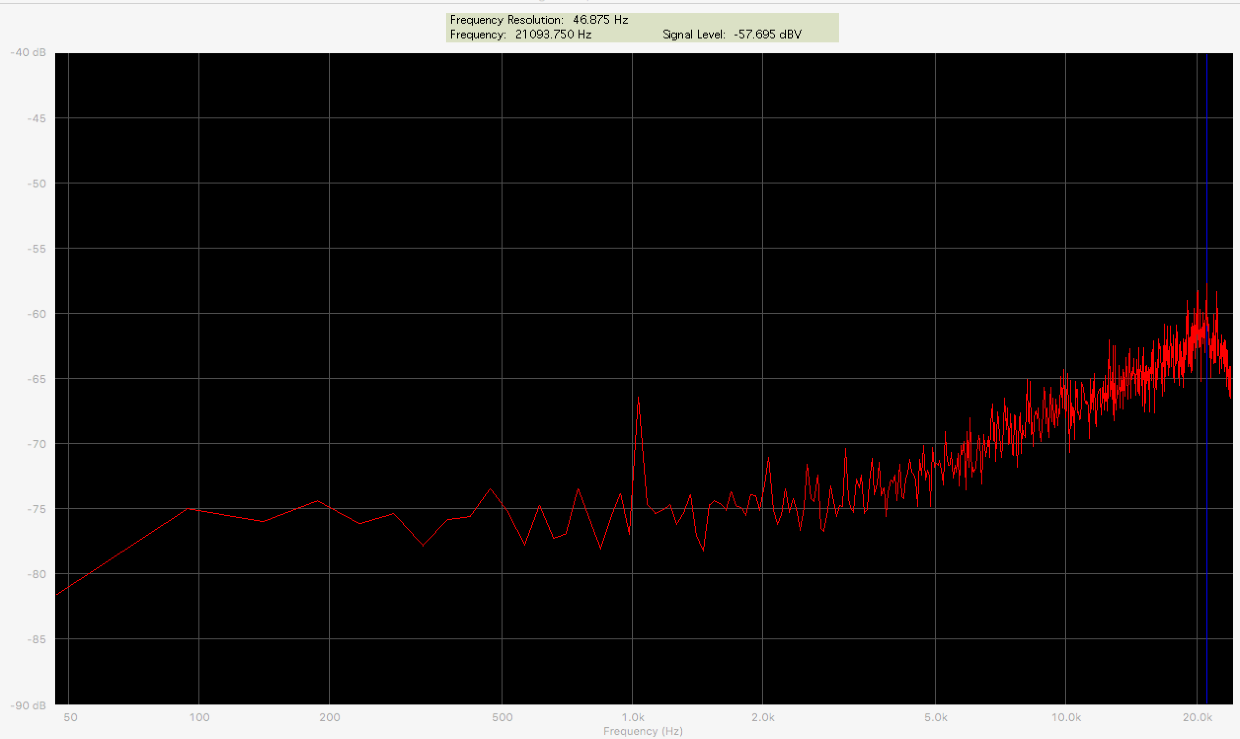

Some loaded and unloaded measurements made today of Meanwell RS15-5. FFT and osc. Load was 40ohm / 120mA. Used Edirol Quad Capture @ 48khz/24b. AVO said 5,092V.
NB: Absolute levels not calibrated so not correct!! I had 1uF in series with probe to protect my soundcard. The DUT was not connected to PE.
Laptop off the mains grid. 50Hz territory.
Left to right: no load OSC, no load FFT, load OSC, load FFT, shorted probe.
Just to repeat about my similar tests. The Meanwell at 27V 1.2A ( 22R load )150Hz to 40kHz was -90dBV and from 10kHz to 20kHz -65dBV. I take this to be due to a constant load at a constant 243VAC causing a repetative switching period. If 115V it would be different. There are other measurements which could be worse or not important depending on how you see them. In my opinion just part of the engineering. If you like it's the electronic version of washing hands to engineer them out.
One interesting idea you might like to try is adding a 320VDC block or whatever to the SMPS input ( I used 220uF 500V caps and a rectifier, 4 x 220uF 250V in fact, I have a few 10's of them ). In theory it should upgrade the ripple noise. I didn't find it did. Perhaps the problem is connected with the switching or phase shift. For equal fun use a low quality AC inverter. My hunch is it will not be vastly different. Right or wrong that would be interesting.

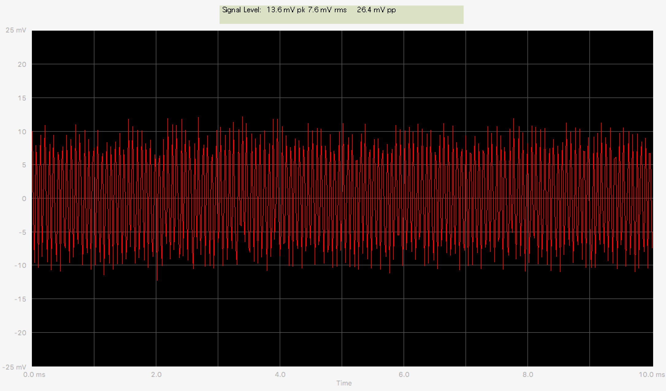

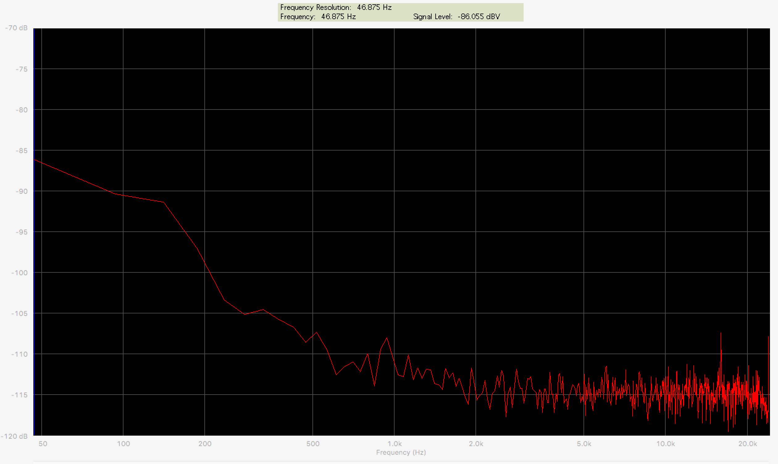

Both. It would be a good test to measure with PE connected if performance improves.
I could not see a significant difference - well maybe with PE is a little bit more noisy actually. First measurement with PE then just pulling off the PE connection...
  • MW RS15-5 load FFT w:o PE.png
