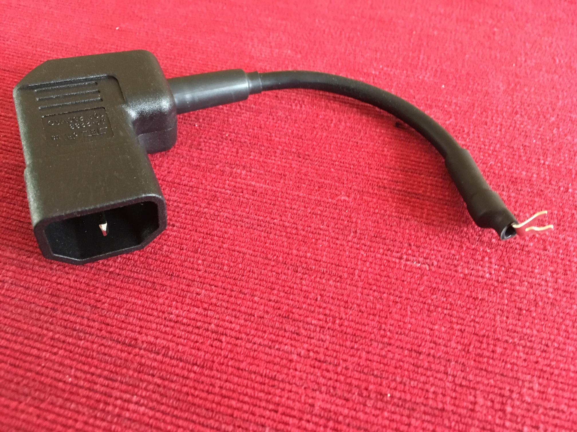

iFi grounding adapter
iFi can supply this for ~$13 inc shipping in the US. Resistance to ground is ~ 15 Ohm.
Thanks, Chris, I will try to get one pair, and compare the IFI with the battery again.
... what about a much cheaper and easier to accomodate alternative: a dummy mains plug (EU/UK/AU/US/JP) where a non-descript wire is soldered to the 'earth' pin (the other end being connected/soldered to the 'negative' output of the PSU
My idea would be to keep the ground impedance as low as possible.
And I'd also try to avoid creating new antennas. Obviously there's a catch.
All these el-cheapo plugs and connectors are IMO all but optimal.
I do have all my stuff (amp/dac/pi - all sitting side-by-side on one board) stargrounded via Wago terminals - without connecting them straight to earth.
Perhaps I try that ground-wire idea one day.
