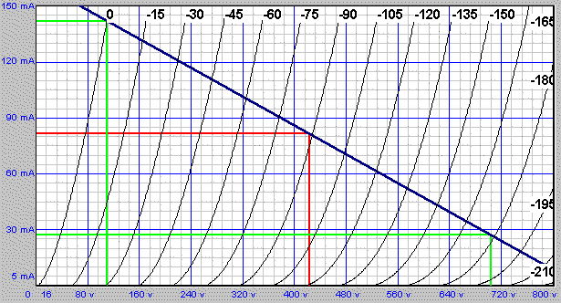

As you know I use -more than a decade- 5k:8 OPT in my 300B SE (about 400V B+, 385V, 70mA fixed bias operating point).
This amp capable even 10W (due FET source follower, which drives 300B grid directly up to about +20-30V to clipping).
p.s.
It's a good 5k loadline for 300B.
Requires 180Vpp grid driving, but operates within A1.
p.s.
