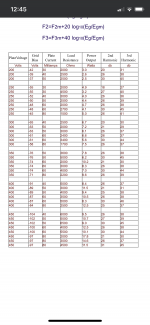

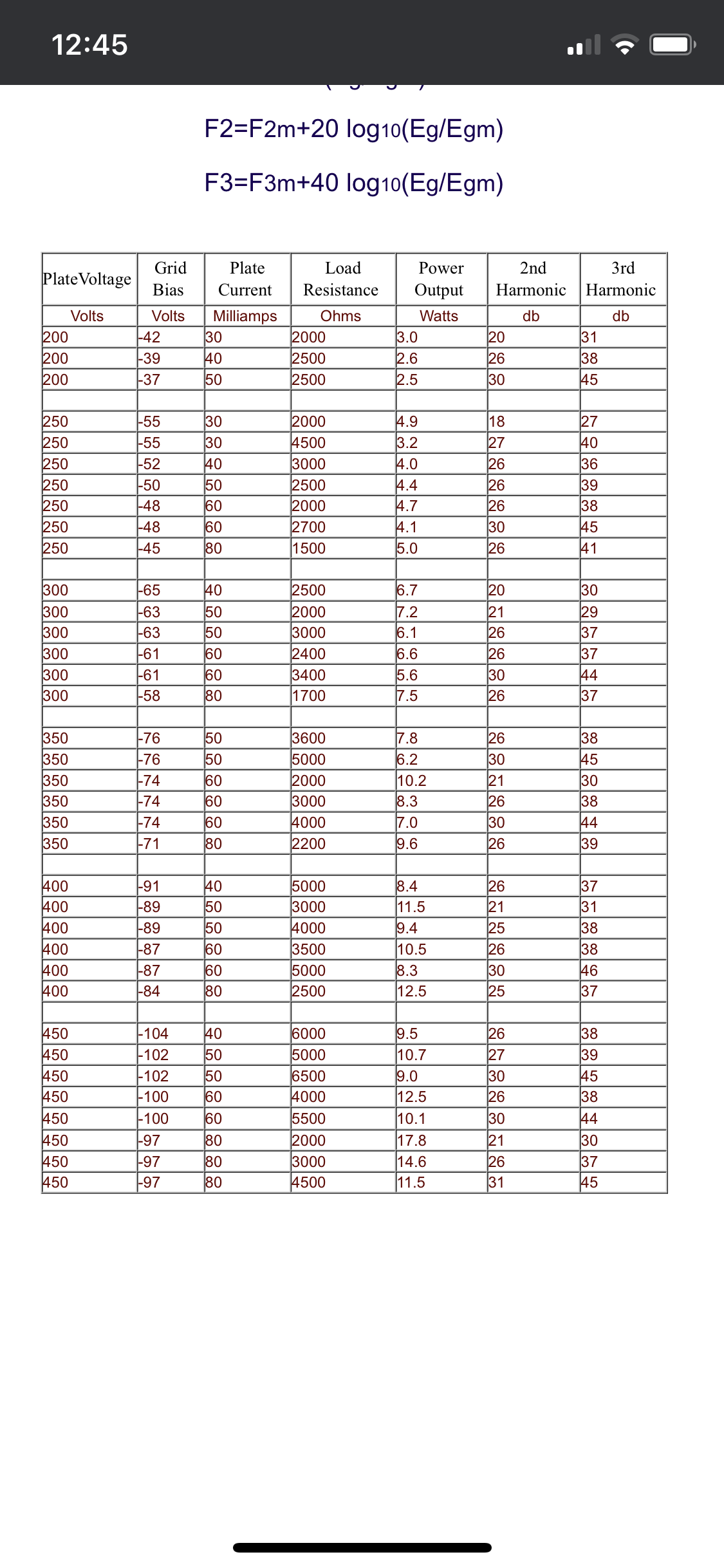

Martin Seddon (Azura Horn), in OZ, suggested exactly this OP from the 300B Tables for a DC coupled Monkey Amp 6, 7, 8 years ago on the JoeList. That one is in my queue and requires a 200H choke which I've since sourced.
They're not highlighted in the table, but do note the H2 and H3 levels.
I'm sure Andy would say "EXPERIMENT!"
Very Best,
Robert
itsikhefitz,
You picked the operating conditions that bring the lowest distortion and highest primary impedance on that whole chart.
A clean 6.2 Watts is very good, and should be better than a little more power that has a lot higher distortion.
And the damping factor of your selected operating condition is the best.
Have fun building, and have fun listening.
Robert, my handle is simply my full name !
Thank you both for the motivation!
I noticed the H2 and H3. Those are in dB below the fundamental, correct? If so, that would
make them the lowest distortion point in the chart as 6A3sUMMER points out.

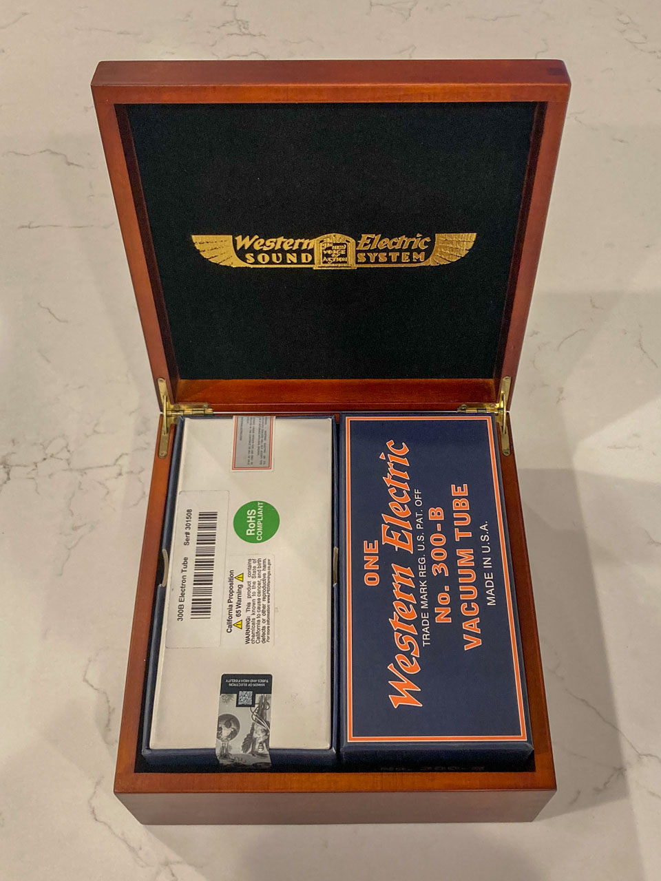

BTW, received this nice package from Rossville, GA this week.... but I don't think they will go into an amp any time soon. The boxes will likely remain sealed, stored somewhere safe.
Are they new manufacture? Just curious with the RoHS certification.. Just googled and yes - nice.. wonders when the 2a3 production will start too (pure speculation!)
Yes these were manufactured this year and purchased directly from W.E.
QR code is another hint 🙂
itsikhefez: There are other operating points that are similarly low distortion. The output transformers primary impedance appears to be the most significant factor in attaining low distortion. If you have a chance, check out the full chart. I remember a couple of pages of OP charts, but didn’t find it just now in a quick search. Have a look at this more full chart I found. While it is a small difference, the lowest distortion is on the last OP on the list, which is into a 5K OPT primary, and puts out 11.5 Watts!

The sweet spot for current looks like 60mA which is what they recommend. But unless I've missed something, this doesn't indicate what the OPT is actually gapped for. Am I right in thinking these are theoretical figures, and not derived from actual tests on OPTs?
andyjevans: if you look at the last three rows in the chart I posted above, there are three operating points at 80 mA with OPT primary impedances increasing as you move towards the bottom. Distortion and output power drop as primary impedance increases. This is at a high 80 mA. There is a substantial increase in distortion as impedance drops. In general, lower distortion is associated with higher primary impedance. Inductance is certainly relevant, but it’s going to vary greatly from OPT to OPT, and is more about OPT quality than anything else. A chart similar to the one I posted above that used inductance would be interesting, but not as useable as a reference. I think it would be best to use the WE chart to pick an OP, and then pick an OPT based on other quality factors and your budget.
