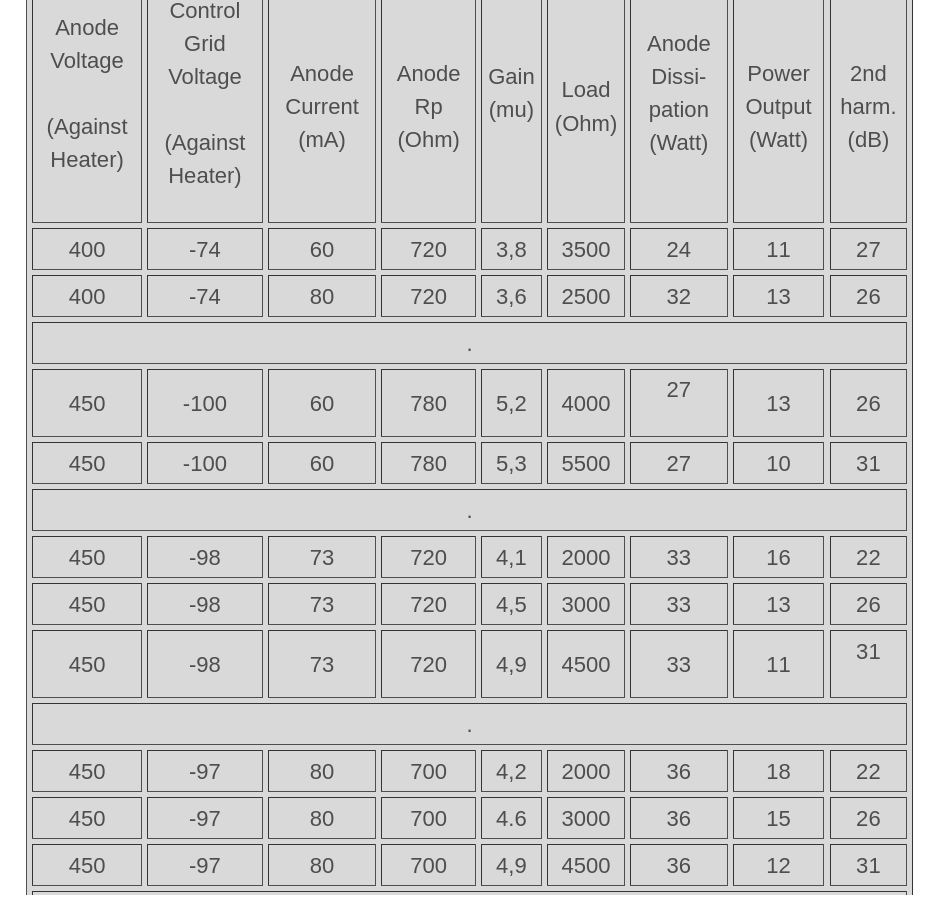

5k is too big, 4k with no more that 150ohm primary resistence , 0.32mm wire at less.
I have a Monolith Magnetic Amorphous core sound very good, and frequency range are good too.
With 5k move little current, 300b with 3.5k has less than 5% thd At 8w is too low, 4k or 3.8k enough.

It depends on what you are looking for. I prioritize lower distortion over higher watts because I don’t need much output power with my speakers. If you need all the watts possible, it makes sense to use a lower primary impedance if it’s going to get you closer to what you need. The data available for the 300B is comprehensive, and includes tables of operating points at different primary impedances and output and distortion figures. You can decide for yourself what you prefer.
speaker are not 8ohm more like 6 ... the reflect load is lower ,damping factor is more important then Tdh you can use more current and B+ were is the problem ?5k is too big, 4k with no more that 150ohm primary resistence , 0.32mm wire at less.
I suggest eml 300Bxls you can put more then 10w ,take look at working point...

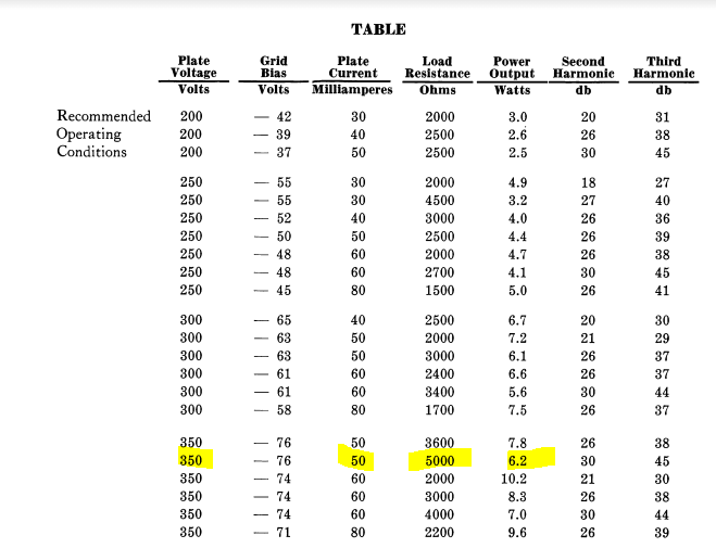

I've gone back to using a 300b output stage after years of PSE 4P1L. Currently using a LL1682/50mA which is 5.5K into 5 Ohms. I must say it sounds very nice. I'm running it at around 300v and 50mA. I've read several times about preferring a 5K OPT for the 300b, and I can see why. I don't need the 300b to run flat out and maybe that helps.
Andy, I've got a pair of LL1663/50mA, 5K:8 ohms. It was intended for an SE EL84 project but I ended up using Transcendar for that amp.
I've got a Tubelab SE PCB and was thinking of using the 1663/50mA for either a 300B or 2A3.
300B would be used at the 350V/50mA/5K for about 6 watts. Is this a good idea or should I try 2A3?
If a 300B can work decently in this operating point, I would prefer it as it would be more power, I hae a pair of 300B's and its filament requirement is easier.
Andy, I've got a pair of LL1663/50mA, 5K:8 ohms. If a 300B can work decently in this operating point, I would prefer it as it would be more power, I have a pair of 300B's and its filament requirement is easier.
I can give you some information about how I'm using my 300b amps, including a very similar one with LL1682/50mA outputs. I'll PM you. Andy
I believe Ivar (tubo) still has inventory of Onetics OPTs. At least he did in July 2020. Check this link for more details...
Onetics output transformer liquidation SALE
I'm not Andy, but Dear "What Do We Call You?", itsikhefez doesn't sound like an easy handle,
I'd say better get with the program and just do it!
Martin Seddon (Azura Horn), in OZ, suggested exactly this OP from the 300B Tables for a DC coupled Monkey Amp 6, 7, 8 years ago on the JoeList. That one is in my queue and requires a 200H choke which I've since sourced.
They're not highlighted in the table, but do note the H2 and H3 levels.
I'm sure Andy would say "EXPERIMENT!"
Very Best,
Robert
itsikhefitz,
You picked the operating conditions that bring the lowest distortion and highest primary impedance on that whole chart.
A clean 6.2 Watts is very good, and should be better than a little more power that has a lot higher distortion.
And the damping factor of your selected operating condition is the best.
Have fun building, and have fun listening.
