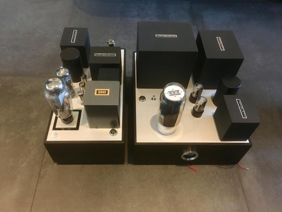

The Opt in the Gm70 amplifier is Monolith S-15
http://www.monolithmagnetics.com/si...70 single ended output transformer prelim.pdf They have sleeped in a shelf for some time.... A while after I received them Monolith released a version with amorph core, tempted to compare one day... Many years ago I buildt an amplifier with 13e1 se with plate to plate feedback. The first version was with LL 1693 http://www.lundahl.se/wp-content/uploads/datasheets/1693.pdf The second version was made with a custom Sowter OPT, the third version with A custom Monolith OPT. If memory serves, all three OPT’s meassured well in the Amplifier. From the simple Meassurements I was able to do, frequency response, THD and spectrum of output, I could not say that one behaved better than the others. However they did sound different..... I regret that I did not build a test rig to switch between them. The time between Pulling one out , putting one in makes comparision difficult. Maybe this is different for other ears, but I do not trust mine when I try to remember the sound of yesterdays OPT.

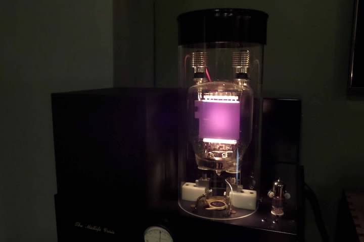

Monolith S-833 in my Midlife Crisis amps. No other OPTs I know of that can deliver bandwith of 8-66kHz at 1W using the 833C with 2.3kV on the plate. That BIG black block next to the 833 is the OPT. It weighs 63lbs.
Oh, and they sound great, too.
@Magz, impressive amps, bet you don't need any extra heating in that room 🙂
