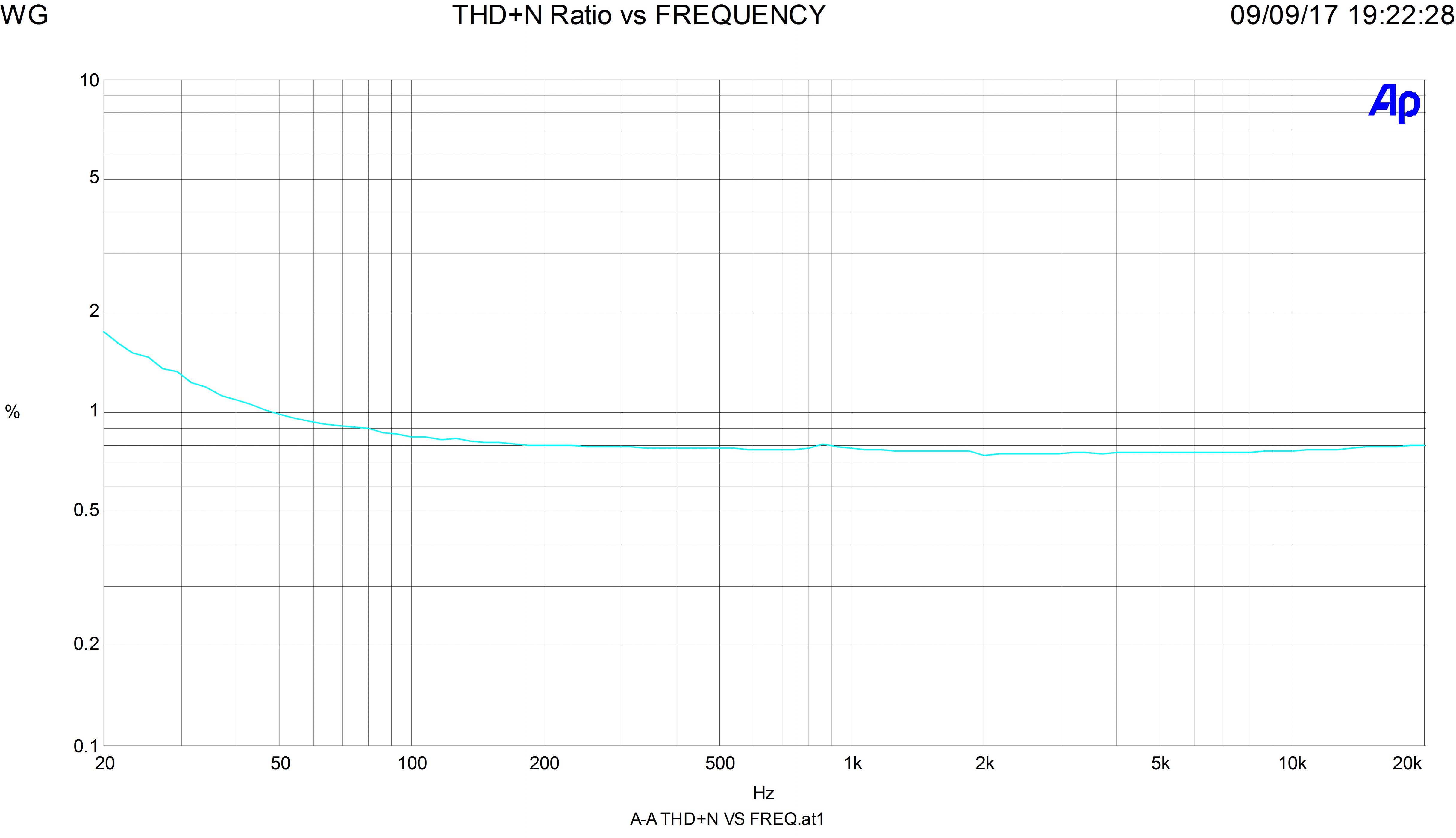

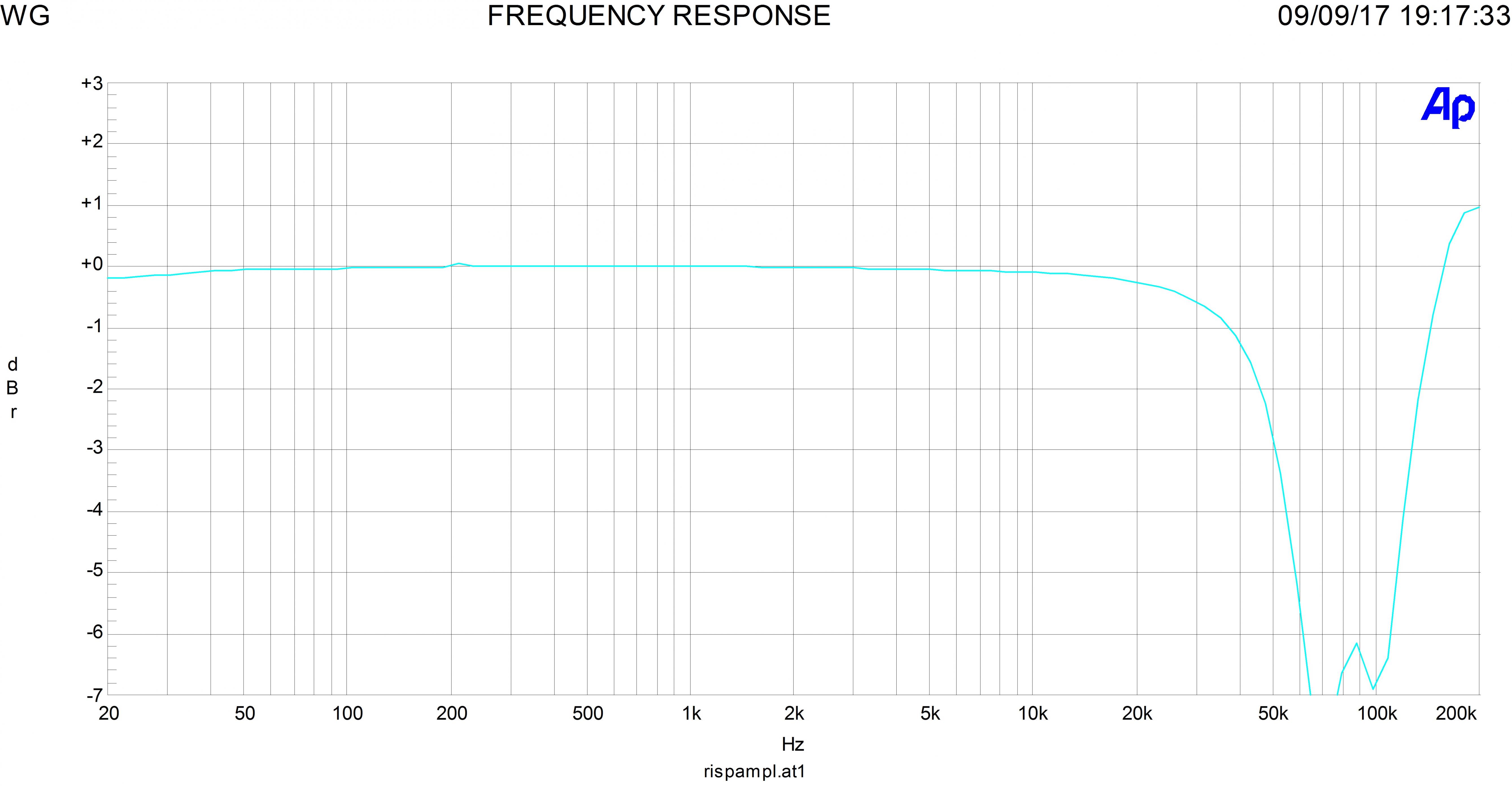

In attach some tests I sent in a E88CC thread.
It is a Hammond 1627SE with a KT150, configured UL.
Fig.15 = freq. answer at 1 w , feedback 6 db
Fig.16 = freq. answer at 10 w , feedback 6 dB
Fig.17 = Thd vs freq at 1 w , feedback 6 dB
The results are good, in my opinion; of course the feedback helpsbut it moderate.
Walter

They look good. Did you try them Triode connected with the KT150? That is actually an intended upcoming project. Now I'm trying to sort out the OPTs for the 300B. Thanks for the charts. Do you feel that they are an indication of what might be expected from a 300B circuit connected Triode and without feedback?

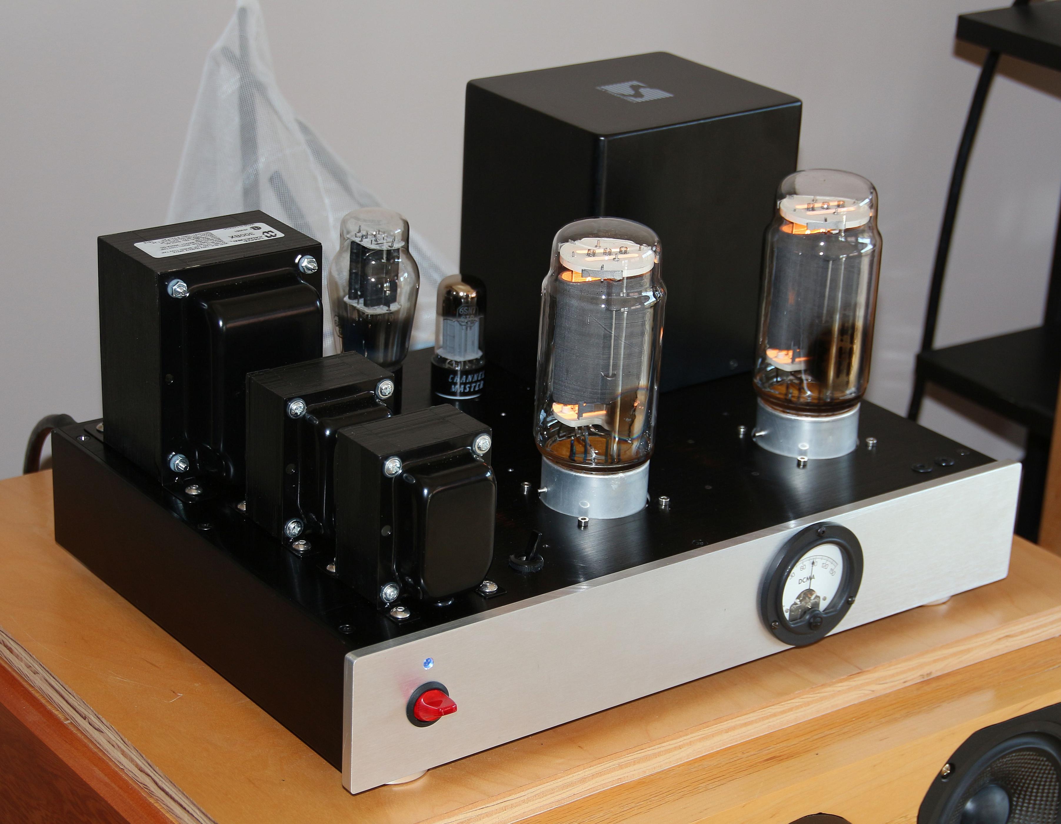

I just finished this bad boy using SAC outputs. He custom wound these at 3K with 4 and 8 ohm taps. Rated to run 200mA to max of 400mA. I should have time for listening test to compare the Hammond to the SAC next week. They were $450.00USD/ea shipping was $150.00 very well packed. ~9.5Kg each. I would seriously check his price for a 300B output transformer.
MelB, the amp looks great! I am also in Canada, and I can get the Hammonds locally with no shipping required for about $360 CAD all in. Even if the SAC 300B transformers were two thirds the price, at $600 USD a pair, with shipping it would be $750 USD. That's around $970 CAD, and doesn't include tariffs or taxes once it gets to me across the border. Realistically, they would cost at least $1100 CAD. The Hammonds are around a third of the cost, based upon the arbitrary estimate of two thirds the price for SAC 300B OPTs. Which is why I would love good news about the Hammonds. I look forward to your comparison.

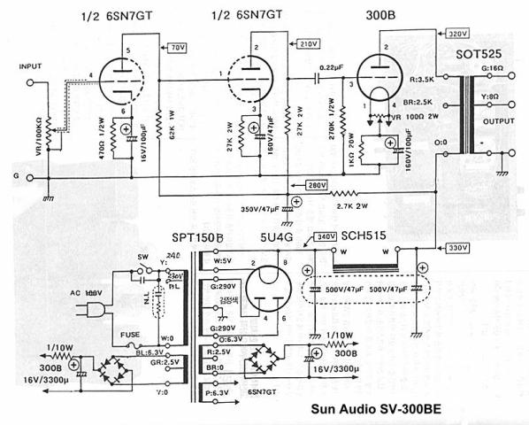

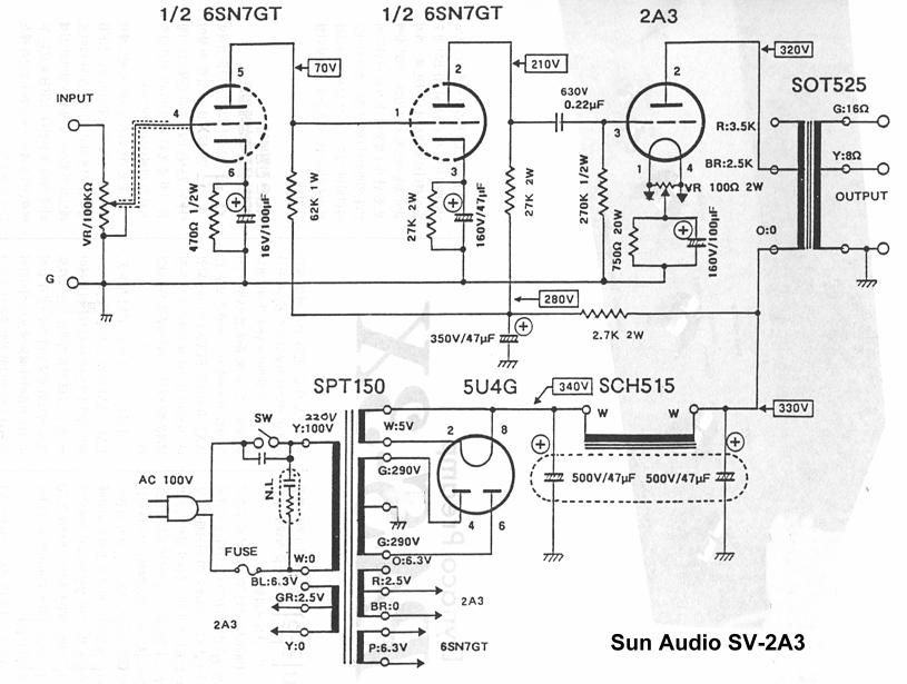

I want to build a 300b SE amplifier with 6SN7 as input and I would like to know what are the OPT transformer parameters and I can get it with Nano crystalline core and as some of the earlier replies over the thread stating about big OPT delivering big sound. I don`t mind building a oversized OPT. Please give me the spec. I want to make use of the provision for both 2A3 and 300b. Please suggest me the transformer parameters.
We need to know the circuit and operating parameters, the transformer must be carefully considered, it isn't really a "one size fits all" type of component...
