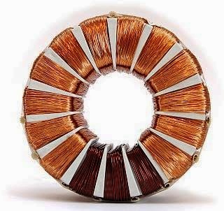

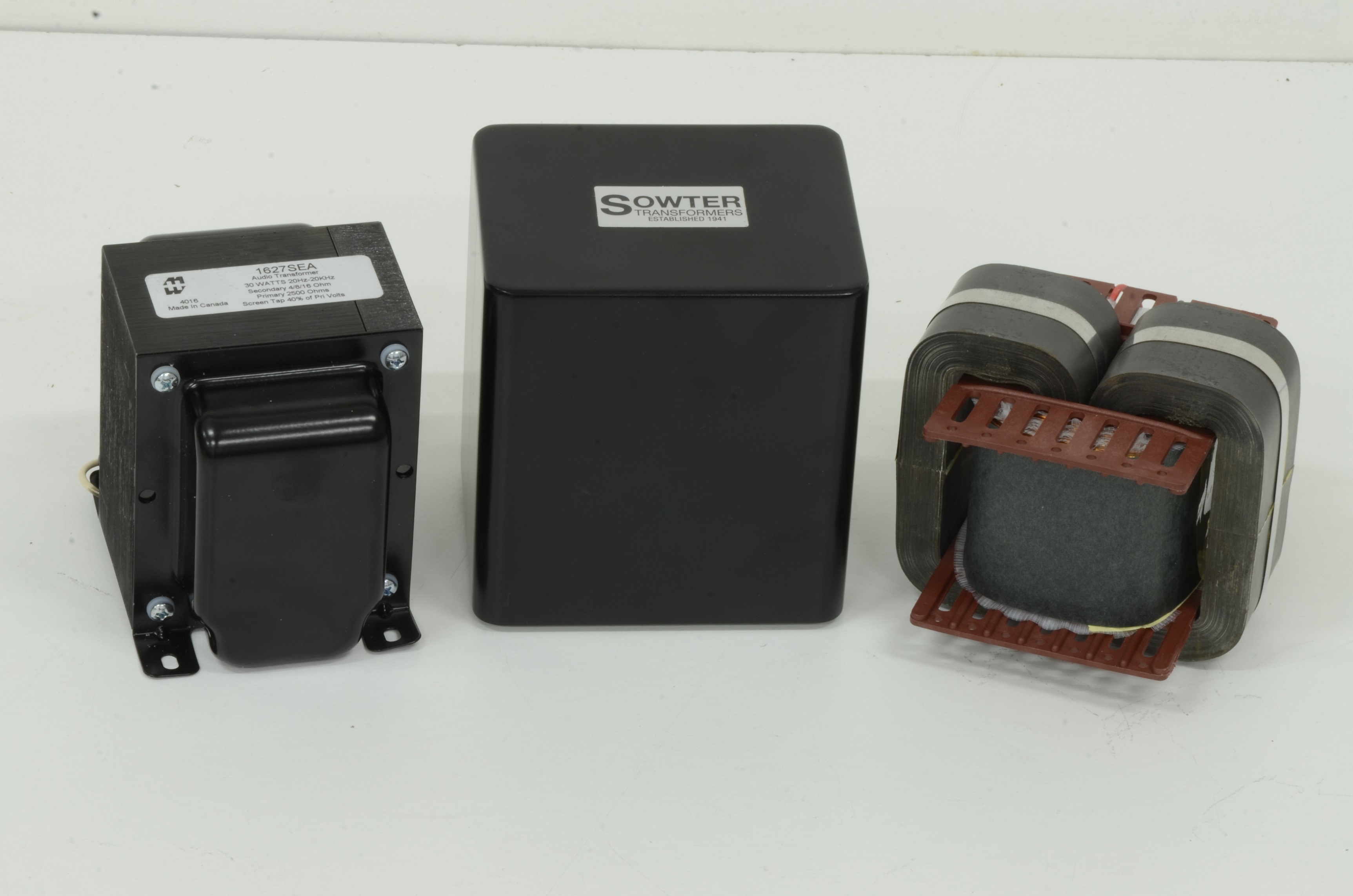

Hi. Has anyone used the new Hammond SEA OPTs? My understanding is that there were changes made from the SE to SEA transformers. I'm considering the 1627SEA or the 1630SEA for a new build but I don't see much comment on them. They are relatively affordable and I can pick them up locally without shipping, exchange and duties required when ordering out of country. No point though if they are no good. Any input would be appreciated.
