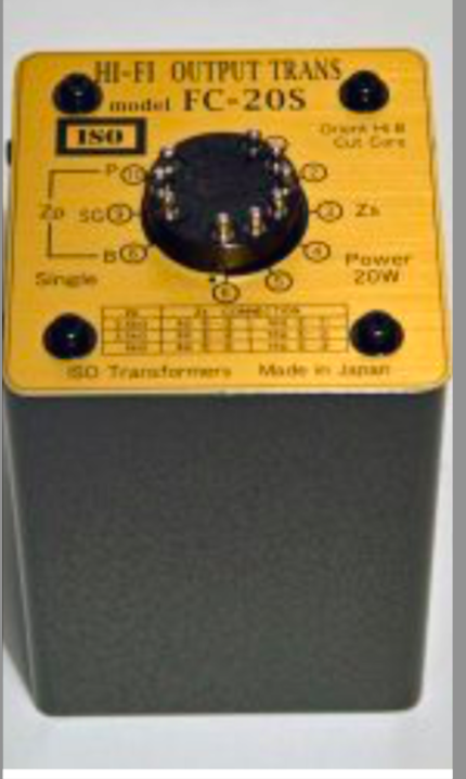

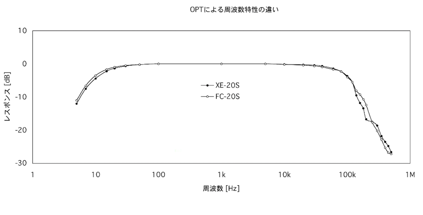

Hi The Best value Transformer for a SE300B is the New ISO- Tango FC20S the upgrade from the Old XE20S
Is the data sheet for that transformer saying it will be 2dB down at 2W/35Hz on the 5K tap?
The inductance specs, though somewhat hard to decipher, would seem to support the notion that these are not great transformers for low frequency reproduction.
The FC-30-10S is going to be worth the extra money.
