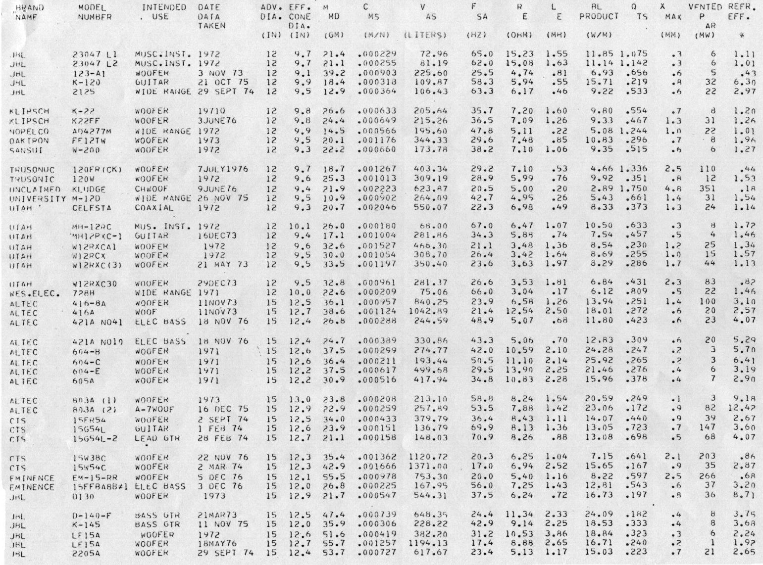

Pro woofers are not compliant enough to use them as bass drivers. I also think that for domestic use they have way too big coils. Perfect driver would be a bit like deltalite, but with underhung motor with small coil and compliant suspension - so in a way a bit like AE LO.
Hi piotr z, I haven't been into TS parameters much and would like to know why and what is the context? Trying to understand it: Compliant means loose suspension and thus lower Fs, is there other benefits?
Big voicecoils are probably for power handling increased excursion and force factor, which are not needed in home use, but they can be utilized to get similar response just use EQ and power?

Compliance works like a high pass filter for bass
https://mynewmicrophone.com/full-li...ons/#Cms:-Mechanical-Compliance-Of-Suspension
Measured in meters per Newton (m/N).
The Cms describes the driver's suspension's compliance (inverse of stiffness), which is made of the spider and surround.
This parameter can be understood as the force exerted by the mechanical suspension of the speaker.
Cms is proportional to Compliance Equivalent Volume (Vas).
Speaking of resonance, the driver's compliance is also linked to the resonant frequency (Fs) of the driver. As Cms goes up, the Fs goes down.
This is because stiffer suspension allows shorter/faster vibrations, while looser suspension allows for longer/slower vibrations.

Hi, thanks! Increased Fs can be lowered again adding moving mass, more wire stronger motor as I understand. Some low extension is traded off for max SPL capability. I think that for bass it mostly is about volume displacement and at home we can get quite low extension with closed boxes so while Fs is important we can get enough lows just by using big enough cone and enough power. If its pure bass application, no high mids involved, where is the difference?
Stiffer suspension and higher mass would need more power for same volume displacement ( output) at some particular frequency than lighter more compliant same size driver. So for bass both could work fine as long as system total Q fits the plan, right? If same driver was to play high mids then I would guess there would be more differences, cone resonances and rising impedance.
I was kind of after what kind of application you thought about where the more compliant is better? In low power big box no problem situation its clearly the way to go I think but is there anything else? I mean all we need from a system is low enough extension in bandwidth with enough SPL capability. Perhaps about any 15" driver was fine for bass duty in home use?
