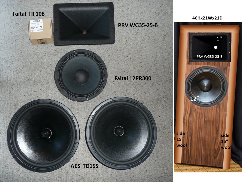

I use the Faital HF108 1" compression driver on a waveguide with a 1200Hz BW3 crossover to a sealed Faital 12PR300 midrange. I use two sealed + DSP equalized AES TD15S woofers for bass. Using old cabinets until spring.
PRV WG35-25-B
10.1"H x 14.2"W x 5.5"D
Sorry, I'm late to this, but I've had PC issues and won't post from a phone screen. Even though I like AE drivers (I own 12 of them in total) I would have told you to go with the Faitals as they are good and will be much cheaper locally. Enjoy.
But they are too delicate and weak to pair with your other transducers
Complete and utter rubbish. I designed, built and ran PA systems for about 25 years and used within ratings, they are fine.
My 8 15s are sealed, EQ'd and sometimes run very hard and have been connected to about 900W/ch/driver for a decade with no issues. They have been used crossed to other HE drivers (eg 2123) and CD/WG and were fine.

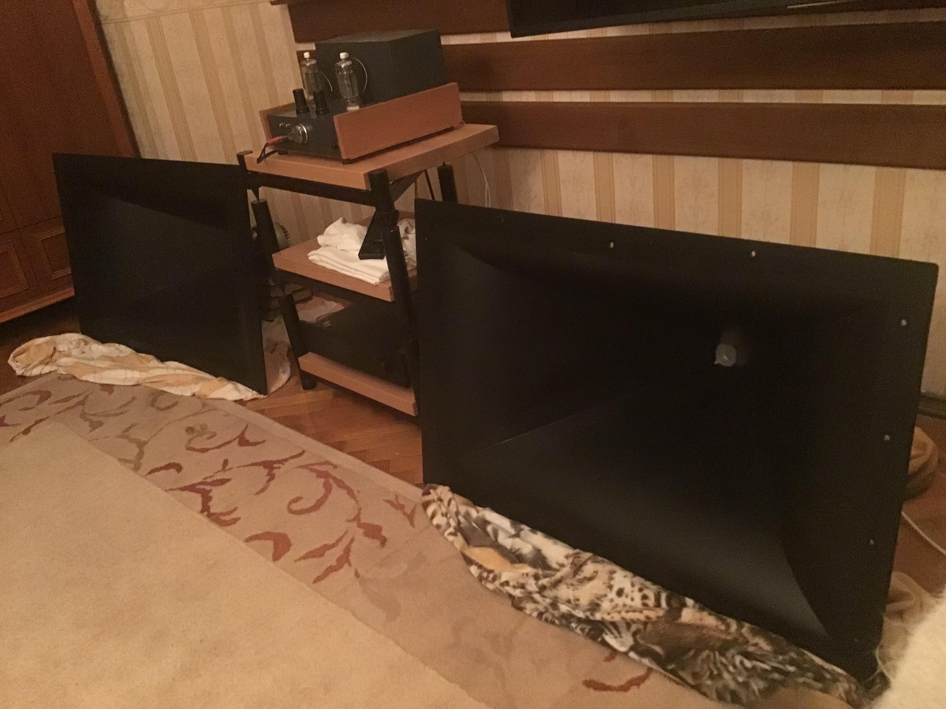

Thanks but i already have k402)
