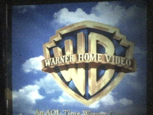

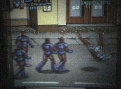

Image detail
Ok I'll make an effort to photograph this weekend.
Any particular film? or Game?
Lord of the rings maybe or MaxPayne 2...
The detail is fine - I can see no issues, except if I sit too close in which case I think my eyes can't keep up!

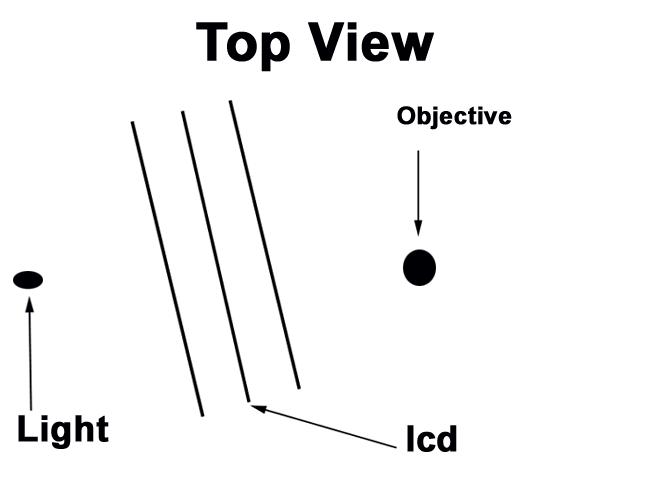

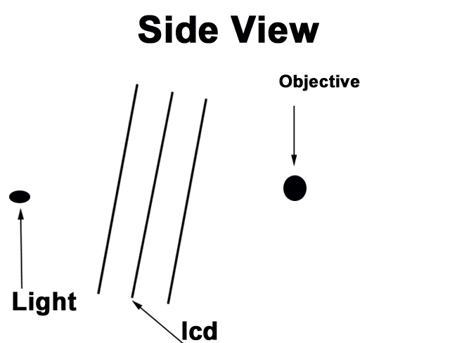

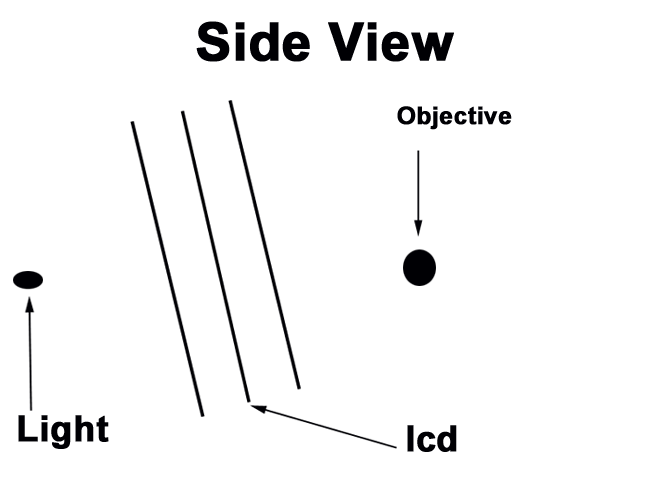

Which of these is the correct answer to the optimum tilting angle of the beng557s or 567s?
