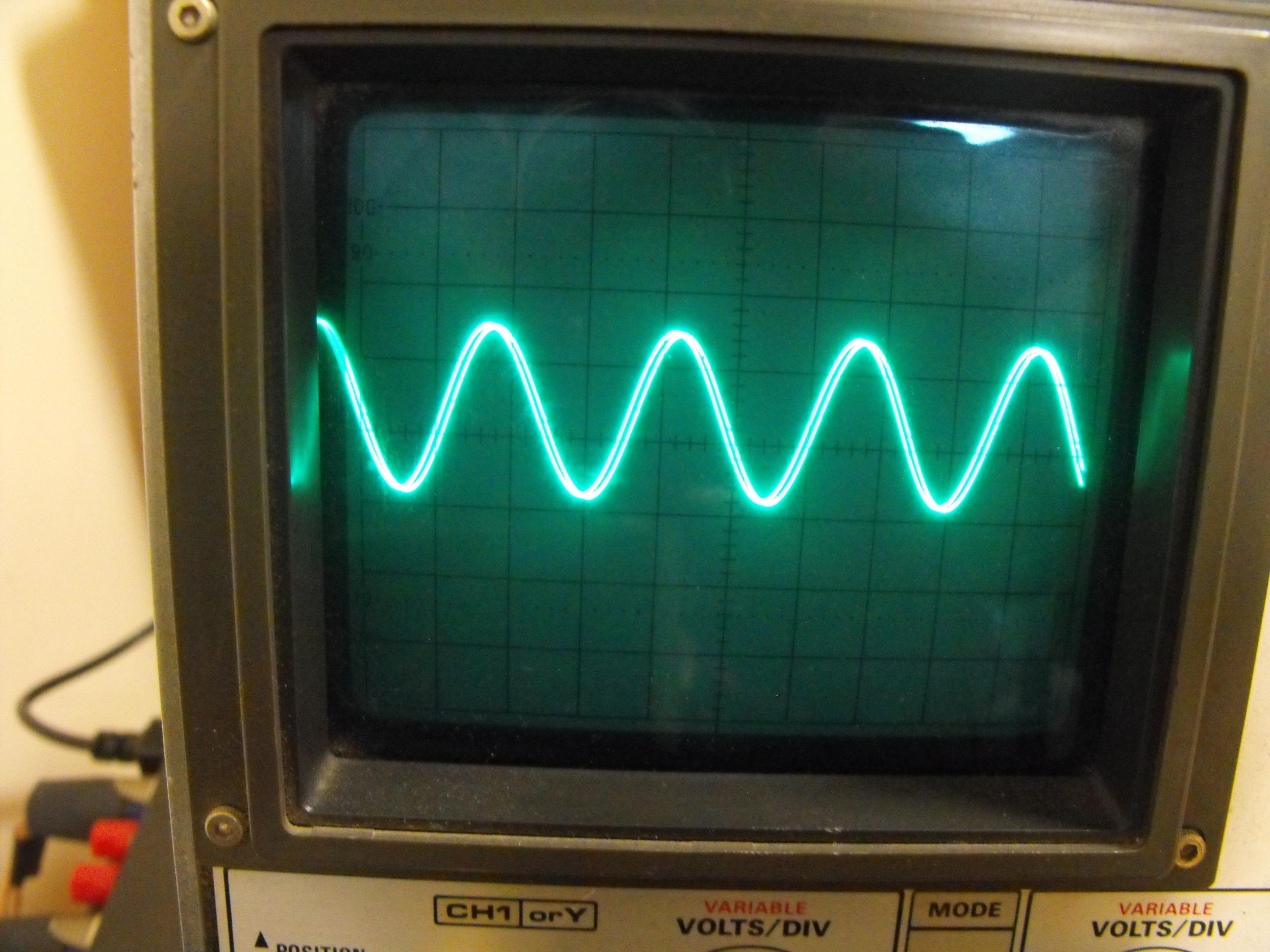

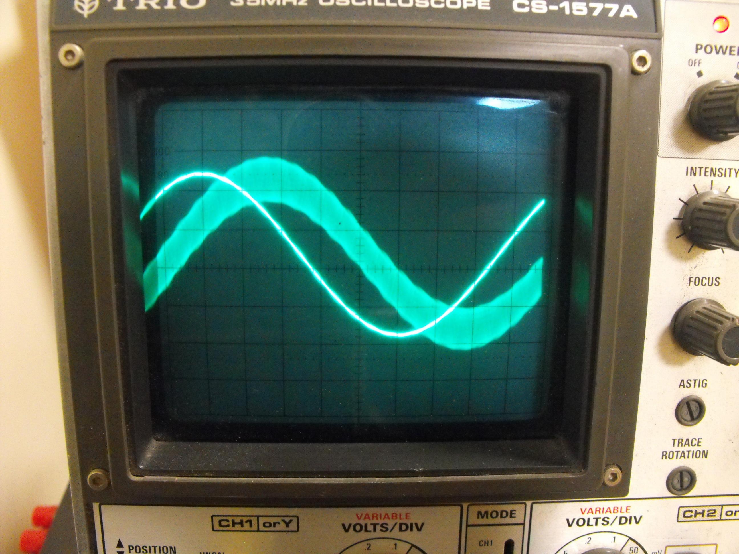

I recently compared the NU3000 with a similar power class AB and found the treble region a bit strange. The stereo image was not as precise and image width not as wide. I then looked at the outputs at 20 kHz, just below the NU3000 filter cut-off frequency. With the class AB amp input and output level matched to be identical, the attached photo show input and output overlaid. The NU3000 showed significant phase shift between input and output at 20 kHz and a high noise floor. The filter only gets rid of the switching noise components just above the audio band. The noise rises again from around 50 kHz. I would speculate that IMD may be the reason for the audible effect.
I agree these amps are probably best suited to sub-woofer duty.
