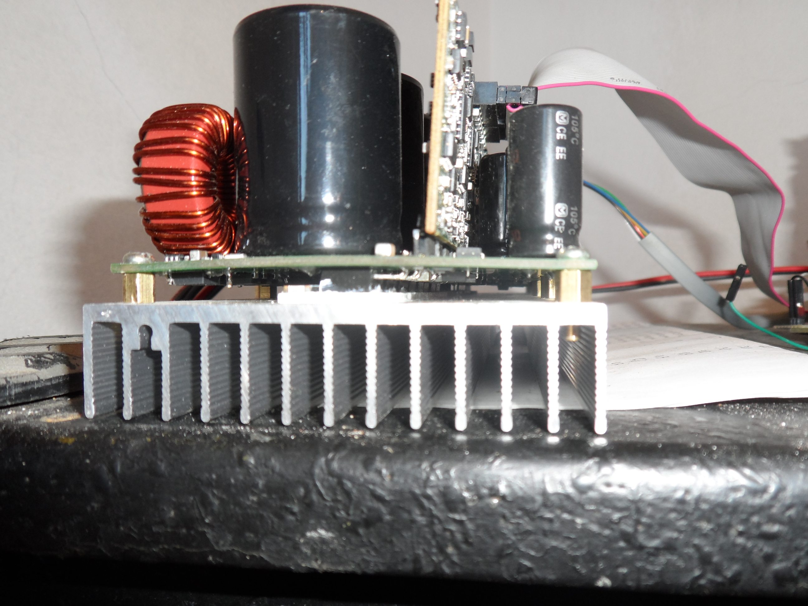

The thermal cycles are not equal to the frequency nor the times it is switched on and off. The thermal cycle in semiconductors is counted from a temperature of ambient temperature (or even the lowest operational temperature spec, which is -10, -20 or even -40°C) to the highest operational temperature, which is around ~150°C. As long as the amplifier got a working cooling system of any kind and no (artificial) heat spots, there are no thermal cycles. These cycles are usually only reached in extreme lab enviroments while testing cycles. So no, that are not 'time bombs'.
Some right and some wrong information here.
The IRFS4227 datasheet states that thermal resistance junction to case increases from .45 C/W to .65 C/W after 1000 thermal cycles. This is called at "end of life" because themal resistance stabilizes at the latter value until "end of life" of device, not because the device ceases to operate. These values are lower compared to thermal resistance from the device to the air, about a few C/W in this application, so a 10:1 ratio, negligible loss of thermal performance.
On the other hand the idle dissipation in these transistors is low, and they are fan cooled permanently. This results in the transistor dies being close to ambient temperature at idle power and being close to maximum temperature at full power at low impedance load and/or bass duty. There is very little thermal mass. So there are *full* thermal cycles, following music program intensity, taking place in these amplifiers at low load impedances and/or bass duty. Not at 8 ohms full range, of course. A "thermal-cycling life test fixture" could be the optimum sarcasm.
It's well known that wide thermal cycles reduce the life of SMD boards, causing intermittent solder joints requiring rework or in some cases replacement when many parts blow due to an open connection. Fortunately the output stage uses IRS20957 control circuit with built-in short-circuit protection, this will limit the degree of damage in case one FET becomes shorted due to open gate. This protection is not even found in many class D subwoofer power modules from Harman group discussed in some threads here, so the INUKEs are better than that.
In fewer words: There will be intermittent solder joint problems in these amplifiers when operated at lower impedances and/or low frequency duty, repairable in many cases.
The power supply has a similar pair of anti-feature and feature, the gates of the IGBTs are transformer-driven to act as a firewall, because such IGBTs can fail exploding and leaving a hole in PCB if one gate becomes open. Another solution in SMPS is to use power zeners and fusible resistors to contain damage in the unfortunate but common case the gate of a power transistor becomes shorted to the drain, done in the best circuits, often underlooked, just repaired by swapping the transistor and blown gate resistor.
The PCB approach used in more reliable equipment is to have separate SMD boards, of materials and thicknesses optimized for long life of SMD, containing all small signal circuits, and the use a main board of materials optimized for rigidness and power handling, with thru-hole power devices mounted to a heatsink.
Also, the cooling approach used in more reliable equipment is to allow the heatsinks to heat to relatively hot before starting proportionally driven fans, this reduces amplitude of thermal cycles, as the heatsink is allowed to keep hot from one high power passage to the next.
The attached picture shows a *reliable* prototype capable of 2x1000W/8r (BTL) short term (for a few milliseconds, as other products are sometimes rated), >1800W for a few seconds @ 230V, and >600W for indefinitely long period with 50mm fan, 3:1 crest factor. *Reliable* in the sense that it does not exhibit substantially faster aging when operated at maximum ratings, and self-diagnostic too, it gives different fault codes when operated outside ratings, to help locate the problem, even from remote location.
And this other picture shows INUKE:

Your prototype mounting technique:
How is < 600W of power dissipated using x6 TO-220 packages mounted on the PCB underside, fixed using the PCB as a mount, surely this isn't safe ?
Lets assume 85% efficiency at 2000W. This is 300W loss, about 21W * 14 power devices. Thermal grease starts to be effective (low thermal resistance) at low contact pressure, as long as it does not drain/void, contact surfaces are flat, and part to part TO-220 height tolerance is satisfactory. The PCB shown is 2oz 4 layer, so it actually provides some pressure. Also there are 6 screws on each side.
There are also those compressible thermal pads of different thickness, compressibility and thermal conductance, mostly used in computers, but don't think they are better than alumina pads and thermal paste in terms of thermal resistance.
Thanks for the insight. It does appear in your picture that the FR4 board is slightly stressed(curved) and may be fatigued, but then again this is a prototype. What you say is true, a computer CPU shows obvious effects when thermal compound dries, I remember my Intel 3.0GHz CPU alert utility all of a sudden started reaching its default thermal threshold.
The board is intended to be bent, SMD is properly oriented and pads have thermals. Only SMD parts close to inflection points at the center are decoupling caps (1206/1210), snubbers (1206), diodes (SMA/SMB), and sensing NTCs (0603). Bend is across ~75mm length. Have you tried bending a 2oz 4 layer PCB like that? Requires >1 kilogram per pair of TO-220 devices. Material is good fiberglass, 2 copper planes at both sides and 2 in the middle. And you are right that it is a prototype, I'm evaluating it: loosening the screws after a year of operation results in PCB becoming nearly straight again.
