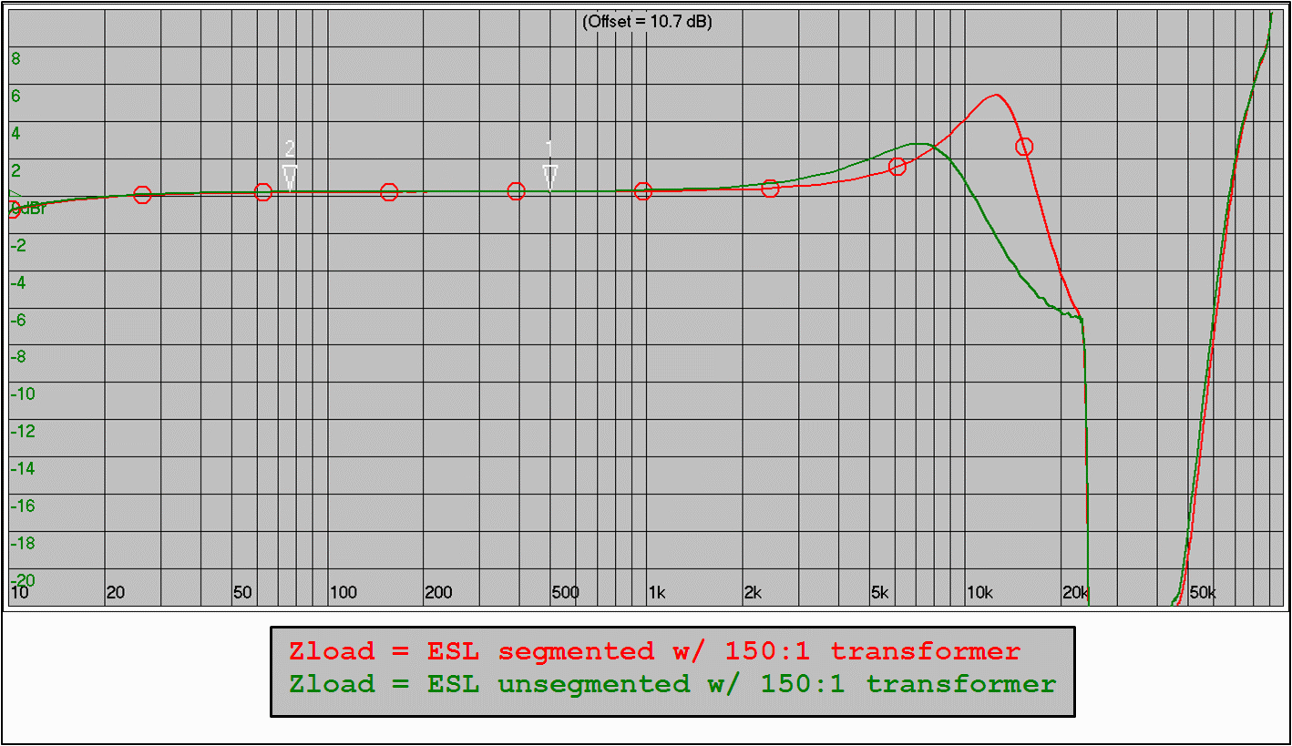

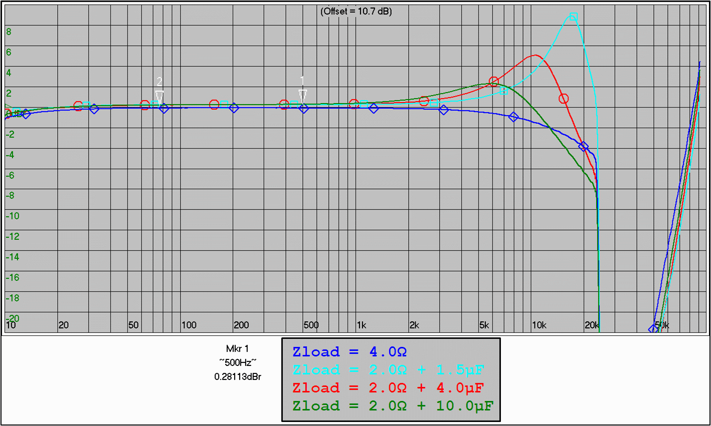

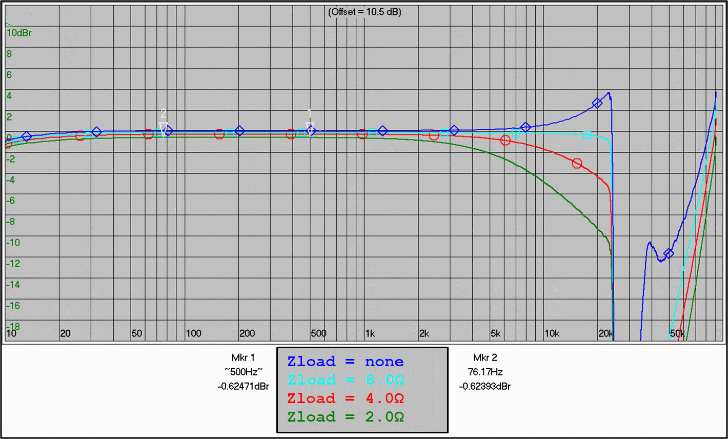

I have always considered the 6000 and 6000DSP to be lesser performance than the 3000 and 3000DSP because they are not rated for 2 ohm operation, whereas all other iNuke are 2 ohm rated. My guess is that the 6000 are designed by bridging two versions of the 3000 circuit for each channel. I own iNuke 3000, 6000-4 and 12000, and for the price, I have no complaints about performance compared to my other (many times the price) amps, except excessive fan noise, which is easily cured by a fan swap.

Saving the planet aside, no one likes amplifiers that burn up. Especially people who like to build amplifiers.
The problem with the “design” is that it is bog-standard but has insufficient thermal margin for heavy duty use. In typical light duty use where there is only 10 watts of heat load it runs just fine. At full power it may dissipate 200 to 300 watts and it just can’t do that very long or very often. Two ways it could be corrected. Get those switching times down under 10 ns so the heat load would be down to a few tens of watts at full output, or put in an extra output pair or two, proper drivers, and some real heat sinks so it can take the heat load without issues. The problem? Neither is cheap. The first requires lots of NRE, and unfortunately, more expensive parts and construction technique. The second would be relatively easy, but were still talking $50 worth of parts. Adding $50 to the BOM cost adds $500 to the retail price. And it will still sound like a .... Behringer.
