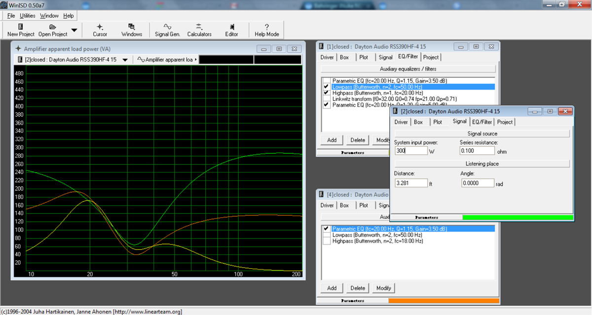

Also, here is a screenshot of the amp load for three different eq versions of the my driver in my box. The green is no eq and 300W input, 3.5db boost at 20Hz and 140W, and 5db boost at 20Hz plus high pass at 20Hz and lowpass at 50Hz with 200W.
Does the low load centered around 33Hz because of the driver/enclosure Fs have anything to do with the power the inuke is putting out?

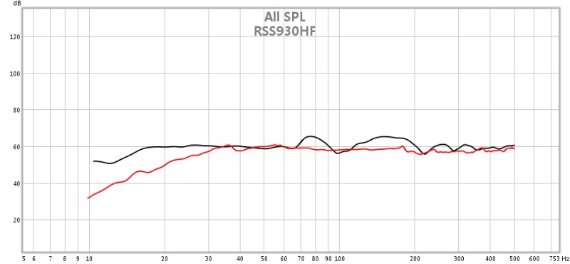

It sounds amazing and after using REW to equalize the response, it's very smooth and deep. I made a couple of cuts to get it flat. Also, the dynamic eq is a really cool feature. I was able to get flat in room down to 15Hz and still hopefully provide the driver with protection at high levels. I dialed in an +8db LS12 where the dynamic feature starts knocking it back at about -20db spl. At high level with music, the cone is barely moving. I'll keep an eye on it at first with movies.
Here's an in room eq'd response of the 390HF and my mains (nomex164) overlaying a close mic measurement of the 390HF without any eq. It's not adjusted for SPL.
