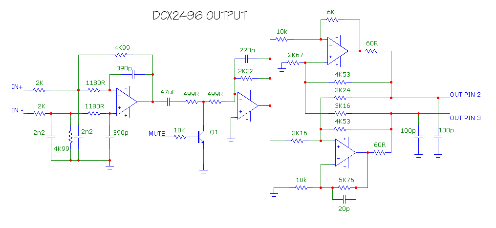

Ben, yes. The DCX can be put into a mode where all 6 channels are independent. Or some parts of them can be linked, if you like. The distortion of the DACs is very low, they are of good quality. However, the analog output is not great. OK below ~1Khz, but HD and IMD rise rapidly above that. The output is also at "pro" level, much hotter than you need for home gear.
First mod is to replace the analog output section. Second mod is to beef up the power supply, at least the analog part. If you use the analog inputs, then replacing that section is well advised.

Replace with what , I plan on playing with one on the bass/subs units ...
Then you can probably leave the analog outputs alone, as long as you have proper attenuation. Cleaning up the power supply would help.
OUTPUT CIRCUIT
The DCX output looks like this (see attached).
You should be able to pick up the signal after the 1st opamp (watch out for DC) but I've never tried it.
All you really need is something to block DC out of the DAC chip, a way to go from differential to signal ended, and maybe a little low pass. Passive is OK. I use transformers for this, as they do all of that quite well.
