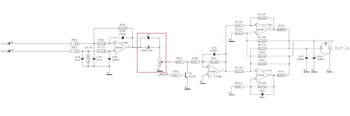

here's what I am going to try
The attenuators will work ,maybe you can insert one as in the schematic and try it!
Thanks folks. I ordered a couple of the 10k units from the seller Gigawork on ebay. Cheers for the schematic noSmoking - I was just going to make a standalone attenuator with RCA in and out. Maybe your solution is a better one?
well maybe,,,
IF you want a volume control and you want to stay balanced the schematic could work,IF you want a single out it will still work ,if you float the rca connector,in other words don't ground it to the case ,I use 3 nylon washers and a big hole in the chassis,2 big washers on the outsides and a small one on the inside ,like a sandwich,lol,but no chassis connection,to the rca connector.
I haven't tried that circuit out yet, but maybe soon ,let me know how it does,
I did listen to a friends rig and it worked fine,He also used caps to single end his output,sounded good,It was a 4 channel per side setup,with 2 dcx2496's.feed by 1 deq2496.

Cheers 🙂 I think I'll just try the pots in a small case inline with the rca leads to the amps for now. I've just got some attenuating resistors in the XLR connectors and have(i think - it was a while ago!) shorted - to gnd.

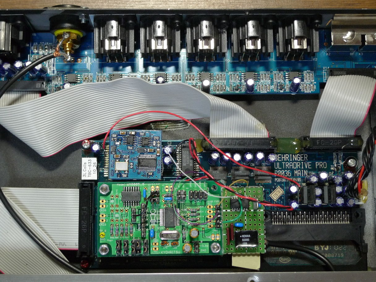

Hello, this is my first post to diyAudio.
Inspired by the linuxworks mod in last December, I put a WM8805 digital output board in my DCX2496.
Actually I bought a WM8805 DAI board from the following, and configured with the pins.
????Blog😀AI?????????????WM8805_G??????
(sorry they only have Japanese page.)
A level shifter, 3.3V AVR and a transformer were put on the small additional board glued with the board.
http://www001.upp.so-net.ne.jp/home-dir/pic/dcx2496/01.JPG
http://www001.upp.so-net.ne.jp/home-dir/pic/dcx2496/02.JPG
Since R3 (100ohm to DAC SDATA) decreased signal amplitude and WM8805 didn't work, I removed it. The above picture was taken before the removal.
Sound quality improved very much!
Next mod is to put a SRC&Clock from Pilgham Audio. I'm looking forward to playing with it.
Hello,
I installed the SRC/Clock from Pilgham Audio to my DCX2496.
The result was fine! After the mod, the sound changed smooth and clear. The improvement was much more than I expected.
Then the next mod is to build a board for multi channel S/PDIF output. But before that, I need to learn EAGLE (PCB software) so it may take several months or longer.

Well I have been putting of doing a volume control mod,Should have did this long ago ,so much ezier to set up the balance on the 8 different channels on 2 dcx's,I did basicly whats been posted I used a 10K pot and I jumped the mute and used the pins on the op amps pins1 and 6,I put a 1K resistor inline and a .001 cap across a 47 uf cap,I used some better 47uf caps ,I think the ones I removed were as old as the unit and cheep,LOL. I think some oc-cons for the digital section and maybe some new power supply caps,

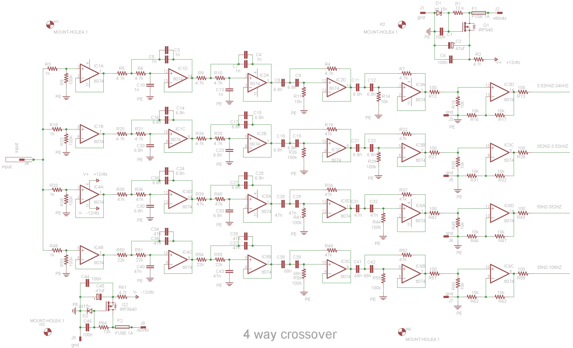

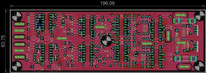

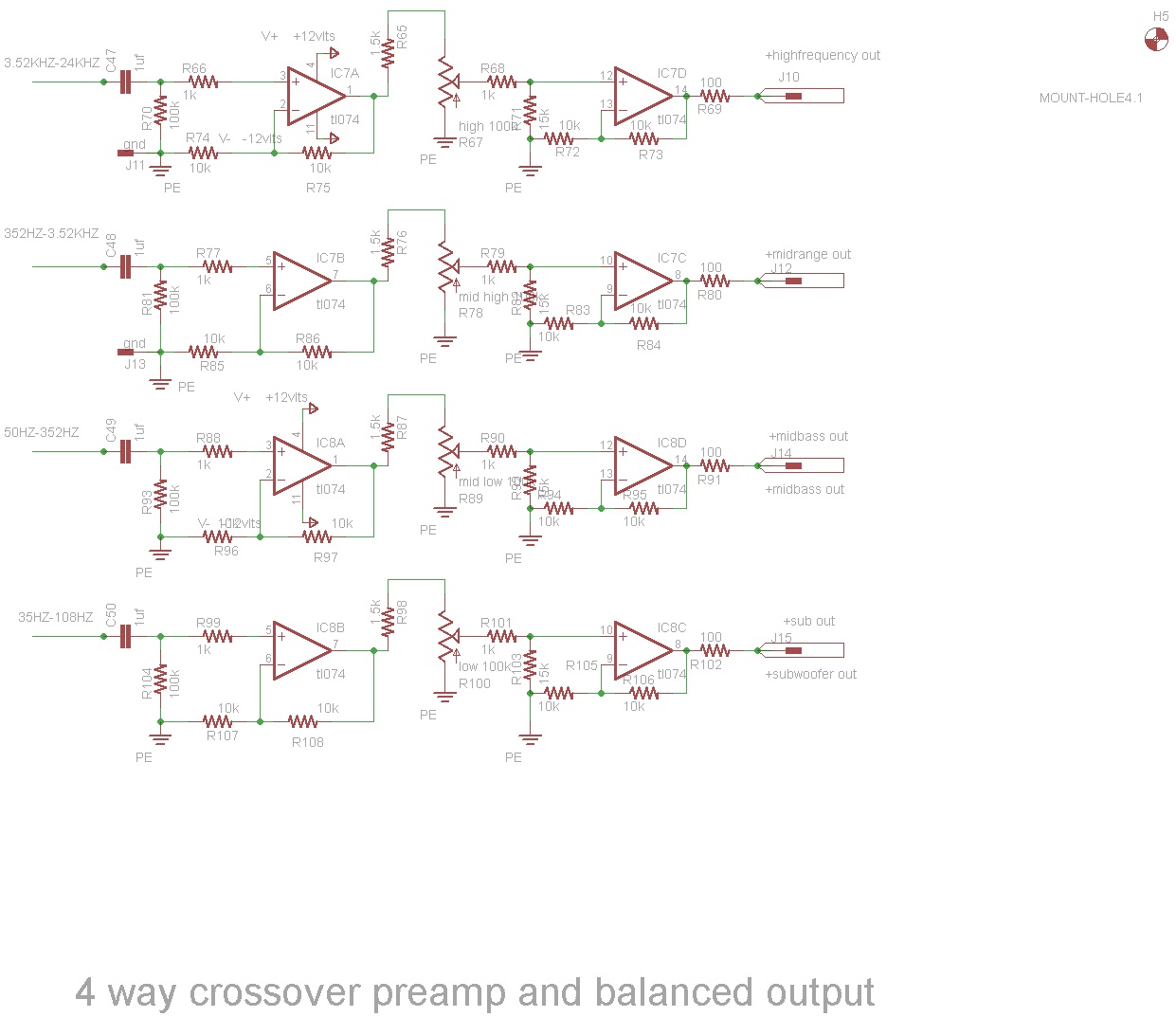

hi all . abit off topic i am new in this forum been invited by no smoking . here is my 4 way analogue active cross over . i have tested it, it works and it is impressive.
i have used linkwitz 24db way all 4 channels have high pass and low pass filters the frequency division is in the schematic pls share your comments and experiences .
have fun
have fun
have fun
Hi Stewin,
Looks good , Could you post the silk or a stuffing guide?
Power supply is + - 12volts,what transformer did you use?
I will start them soon ! Thanks for posting!🙂
