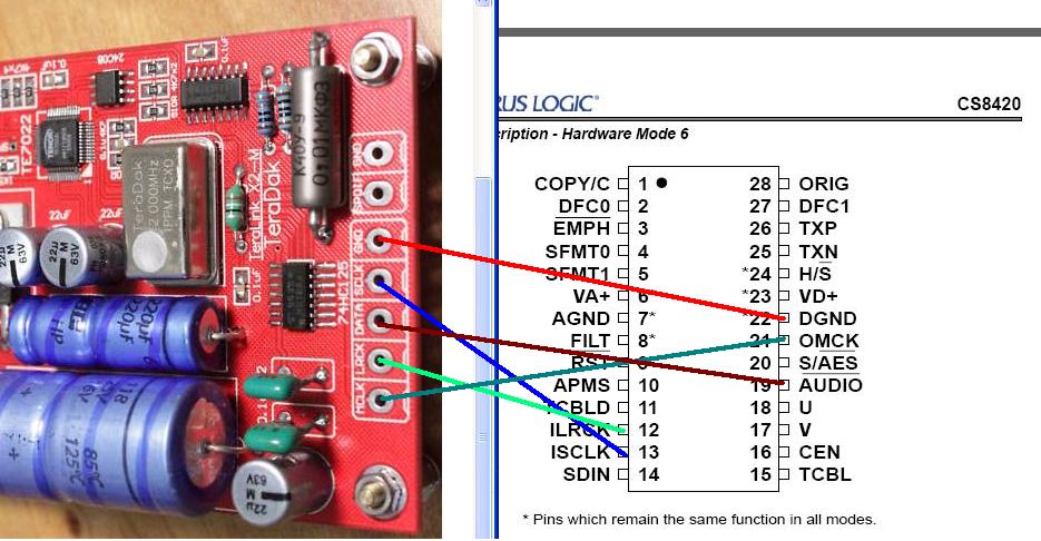

My dcx has started to do the digital input cs8420 notch filter bug every time I use it lately. The ribbon cable doesn't seem to be the cause, even though that was faulty and causing dropouts before i reseated it. As far as I can tell there isn't an easy fix for this bug, is there? It's about to go out the window and be replaced with a minidsp.

well 2 ways,1 get a dac board off ebay and patch it in or 2 replace the chip,
I stood the board vertical and brushed the legs(pins) with a small torch ,the chip will fall off when it gets legs hot enough ,or cut the legs and pull them off one at a time ,A used motherboard is a good practice before the real deal,
works as it should now ,might also replace the caps around that area with oscons,Good luck!

Cheers NS. I have an old Ebay DAC here that uses a CS8416. What's involved in patching that in to the dcx? Thanks heaps for the help 🙂

I replaced the chip,but here's what I have for the add on CS board,
I did some serches and also yahoo groups got alot of info,Look up Linuxworks on this site.
here's a pic to wire it!

Thanks NS. I think smd work is probably beyond me right now as I don't have my gear set up. So, first I will try a new usb-spdif board and if that doesn't fix the issue I will have to go down the minidsp route. The usb spdif board I currently have is causing all sorts of interference so there is a chance it is faulty or poorly built. It completely wipes out some tv stations.
