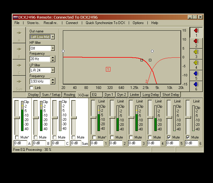

Thanks for replies to my earlier post (#3532). But I'm still wondering how many EQs I can put into each of the 6 bandpassed outputs?
(I can live with maybe one or two frequency curve tweaks for each of my six speakers, but more would be nice.)

There is a limit specified in the dcx2496 for how much total EQ can be applied.
If all 6 channels have different EQ, then I suspect that "limit" on processing power will come in quite early.
Some who have experimented with multiple EQs should be able to give guidance on how the processing limit affects DCX2496 performance.

9 EQs for each input (3) and for each output (6).
Just download the "Editor Software" (Remote Software v1.16a) from the Behringer Site - Here under the "Downloads" tab. You can then see and control all the features. There in no need for a DCX unit to be attached to use the software. You will find it to be very capable.

There is a limit to processing capacity that can be reached as AndrewT indicates, but it is pretty generous. Using the Remote Software you can test the limits as the remaining processing percentage is reported as the settings are adjusted.

It all depends on the number and types of EQs. Put in a lot of them, and/or high Q/steep slopes and you will see the available processing power drop fast. But as long as the percentage is above zero you can continue to put EQs in.
At any rate, all these questions also on config are well explained in the manual, it's worth to download it and read it, much easier than picking up (unrelated) bits and pieces from here (no offense to those who provide the answers - it just makes more sense to read it in context).

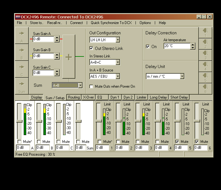

I have a question however about the existing headroom for the treble outputs. As you can see, when I maximize 24bit into Ultra Drive so it is a lot of headroom left. Should I touch this setting to get more bitrate or how do you do? (image_2.jpg)

Once you divide the spectrum up into 2 or 3 parts, each of those parts will be lower than the level of the whole signal, at least on music and pink noise. What do we do about that?
I've been boosting the outputs by 6dB to get a little more level out of the DAC chip. For music this has been OK with no clipping, but for test signals like sine sweeps, you have to be careful.

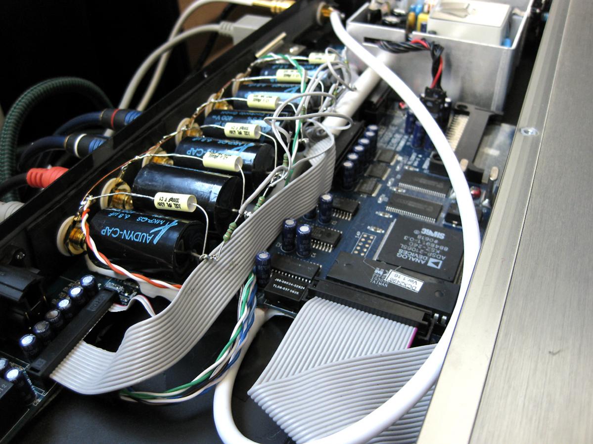

Viper_user - could you talk about your digital input modification? I am going to do this soon to stop the digital input bug that plagues this unit. Is yours stable? Have you changed anything aside from running coax into the transformer? Thanks!
Pano >> Thanks!

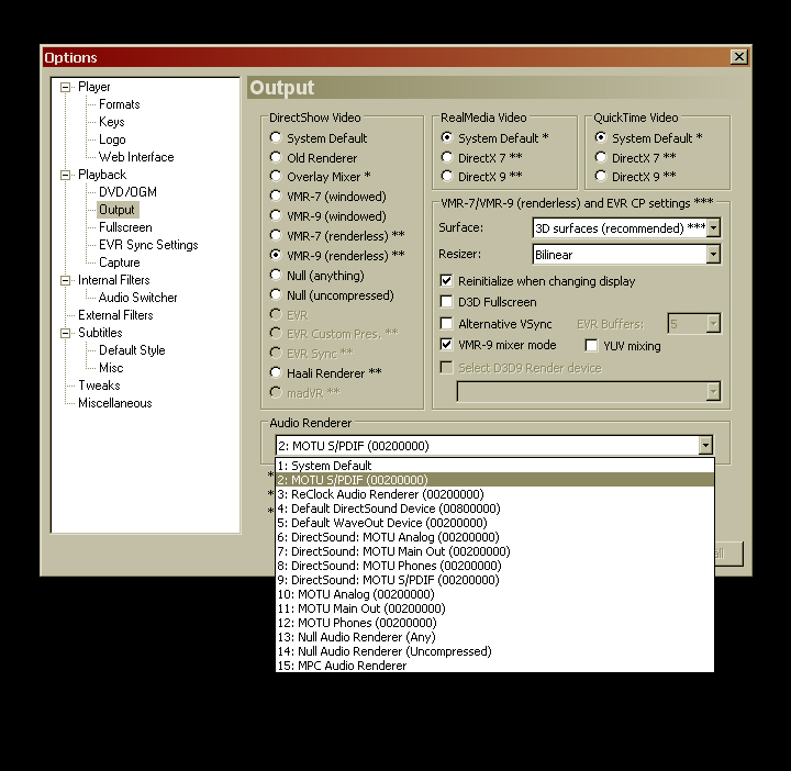

That is a good question. I have had some problems with drop outs. Lately though, I lost them by direct hook my player in windows to the soundcards spdif(24bit). Don't know if it is the new soundcard driver or the "direct connection"? (Image of Media Player Classic Home Cinema)
Maybe you could temporary swap to an adjustable resistor at the spdif-bridge and see if you can find a good value. I swapped mine with a 75 <--> 110.. Not fully sure on that one.
