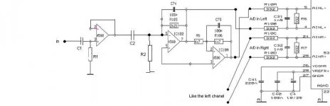

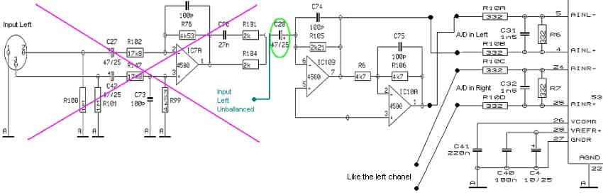

I bought a dcx last week, and I want to do some tweaks. I would like to use the analog inputs, but not in a professional balanced mode, just at home, unbalanced. In the analog input stage a don't like the 47uF trash capacitors, and I want to try remove some opamps.
My question is: What is the most simplier analog input stage in the dcx?
I think the last stage before the A/D converter is needed, bedause the A/D input is balanced...
This is my first plan:
In the green circle I removed the elko, and I replaced an MKT or MKP foil cap.
But it hasn't correct impedances.

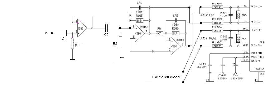

And the second plan:
Or do you have a better idea?
Please help me!
Thank you!
