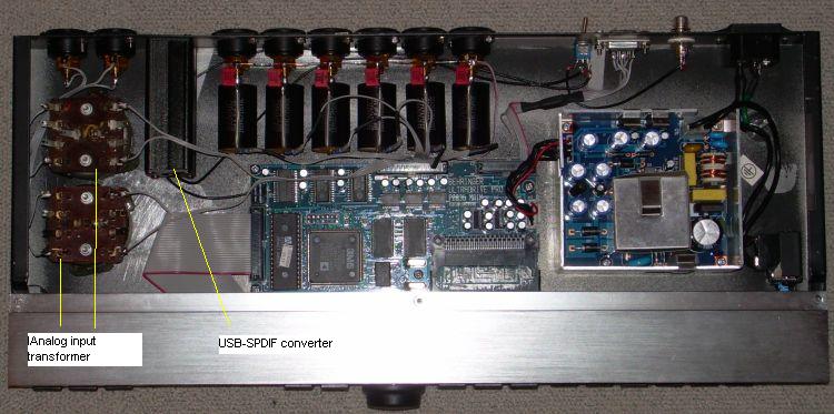

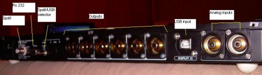

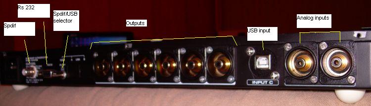

I finished my DCX. Analog A,B inputs with two unbalanced to balanced transformers connected to A/D converter without any opamp. I made two digital inputs on DCX: one is an SPDIF input, and the other is an USB input with a simple USB-spdif converter.I can select betweenthe two digital inputs with a simple mechanical switch. The output is a passive unbalanced version with Bennic coupler. All analog inputs and outputs have Neutrik RCA.
Very Nice! Did you have to enlarge the holes to get the RCA connectors in there? The Neutrik version I bought are too big.
