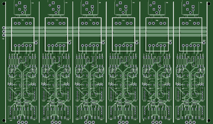

Here is something to add to the list...😀😀😀
I am sending it for the fabrication, wanted to do it a long time ago...
Board for six channels of Lundahl transformers plus balanced jFet buffer, plus cap multiplayers on power supply for jFets.
Complete DCX output replacement!

In that case maybe the better choice for modification is SRC2496, which already has switching between sources and sends out S/PDIF? Of corse, under condition to sends out the same signal receives and do upsampling on your boards. I am using it as a switcher between several digital sources, and it has analog input. Plenty of space inside the case as well.
Hi Vladimir, thank you that at least you are interested in my Mod-list. I already mentioned your Lundhal transformer solution for analog output. If you have some more information about it I can add it to the Mod-list.

@AR2
That's a nice looking output board you got there. Can you give us some more details?
