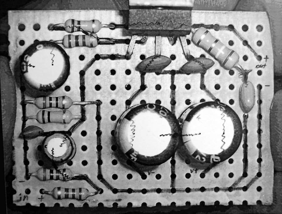

The original design for the amplifier itself, was much smaller. It was only expanded for easier soldering and easier documentation.
Smaller original. . .
Here's a photo of the original so that you can see its tiny layout.
At some point after it won a local contest, then I notice that the order of the two resistors (lower left), is mixed up.
The 1M was supposed to have made a load upon the cable (but it didn't do that in this smaller original in the photograph below). However, it (the 1M resistor) may either be omitted or simply added to the input cable's connection point (from input + to input-).
The photo also shows a capacitor at position CIN (the big one at the upper left); however, that's unnecessary unless DC offset is high. Since the new design (at this post) has very low DC offset, then you "probably" don't need cap CIN within the NFB.
And, the photo shows a zobel at the speaker output. A more "compact" location for the speaker zobel (that resistor and capacitor at the far right side) would be "at" the speaker output terminals of the enclosure, or it may be omitted.
So, with a few small changes, the amplifier board itself can be made as small as a human thumb.

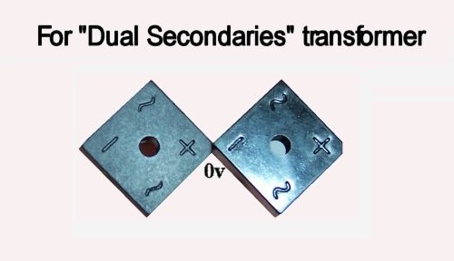

Yes, that transformer is workable and the 18+18 vac 160va version will work just as well. Here is a clue for the means to connect it.
This unit replaces the single rectifier seen elsewhere in this thread.
This is a photo of a dual rectifier, suitable for connecting a dual secondaries transformer. Each secondary winding "powers up" one bridge rectifier. See photo. It is a pair of 10a rated, clearly marked, bridge rectifiers. Imagine flashlight batteries that are within a two-cell flashlight when you look at this photo.
