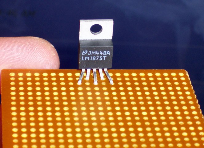

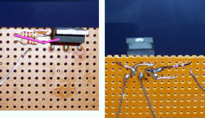

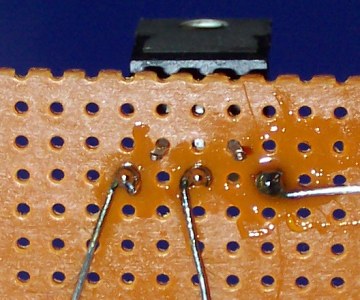

Here's a photo showing LM1875 with the pins slightly spread and fit into veroboard (plain phenolic), for easy soldering.

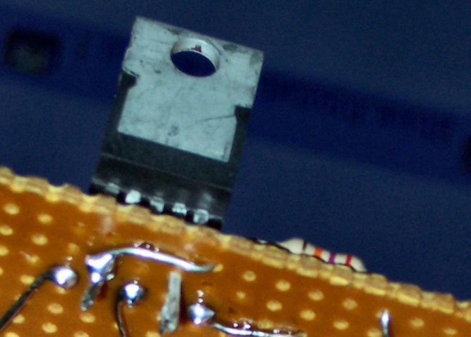

This photo shows the pin spacing. Its a view from the bottom side of the board. Note that this is plain phenolic board, without any copper on it.
There's at least 1/8" of pin sticking through the board. And there's plenty of room to get a hook or loop of copper wire around any of the pins, without worries about any connections too close to any other.
See photo.

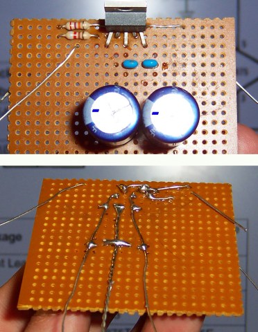

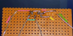

Next step, we get some nice 24ga or 22ga copper wire (or copper core wire) and do like this picture.
These 3 wires are about an inch longer than the edge of the board. Each has a small hook so it can make solid contact with the LM1875's pins.
These little hooks are dipped into the flux jar before soldering. That makes for instant success with the soldering.
Make the end of your soldering iron, bright, silver, clean, by wiping it with either a wet sponge or #0000 steel wool. That helps to make the connections nice and clean.

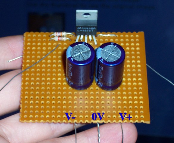

Its time to hook up the main ground lead.
This is thicker than any other wire.
The first of the power caps help hold the ground lead in place.
They're 100nF, which is 0.1uF, and they probably have the number "104" written on them.
You can use the plain 3 cent ceramic caps or something that looks prettier. See photo.
To hook up caps on veroboard, just hold your wire firmly against the pin/leg of the capacitor. Bend the pin/leg of the capacitor over the wire (it holds the wire). Apply flux, and solder into place.

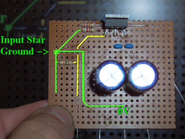

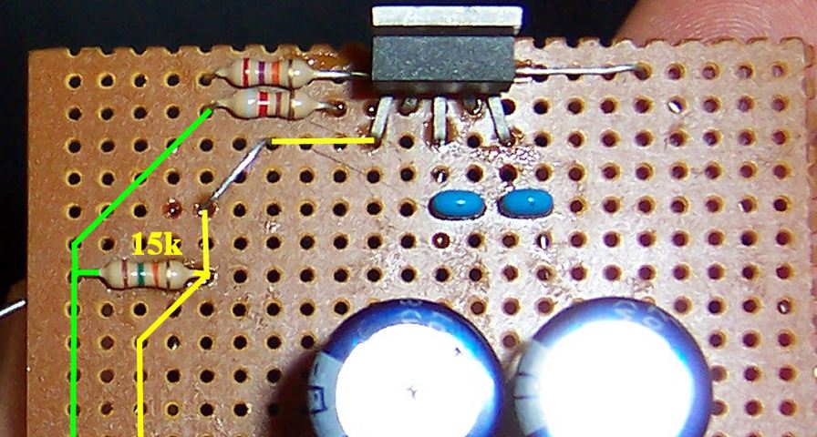

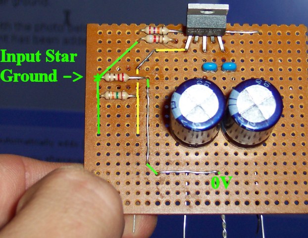

Its time to do the input circuit! Whee! 😉
The first, and most important part of the input circuit, is the 15k input impedance resistor.
This one is brown, green, orange.
It runs from the input + to the 0v (ground), thereby presenting a load.
Now, in the photo below, the "input star ground" has started to form. Have a look at the photo below and see that the NFB and the input will ground at the same point (marked in green).

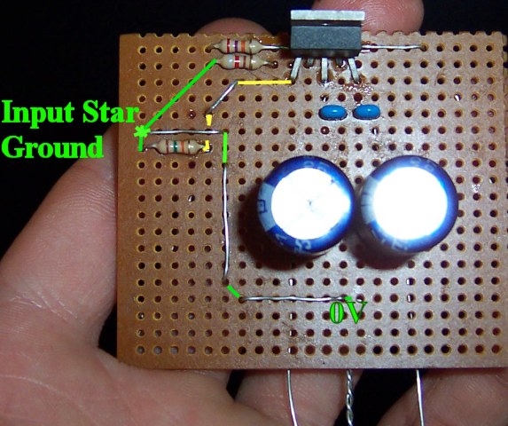

The following photo will show the hookup from Power ground to Input ground.
Compare this with the photo above. We have added just the one wire to make this connection.
This will complete the "input star ground" See photo--its marked in green.
EDIT: Notice that only one end of the 15k resistor connects to ground. The other end (marked yellow in the photo) is your signal + line.

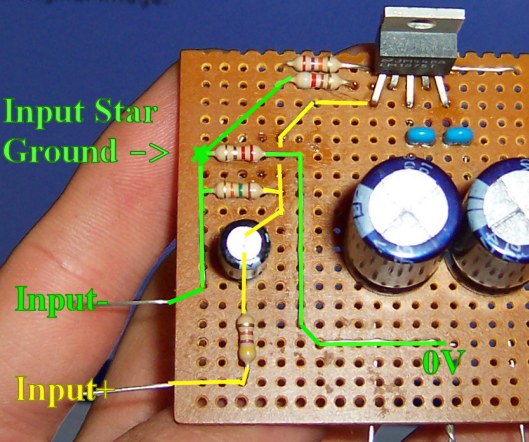

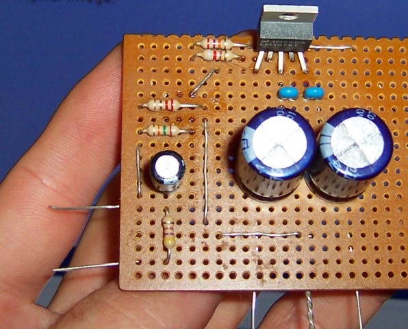

Hey, let's add our input filter cap and its compensation resistor.
The input filter cap blocks DC from entering the amplifier.
This particular input filter cap, I spec'd for 2.2uF.
*See previous discussion at post #8 and post #10.
Use either a "made for audio" electrolytic or any "poly" cap.
And, because source equipment generally dislikes a capacitive load, we have a compensation resistor. This compensation helps prevent the "endless search" for the "perfect" input filter cap. 😉 So, putting a resistor here is so much easier.
This resistor is 470R (470 ohms) and this one is yellow, purple, brown.
These are in-series with the input signal line.
See this photo and the next photo.

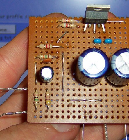

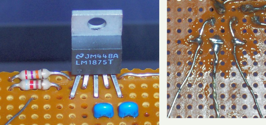

Optional Component, RF blocker
This is a tiny capacitor, 330pF (says "331" on it), that is added onto (parallel) the 15k input impedance resistor.
The RF blocker is a noise reduction component, thereby increasing the efficiency of the amplifier.
And. . .
Optional Component, input cable load
This is a 1M (1 megaohm) resistor.
It goes from signal input + to signal input - (as a load).
This resistor presents a tiny load, and its helpful that your input cords shall have a resistive load at the amplifier.
So, the 1m resistor is also a noise reduction component.
This one is brown, black, green.
