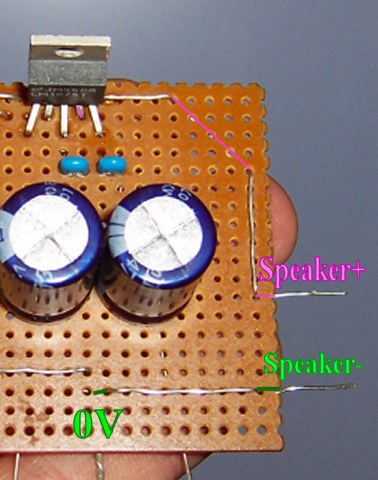

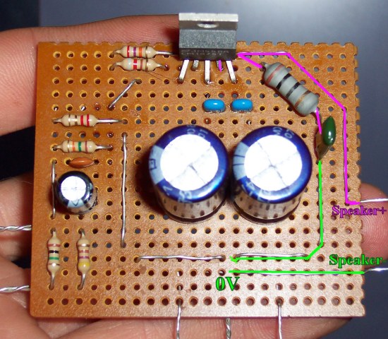

Optional Component, Output Zobel
Because a speaker wire is like a big antenna, and it leads directly into the NFB, then an amplifier could get some noise in through the speaker leads. A speaker output zobel helps block some of that. This is a noise reduction component.
In addition, the Speaker Output Zobel serves to enhance the stability of the amplifier.
This zobel shouldn't be within the audio band, but rather, just above.
For this, I've selected:
10R (10 ohms) and this one is brown, black, black,
plus
10nF, which is 0.01uF and probably has "103" printed on it.
Zobel. That's a resistor and capacitor, "RC," as a load.
This load is upon the speaker output.
See picture.

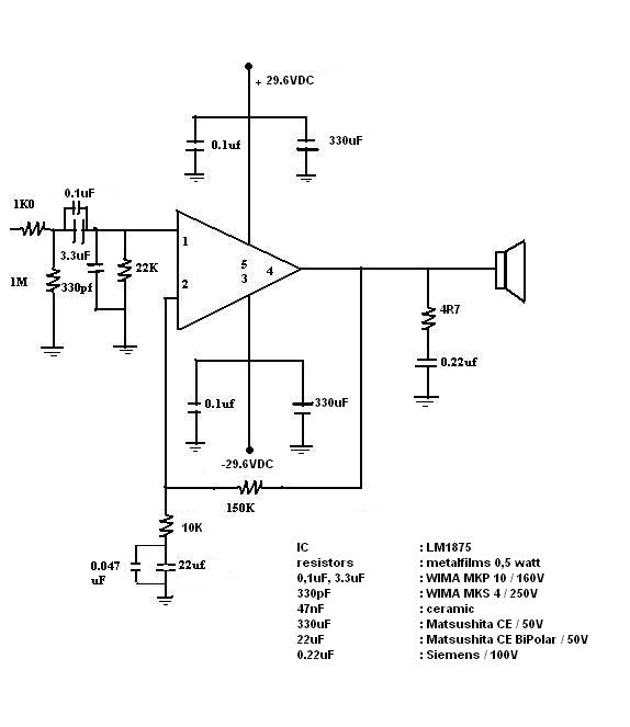

Would you mind posting the schematic for your LM1875 amps?
I just got some very unusual results with mine. Its lovely, but the output power doesn't match up with the PDF. It wasn't the least bit reserved about pumping out a fierce amount of power. Does yours do that too?
Sure Dan,
Here belows..
the Input caps is optional ( and critical ), if the woofer can not go or bad sounding on 20Hz-100Hz, 0.68 - 1uF will be OK.
can you specify?
sorry i got a technical subtittle problem ( again)
eketehe said:can you specify?
sorry i got a technical subtittle problem ( again)😉
Well, I think mine runs all the way to its theoretical 48 watt limit. It couldn't be doing more, because the thermal capacity won't allow.
Personally, I had used 4 ohm speakers; however, they're a 1st order crossover with BSC and lots of inductors, so "maybe" (and probably) it turned out to be more like a 6 ohm load.
On either 8 ohms or 4 ohms, it does 30 watts. However, its the 6 ohm load that can "coax" the LM1875 up to the 40's watts output. The LM1875 also appreciates the "difficult" 8 ohm speakers and will gladly hit them with a bit extra power, instead of faltering like LM3875. I'm not saying that one is more or less powerful than the other--only that chipamps are sensitive to speaker selection.
Oh thanks for posting the schematic! That's a "hi-ref" style, and a merry fight to find the "right" caps for it. I'll bet that you did exactly that, and that your amp is really wonderful.
Thanks again!

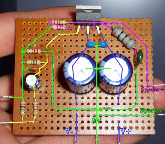

Re: MISSED

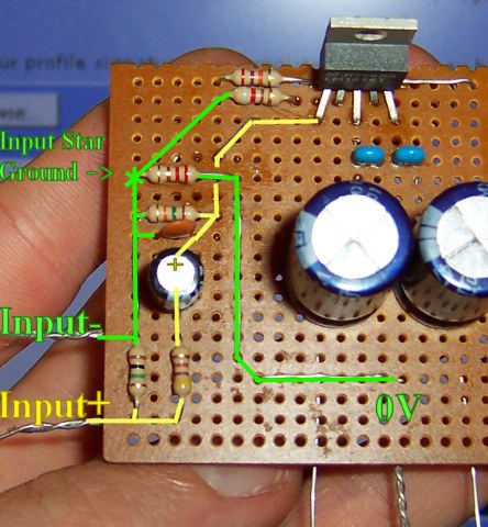

Oh, you'll notice that I left a big space in the top-left corner on the board of the amplifier that we designed here.
In case of DC offset (chips do vary), that space is for your 22uF cap (known as Ci on schematics). See how the ground from the NFB travels right over that space?
The + side of the cap faces the amplifier (and hooks to my 820R), while the - side hooks to input star ground. This "intercepting" the NFB ground with a 22uF cap does prevent the amplifier from being able to amplify DC.
However, selection of a "seemly sound" for a cap at position Ci, isn't easy, because it is used by the audio signal in direct proportion to the gain, so that any abberation in the cap is magnified/amplified.
There is the reason that I made the project without Ci, by using values similar to the Audiosector board (that doesn't use Ci).
There's a space for it if you need it.

Re: Re: MISSED
Error: That figure isn't 35 times, but rather a proportion of the voltage divider (two resistors, one hot, one ground, is a voltage divider, also called "fixed L-pad" by the speaker guys).
So, using a cap (at Ci) when you need to remove DC offset, isn't as frightening as it seems.
However, you do already have one capacitor to "select" for the input filter cap, and I just wanted to be clear that if you also use a cap at Ci, then that doubles the selection efforts.
Hey!! I think we covered it! 😉
P.S. Thanks eketehe, for your help and for the examples.

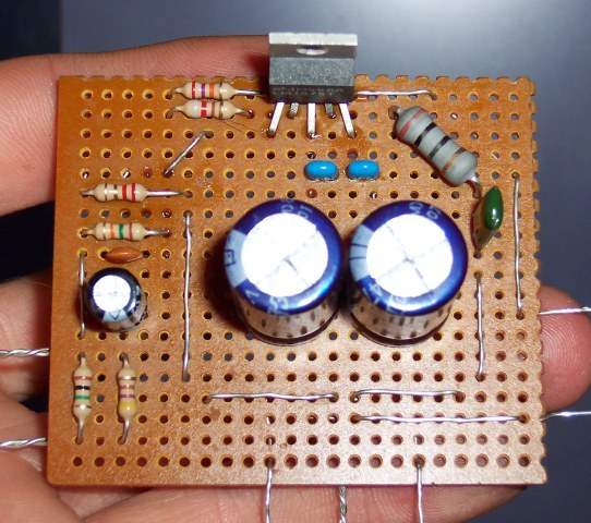

danielwritesbac said:For example, here's an LM1875 that I built on veroboard (phenolic, no pads)
I should point out that Veroboard™ has copper strips running along the board (hence the 'stripboard' name applied to both the genuine Vero product and its clones); what you've used is perfboard, available plain or with a copper ring or square round each hole to aid component fixing.
I'd hate someone to order the wrong thing. 😉
Thank you so much! What I ordered was that brand, but with no copper at all. Anyway, "Perfboard" it is, and thanks again.

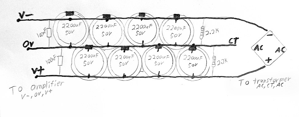

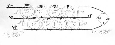

I'm back home temporarily and received a few questions on email. These had much to do with electronic dampening properties.
So, for that, one can try a 0.47uF input filter cap (some sort of poly).
And/Or, one can try the attached speedy power supply schematic.
Its set up for stereo.
The LM1875 in dual mono doesn't require 4x 2200uF caps per each rail. Half that much (2x 2200uF caps per each rail) will do fine.
Edit: This schematic visually resembles the actual power supply as it would be built on Perfboard (no-copper phenolic board), and possibly using Mallory SEK 50v caps or something speedy from Nichicon.
This schematic (click attachment) represents a basic form of power supply, and although simple, has provided excellent performance for me, and it has continued to do so, even in comparison to more complex alternatives.
There are many power supply options available for this amplifier, and this schematic provided is just one of the many available.
The bridge rectifier unit pictured is a KBPC1004 or KBPC1005, with clearly marked connections and an all-plastic body (safer than usual). KBU1004 (looks like a fork) also works well and also features clearly marked connections and an all-plastic body.
Feel free to use the famous KBPC2504 rectifier, but be aware of its metal shell. And, do please use appropriate safety measures that are copesetic with your local regulations.
Click. 😉
