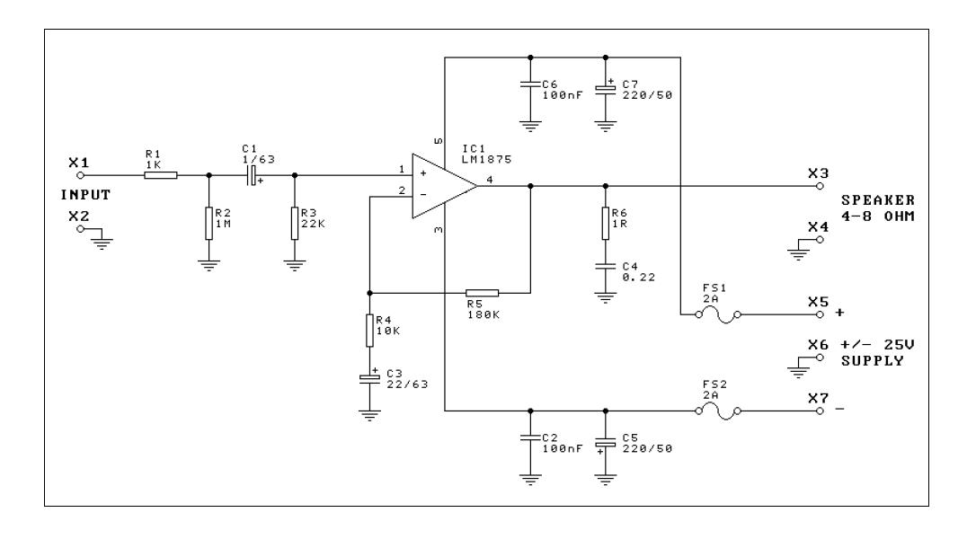

How much of the front end I'm I going to retain from the K50. C1 & R3? What values?
Maybe a schematic would be easier than so much text.
Here's the basic idea on the K50 fixup. See attachment.
Very fortunate choice of the k50 kit then. They're easy and fun. LM1875 has wide range tolerances (far easier to get "in the ballpark" when the ballpark is gigantic).lausar said:I need to slow down a bit as I've been cramping nightly to try and catch-up with you guys. This is my winter project along with remodeling my master bathroom so I'll be jumping back and worth between the two.

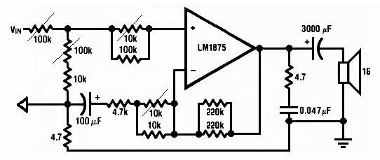

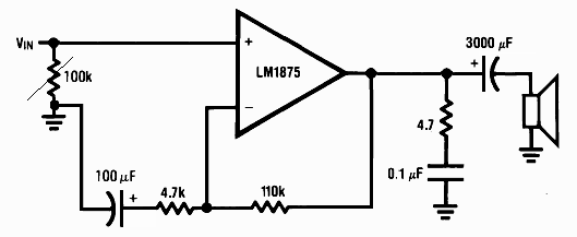

Understanding and redesigning the input stage of LM1875
use the schematic in the Thread you linked.
Change R3 from 22k to 100k. That should get the output offset down a fair bit.
Change R1 to a film capacitor.
Add xxxpF across R3. Maybe from 330pF to 1000pF to suit your ears and your speakers.
Read the rest of the Thread and pay attention to the grounding and the different parts of the grounding.
Lausar,

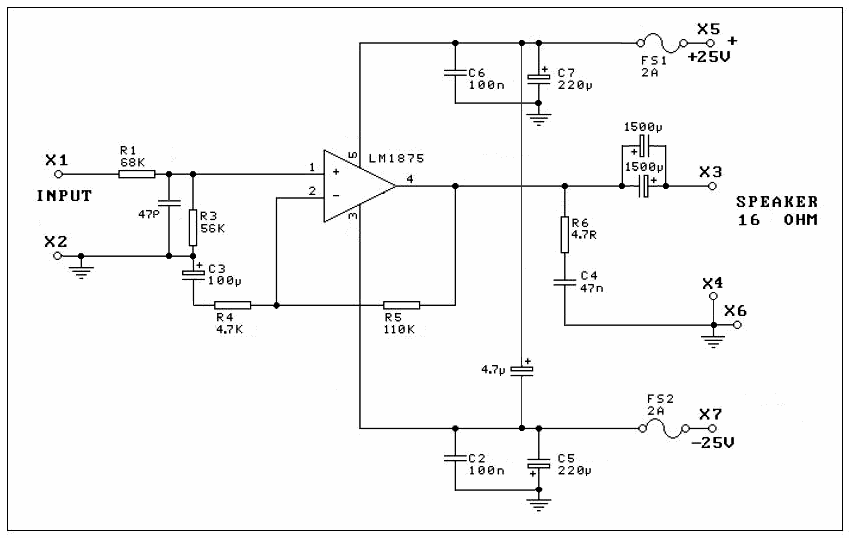

The attached schematic has nearly the same gain setting and ~100k input load but with your preamp's excessive voltage output put to good use--The amplifier sees significant feedback current and significant input load for higher resolution performance that relates to larger perceived soundfield and good stereo imaging. That's the difference.

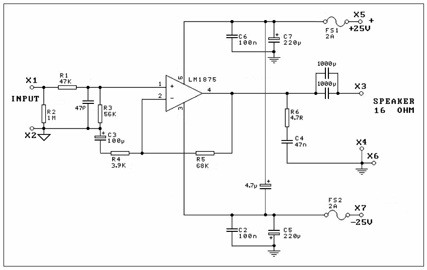

What's the 4.7uf used for?
What will the gain be and can you give me the formula?
Just arrived (no, didn't read the 12 pages of posts) but curious: Why do you add unnecessary output capacitors in series with the speaker?.
Besides showing them as polarized in post #111.
Wiring them in antiparallel will not turn them into bipolars.
In post #114 you attribute no polarity to them, maybe hinting you'll use bipolars there.
I wonder where you will find 1000uF bipolars but even more what's the perceived advantage of adding them there.
AFAIK the Gainclone idea is to build a very simple very flat and clean "piece of wire with amplification" , and big electrolytics in series with the speaker do not exactly fulfill that task, at all.
Plus, as I said before, you don't need them, that split supply amp has 0V DC at the output.
And a polarized electrolytic is not happy at all (as in exploding with a loud bang) with AC across its terminals.
The gain in this case is (R5/R4)+1=(68/3.9)+1=18.4
