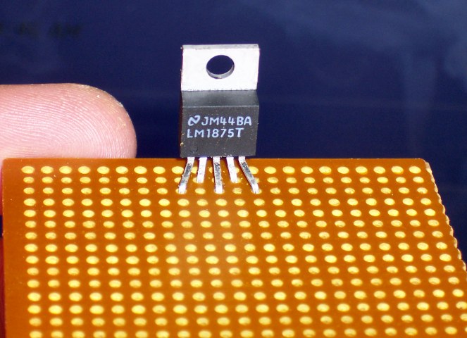

One more dumb question please 😱
Why perfboard without and copper instead of a board with copper. I this to keep leads as short as possible.
One detail: a typical "TO220" heatsink
won't be enough.
You'll need a finned heatsink at least 2" by 2" or equivalent surface.
Something like this or better:
And mounted so fins run vertical.

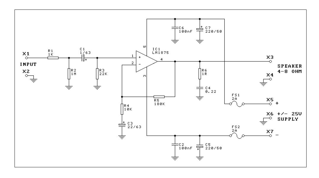

The old mixed/direct coupled design from post 1?
It offers the flattest response that a solo chip amplifier can do, and it has good clarity, but it has somewhat boring dynamics and slightly less durability due to the omission of the feedback-shunt cap. The caveats are typical of gainclones. The really flat response is not typical of a chip amp at all.
There were two patches for it:
Change the input load to 10k for decreased offset.
Up to 6600u output caps for speaker protector and longer lasting.
Both of the above are helpful for dynamics too.
I'll try to find the time to make a schematic for it.

For the original at post 1, circa May 2008, here is a slightly revised schematic, with the updates, protection, and quality control patches added. I've also modified the speaker zobel to use 1/4 watt resistors for lower cost.
If it is your intention to crack the plaster rockin the house with an LM1875 chip, I would suggest to Avoid this mixed coupled design. Mixed/direct coupled designs provide a flatter response by omitting an important signal capacitor and that omission causes decreased dynamics and decreased durability. The design posted below is for near-field, mixer-desk, a point of reference, and for relaxing with a non-shout amp that has good resolution and a flat response. It is very helpful for near-field/mixing so that you don't accidentally overdo the audio compression on tracks.
The intended source is a computer sound card. The gain is rather high on this amplifier so that you don't have to turn the computer up high enough to strain/clip itself. This was thoroughly checked out with RMAA software and a very wide variety of computer chips and sound cards.
It does also need mains fuse and speaker jack fuse. Monobloc/dualmono is suggested so that you can somewhat control current via transformer selection and so that you can enjoy wider imaging.

Hello !
About schematic above , post #151, on outpout there are 6600µf non-polar capacitors...
What is your explanation about ?
Not easy to source (or electrolytics polar 12000µf series connection ?)

I don't find much logic either in avoiding a cap in the feedback loop (so it amplifies DC) and then adding huge (unneeded) caps in the output. ¿¿??
