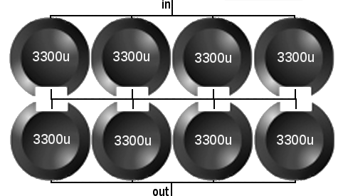

A reasonably decent quality parallel pair of 3300u or parallel trio of 2200u does not need an additional treble bypass cap because you already have parallel caps. However, it is okay to add an additional treble bypass cap. Nichicon ES 10u, 4.7u is an example of an excellent performer for this use.Thanks so much for the info on output caps for protection of speakers. Could you explain to me why it's OK to use polarized caps? I know that it is OK, as the Dyna ST120 that I'm using as a donor chassis has 3300u polarized output caps, but I want to understand why they don't need to be non-polarized. (though I'm certainly glad they don't need to be. Much cheaper this way.) And do they need to have smaller non-polarized caps in parallel with them for high frequencies? Many thanks, Keith
It is extremely popular for maximizing subwoofer amplifiers, due to the easily tunable bass that can thunder instead of boom. No amount of brute force with an equalizer is as effective as harmonic tuning. Works fine with full range amplifiers too. So, there is fun aspect to it.
Blocking subharmonic that the speaker wouldn't reproduce is helpful to both headroom and durability. If the polar cap successfully protects the amp then it also protects itself.
Necessarily, if the model of cap used can survive a bridge rectifier, it should be able to survive speaker output too (especially considering little 25 watt amplifier chips). Likewise, if a cap can't survive being used as an output cap then that model cap is totally unsuitable for use at a power board. Check capacitor datasheet for more complete information. When the amplifier is healthy, there's no DC offset anyway.
However, if the amplifier were to eventually wear out and break, it may be able to damage polar caps, but they do still cost less than speakers. I'll say bipolar caps are preferred.
Optionally, at slightly more cost, you can create a bipolar cap array using multiple polar caps in parallel-series. That prospect is what we'd do for enhancing the durability of output caps if used for a larger size split rail amplifier.
To do the high durability approach with polar caps costs about $8 per speaker, which is quite favorable for costing less than speakers. The 35v caps are quite compact and inexpensive.
High end sound and sturdy too, for about $3 more.

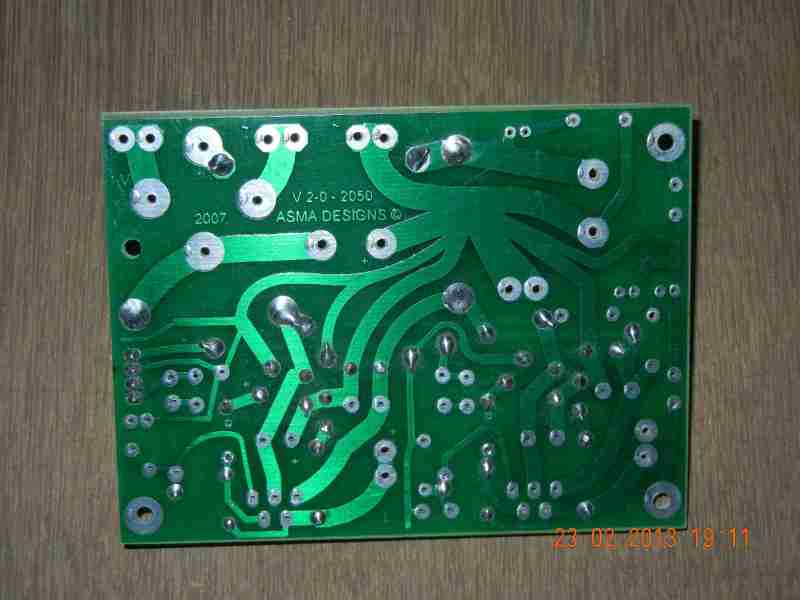

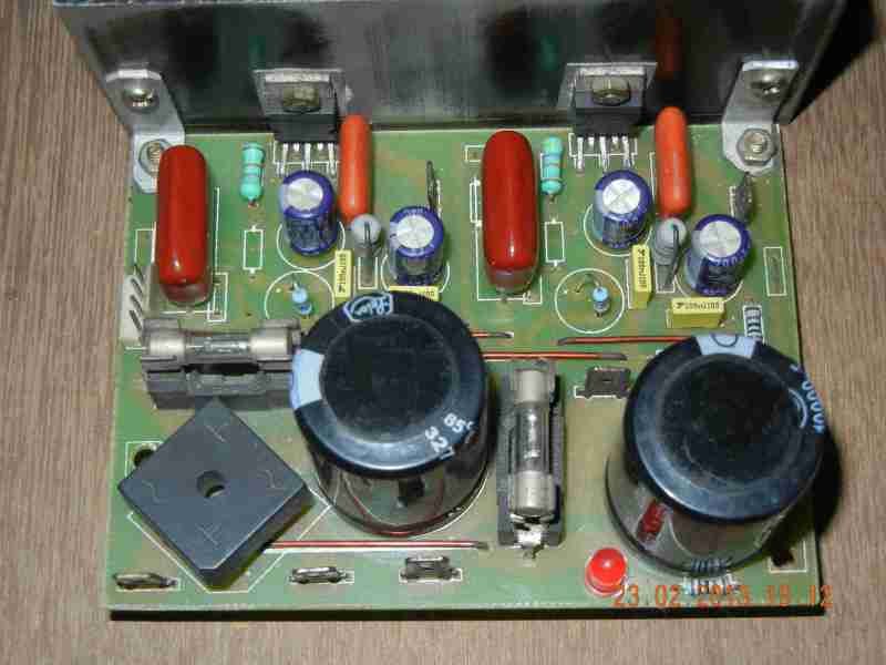

My board cannot take parallel chips. First of all it isn't a very well designed board. It was done in a hurry and there is plenty of scope to improve on it.
I tried some experiments with it and shall post on that later.
Pity I cannot find the board layout. It might be on my 'dead' computer. One hard drive died and the other is still on it. Will have to pull it out to see if it is still there on the good drive. No time for all that now. Too busy.
I'll take some pics of both sides of the board and post that.
Cheers.

It would be great to see the pictures. Thanks!Pity I cannot find the board layout. It might be on my 'dead' computer. . . . I'll take some pics of both sides of the board and post that.

Wow, excellent use of inductive series elements as noise filters, for both power and small signal.
Especially noteworthy is the inductive series element between the inverting input and the feedback-shunt resistor, which may drop the gain on RF. Personally, I would have installed a good brand of 1/2w carbon film for feedback-shunt resistor, but, it looks like your layout got the job done.
You might still enjoy a variable RC from "~" to "~" of the bridge rectifier.
The could be a 2u polyester cap and a 50R variable resistor.

There's a bit of fun to be had with that board. We'd need to flip the output RC's polarity so that it is resistor first (resistor at amp, cap at ground, is normal) and install a more compact cap. Now, at the output RC, the midpoint between cap and resistor has "Dr. Cherry tap" available. We could cable from there to a resistor added at the other channel's inverting input to install a stereo width effect. To avoid bass reduction, it probably needs a series cap (series with the new cable) and that cap located pin2pin with the output RC's cap (right at the Dr. Cherry tap, of course). Both channels done the same. Now, you have a slightly bass boosting stereo width effect. It is desirable to have the effect so tiny that it is transparently not obvious, so the added resistors would be very high value. Personally, I'd use only enough effect to make it sound like monoblocs, in which case, we may have cancelled some stereo build power circuit crosstalk. This prospect may require an amp that has an NFB-shunt cap present (and perhaps a tiny little polyester cap for treble helper). Adding the NFB-shunt cap would give you a dynamics, safety, power output and midrange boost, and you could set the stereo width effect to conquer the midrange boost. (Adding a rail2rail cap helps too, such as one 250v 4.7u from v+ to v- probably at the two big caps.)
Anyway, it is actually possible to redeploy a very small amount of a popular stereo width effect as a useful compensation on stereo boards. I'd estimate that the effect may remain reasonably transparent up to about 12% of the gain factor or less than that much. It will reduce crosstalk gain by as much and therefore sound slightly quieter (you may need a small amount of regular gain boost to recoup). The circuit tells each chip "don't do what your neighbor does" and a little tiny bit of that can have it sounding like Monoblocs. Generally, negative feedback is responsible for power noise reduction, and I believe it is possible to use a tiny bit of width expander negative feedback on stereo board for stereo crosstalk reduction as well. That board looks particularly well able to do this. The bonus is making leeway in midrange ear tolerances so that you can re-install your NFB-shunt caps for more safety and more dynamics power.
