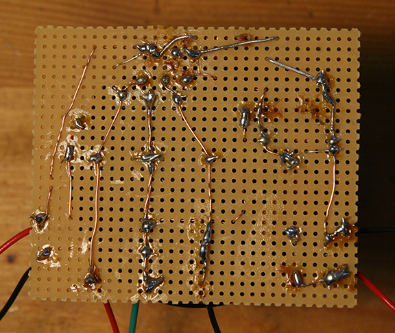

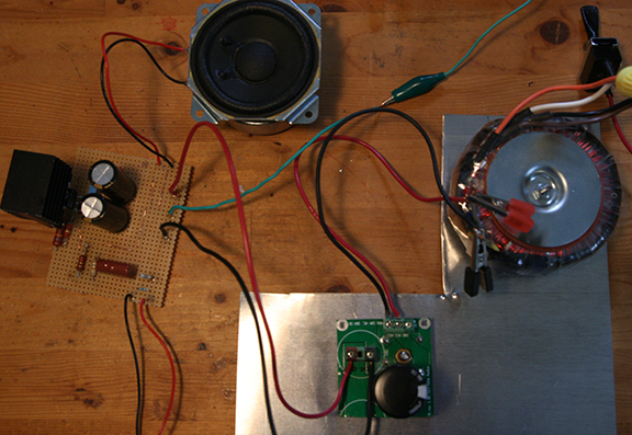

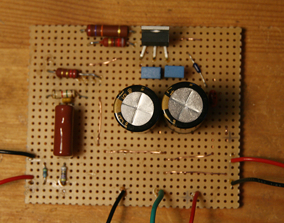

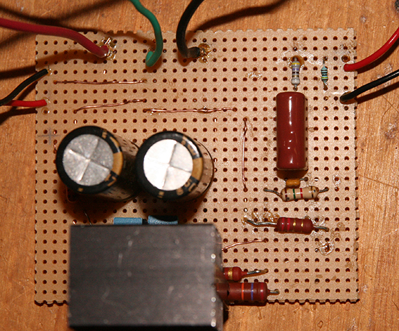

Well- I have managed to get one board completed after a couple attempts. 🙂 Problem is it sounds really bad- very crackly and cuts in and out.🙁 It's worse at lower volumes. I have tried 3 different speakers and 2 power supplies. I don't have the proper power supply yet so I tried a 12v meanwell and a 18v wall wart.
I have checked it over against Daniels photos several times but can't find anything wrong with it. Could someone kindly take a look at my photos and tell me what might be wrong. I haven't cleaned it up yet so forgive the flux mess

The heatsink is missing!!!
And that amp does require split rail power, not a wall-wort.
Cutting in and out is the overload protection running, and the sounding really bad is your speaker cooking.
P.S.
That amp is incomplete and can't function right because. . .You need a heatsink, a center tap transformer, a bridge rectifier, and some caps for a power board.
P.S.
Thanks Daniel. I was anxious to hear how it sounded and so hooked it up to what was at hand. I do have a couple toroidal transformers one being 9-0-9 and the other 30-0-30. Neither one the right size. I also have a couple small rectifier boards. I'm guessing it be best to test it with the smaller transformer?

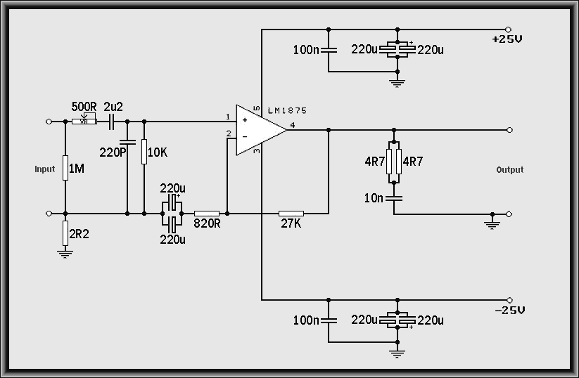

Daniel last year I tried lm1875,, it was very musical but very noisy..This is my own tests and observation.
Surprisingly I could not build a lm3886 amp from that same power supply.It always turn so hot eventually it fuses.I had a power imbalance of about 1volt.May be something went wrong with my schematics.
By the way cant we use a 10K pot for that 1M resistor.

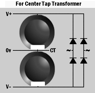

Ideal for an LM1875 with an 8 ohm speaker:
18+18vac, either 1 ampere dual secondaries transformer or 1.5a center tap transformer.
Ideal for an LM1875 with a 4 ohm speaker:
12+12vac 2a center tap or 13.5+13.5vac 2a center tap.

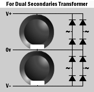

and,
These lower voltage transformers (which can be found everywhere) also work for use with 8 ohm speakers--with lower voltage you wouldn't get all of 25 watts, but you will get a working amplifier.
You can find the 24vct (12+12 center tap) at many places, such as the hobby shop or hardware store. On this popular EI core (square), there usually "12, 0, 12" stamped or marked on it, so you can identify it easily.
Ideal bridge rectifiers:
KBPC1002, KBPC1004, BR84
These lovely square things have all of the contacts very well marked so there's no confusion.

Noise?Daniel last year I tried lm1875, it was very musical but very noisy.
. . .I had a power imbalance of about 1volt.. . .
That is probably build error, but it could be Source.
Amplifier will make much noise if your input load is incorrect. Mine are silent at full blast and without a pot. The Post1 design is for near-field studio mixer use (also works at computer desk). Audible noise output is Zero.

So it seems im having a psu issue. Im using an avel y23 series at 18 0 18. When testing the secondary across the ac im getting 20 20. a little high, but thats not the issue. When i test the DC from rail to ground at the rectifier i get 27 per rail! what is happening here?
the transformer hookup is parallel at primary, series at secondary with the orange and red tied for my 0 line.

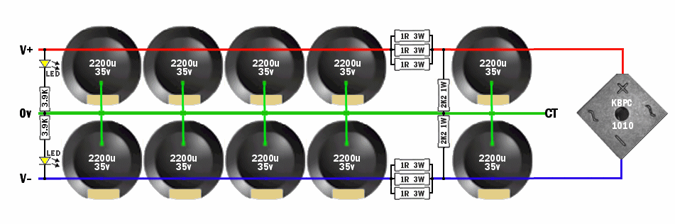

Have you powered up the transformer, rectifier and smoothing capacitors and checked you have it wired correctly?
Have you powered up the transformer, rectifier, smoothing capacitors and one channel of amplifier and checked you have it wired correctly?

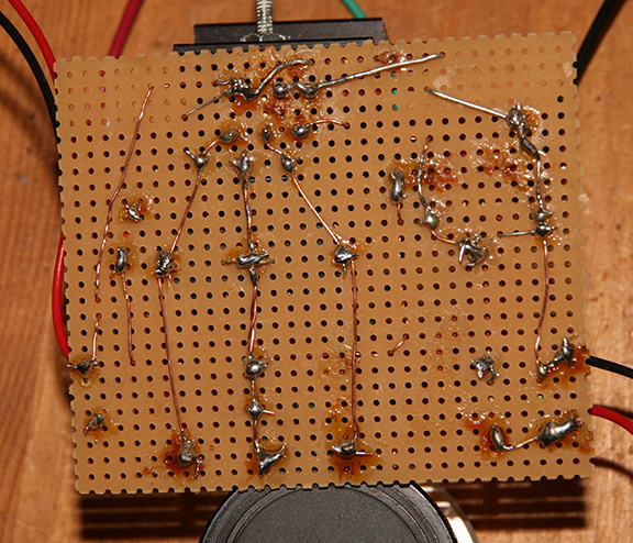

Well I seem to have something buggered up. 🙁 I've connected the amp boards (have 2 completed now) to a 9V transformer and rectifier. I know that's not enough to properly drive these amps but I would think it would be enough to get some sound. There is 11.4v reaching the board. Problem is there is no sound at all on either board. I think some of the components may not be right. I followed the label on the bags from DigiKey but they don't look the same as on your photos.
Any suggestions please 😕

Prezden, is that a dual supply+9 0 -9 xformer? The pics look like you have only 2 wires from the toroid...
I see that the small signal corner of your amp board still hasn't been fitted with NFB-Shunt Cap. And because of that omission, the chip may be broken easily by power mistakes.
You need to cut the connection from the 820R to ground and patch that cut with a 470u (or 220u||220u for higher quality) capacitor as shown on the schematic at post 1. Have a look.
Signal can cross that capacitor, but DC does not. Blocking DC there, prevents amplification of DC. The layout has a big blank space on the corner where you should install this cap. Do it soon! You need it!
Introducing. . . Split Rail power. (typical of home audio amplifiers)
Have a look at a 2-battery flashlight.
