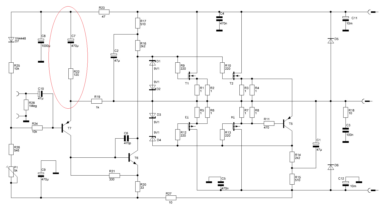

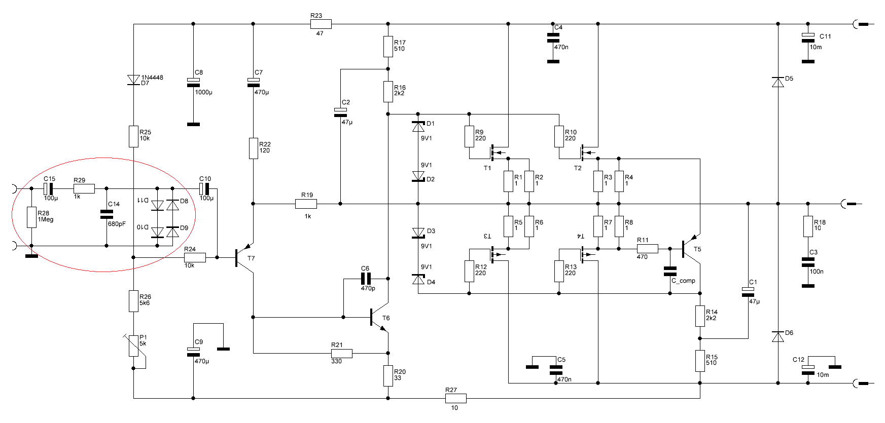

Let's think again very quickly, but not deeply, more with the gut (everything else goes beyond my propagated DIY-Communication style :snail:) - and look at the schematic below.
But, a deeper look at the world-famous schematic of the NAD3020i expands our options dramatically - we can steal a little something from there.

the 25 watt figure in the thread title is to be understood as an advertising statement - another cat leaves the bag.

You dont get that the problem exist only for this kind of topoogy and not for differential IPS, and that those latter
can endure whatever input level with no consquences for the amplifier..?..
A differential IPS output current is limited by a current source that provide at most a few mA to drive the VAS, while
those pseudo-CFAs have unlimited IPS output current, actually only limited by the emitter degeneration resistance
that is 120R in your exemple, so theorically up to 200mA IPS peak output current to drive the VAS base.
So I wouldn't give you full marks for this exam answer because it's not quite correct, or does it cover all possible operating cases?
while
Well, look again with a little more accuracy, I see R19 = 1000Ohm. From this it follows, over the thumb +/-25mA. Furthermore, I see R16+R17 = 2710Ohm, which also results in +/-9.2mA over the thumb.
Have you really and truly calculated Vcc/R22 ????
speechless,
HBt.
PS
My calculation and therefore the figures are not really correct either, but it illustrates and depicts reality more closely than the moonshine statement quoted.
That s clear enough methink.
The current that flow from a transistor collector cant come from elsewhere than from its emitter, and from the path
of smaller resistance that is connected to said emitter.
In AC mode this current will flow through the 120R resistance and through the capacitor that goes to GND,
with a differential the emitters are connected in serial with a current source.
What level do you want to go down to - I feel like I'm in Kindergarten right now.
As soon as we want to move on to semiconductor physics, I say:
I'd love to.
But if this **** has to be carried out in the DIY forum, send me a few exercises on the bipolar transistor via PM, which I will then solve atok in a video conference.
Or should I prepare a lecture script on the processes at the PN junction?
Exactly, here the emitter of our input transistor represents a special node, correct ... and further on in the text?
And to top it all off, both emitters are connected to each other, a node has been created.

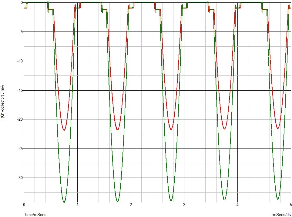

Those who know what it is about have already made the conclusions, all i said is 100% accurate and can even
be easily checked with a simulator, wich i did btw and wich you didnt, so rather than useless talks here the IPS output
current that get through the VAS base when the input signal is 3.5V RMS in red and 5V RMS in green.
So now good luck in getting the laws of physics obeying your expertise.

Input /signalsource - voltage:
u1red
= 9.9Vpp
---> need +/- 51Vcc Rails
u1green
=14.14Vpp
---> need +/- 71Vcc Rails
in order to be theoretically controllable - "aussteuerbar zu sein"!
Beelzebub can only be legally controlled up to the overdrive limit of slightly more than 40Vpp - that's why the headline says 25Wrms at loads of 8Ohm - and nothing else.
R19 / R22 +1 = 9.333
maximum input voltage of the present amplifier that may have to be limited (basically completely independent of the design of the IP-VA stage) with a gain of 19.4dB
is
20Vp / 9.333 = 2.143 Vp
equal to
1.52Vrms for sinusoidal !

Rl=8Ohm
u1=1Vrms
u2=9Vrms
This corresponds to a real 10W in class A mode of the output stage, now an almost undistorted, sinusoidal collector current (of the input transistor T7) of an incredible 80µA peak to peak flows - says my PSPICE.
With higher input levels, of course, this time function ic(t) is visibly deformed. At the safe level limit it is a 120µA peak to peak flow - or variation.
Now the fantasy story:
u1=3.5Vrms; 5Vrms; 7.5Vrms; 10Vrms; 18Vrms - (sine)
---> ic_span -> 20mA; 30mA; 50mA; 65mA; <100mA the time function can no longer be sinusoidal, which is immediately obvious to anyone who knows what a BJT is.
