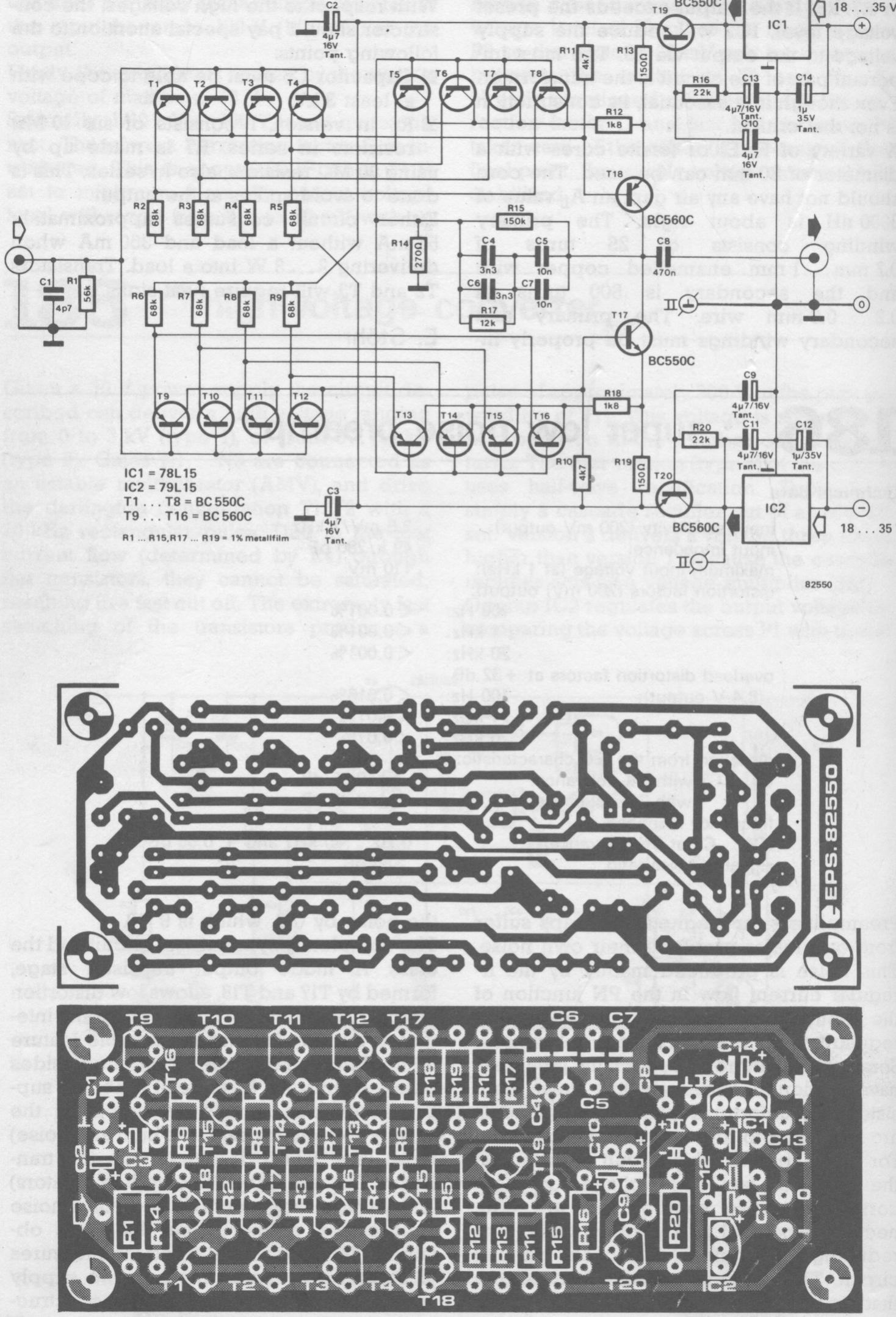

So i'm confused a little now.
Is this the original preamplifier, are we speaking about the same thing?

The schematic that thimios posted is the original supra schematic and basically the one I modelled in LTspice. The upgraded version with multiple LT1028 in parallel is top secret just like Kay said; it hasn't been attached here anywhere and I haven't seen it myself.

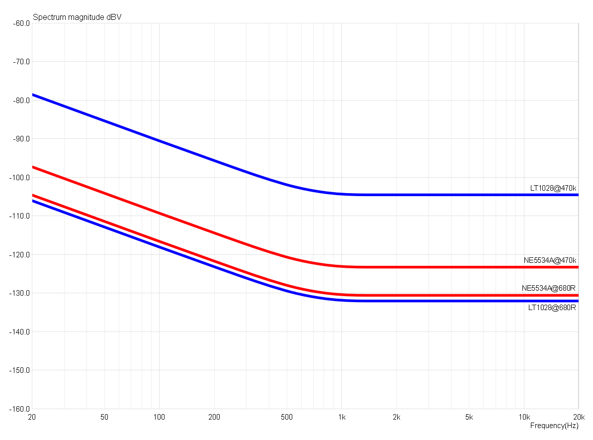

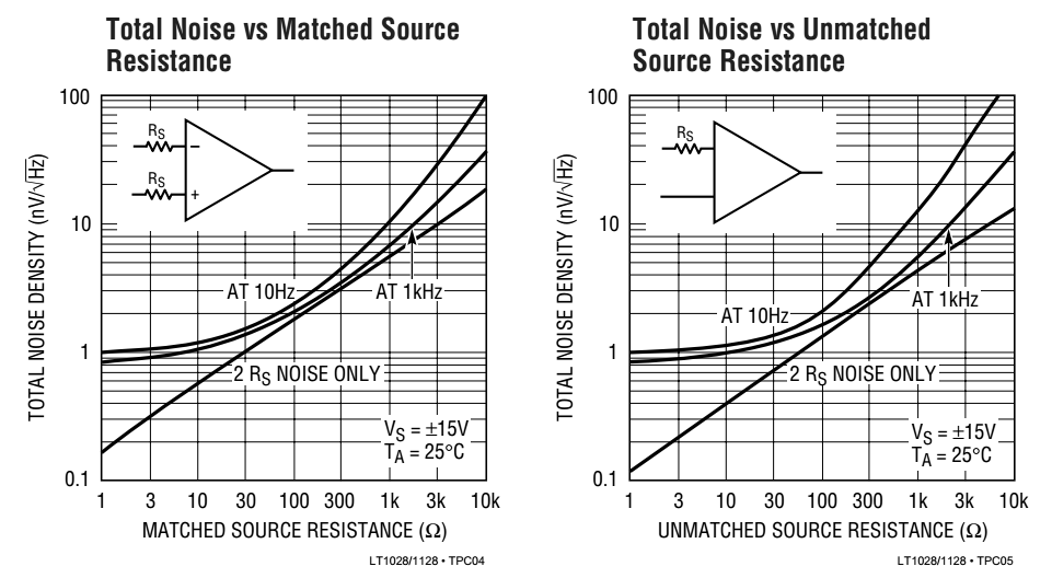

Another take at the LT1028

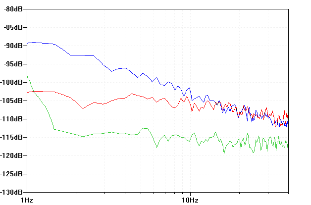

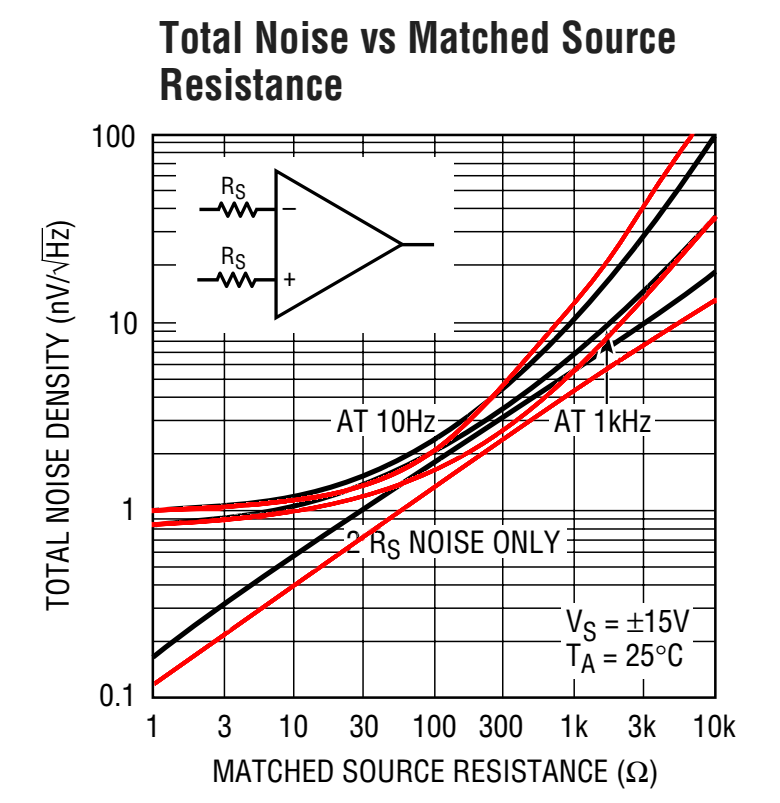

In another thread regarding the use of the LT1028 as a phono preamplifier in a German forum somebody pointed at the total noise diagrams of its datasheet and wrote that the influence of the bias cancellation is only relevant at higher impedances. I've combined those diagrams and tried to derive some useful information from them. This is what I understand: Since the graphs match up pretty good most of the time, the cancellation circuit seems to be effective in that the total noise for an unmatched circuit with RS is about equal to the matched circuit with 2xRS, which should be inherently noisier due to the doubled impedance. Matching the source resistance is only possible with MC systems though, since the impedance of an MM system changes from its DC resistance at the lower end (say 500R) up to around 30k with the usual 47k resistor at the preamp's input, while the RIAA network's impedance stays fairly constant (say around 300R) and rather low for overall low noise. Hence the 'updated' supra 2.0 might be a better (but rather more expensive) choice for MC systems, but certainly not for MM.

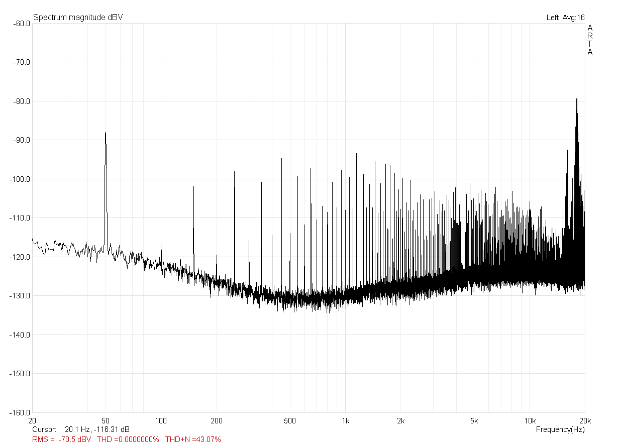

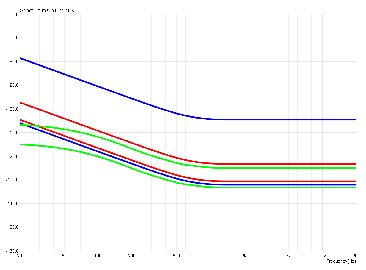

Since I had the stuffed circuit board ready and a spare LT1028 in the parts bin, I did a little comparison between it and the NE5534A. Due to the varying impedance of the MM system and me not having one at home right now, I settled on terminating the preamp's input with a single resistor, but for two different frequencies. What I had at hand were 680R and 470k, which, in parallel with the 6k8 input impedance of the preamp, resemble the cartridge's impedances at around 170Hz and 13.6kHz, respectively. To compare apples to apples I only took the corresponding readings from the spectrum:
Code:
		170Hz	13.6kHz
LT1028  @680R	-122dBV
NE5534A @680R	-122dBV
LT1028  @470k		-104dBV
NE5534A @470k		-123dBV
You can see the test circuit and the whole graphs attached (measured with ARTA and then re-drawn for better legibility). They clearly show that the LT1028 isn't that much better with moderately low impedances (~614R) and does not perform well with source impedances above 1k (470k in parallel with 6k8 is around 6k3), which is perfectly in line with the datasheet:
Code:
Best Op Amp for Lowest Total Noise vs Source Resistance
Source		Best opamp	Best opamp
resistance *1	@ 10Hz		@ 1kHz
0 to 400 	LT1028/LT1128 	LT1028/LT1128
400 to 4k 	LT1007/1037 	LT1028/LT1128
4k to 40k 	LT1001 		LT1007/1037
40k to 500k 	LT1012 		LT1001
500k to 5M 	LT1012/LT1055 	LT1012
>5M 		LT1055 		LT1055
*1: Source resistance is defined as matched or unmatched, e.g.,
RS=1k means: 1k at each input, or 1k at one input and zero at the other.
The LT1037 looks really interesing and might be a better alternative to the NE5534A at MM-impedances, although it's still pretty pricey in direct comparison. Unfortunately I don't have one in the parts bin, else I would have tested it right away ;).

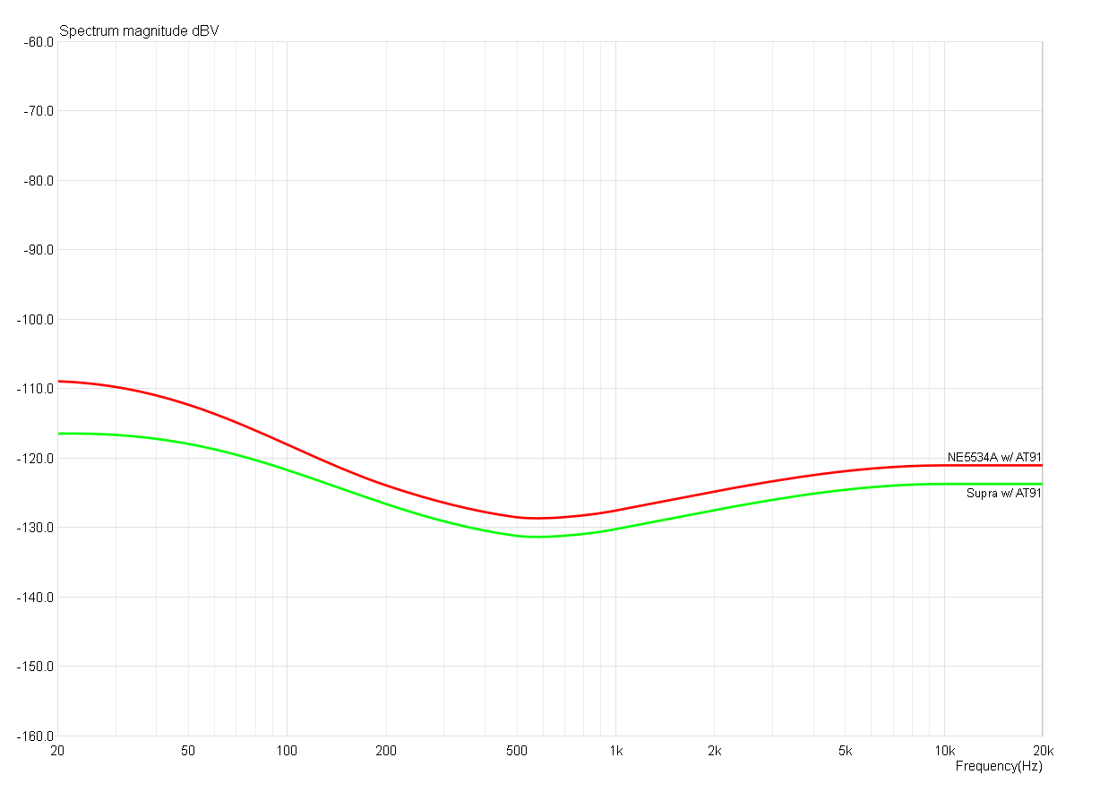

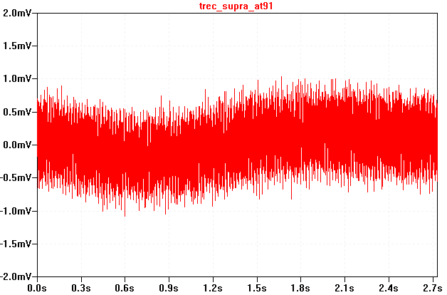

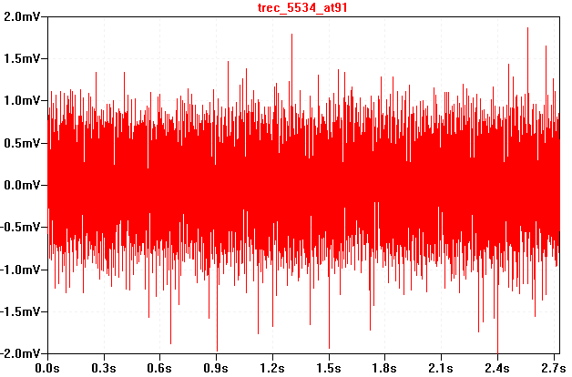

Brought my vintage turntable home today and hooked up the cheap Audio Technica AT91 to my testbed-preamps with some cat.7+ cable. Shielding was basically non-existent though, since the preamp is not encased in any way, which resulted in most of the noise being 50Hz mains and something around 16kHz and 18kHz coming from the computer itself.
The LTspice-integrated RMS noise figures for the below waveform plots are ~250uVRMS for the supra and ~300uVRMS for the NE5534A, most of that being 50Hz mains hum.
I recorded a track with audacity, normalized it by a couple of dB, and played it back. The noise (even that mains hum) is already low enough that it is not bothersome for normal listening. In the silent passages between two tracks for example I can hear it, but certainly not at normal listening levels. Via headphones it might be a little annoying (didn't test it), but I'm not planning to listen to any record via headphones anytime soon...

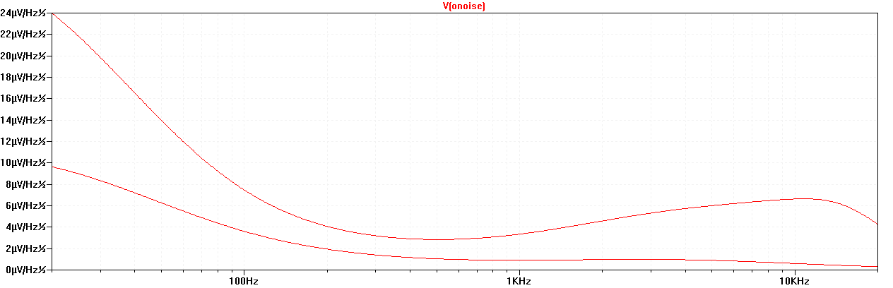

I've had a look at the schematic for the supra 2.0 now. Since the input is terminated with 100pF and 47k, it's probably meant to be used with MM systems. The design comprises of four non-inverting LT1028 working into an inverting buffer with a total gain of 45dB at 1kHz, followed by a three-stage active RIAA network including a 10Hz and a 50kHz pole. The pcb is solely surface mount and the four other opamps are LM837 in a single package. Not much to complain so far, since all parts are standard E48 values and thus easily available. Overload performance should be as good as it gets, since all the gain is in the first stage with the others basically being buffers only. Reducing the overall gain would yield some more headroom (I've opted for 35dB instead of 45dB), but that's another story.
Of course I had to simulate the circuit with a noiseless inverse RIAA network and the cartridge values of 410R and 480mH, and here the simulator seems to confirm my concerns. See the results attached. With the LT1028 model for the parallel input quad and my NE5534A model for the other opamps, the output noise in the range of 20Hz to 20kHz integrates to almost 830uV. Using my NE5534A model for all eight opamps, the result is certainly a lot better with an RMS value of only 115uV! Using the NE5534A model from TI's website the result is even better still.
The sim might not hold true in the real world (the absolute values certainly won't), but if I were the inventor of the supra 2.0, I'd certainly get myself some NE5534A and pop them in there to be sure - they're not that expensive after all :rolleyes:.
