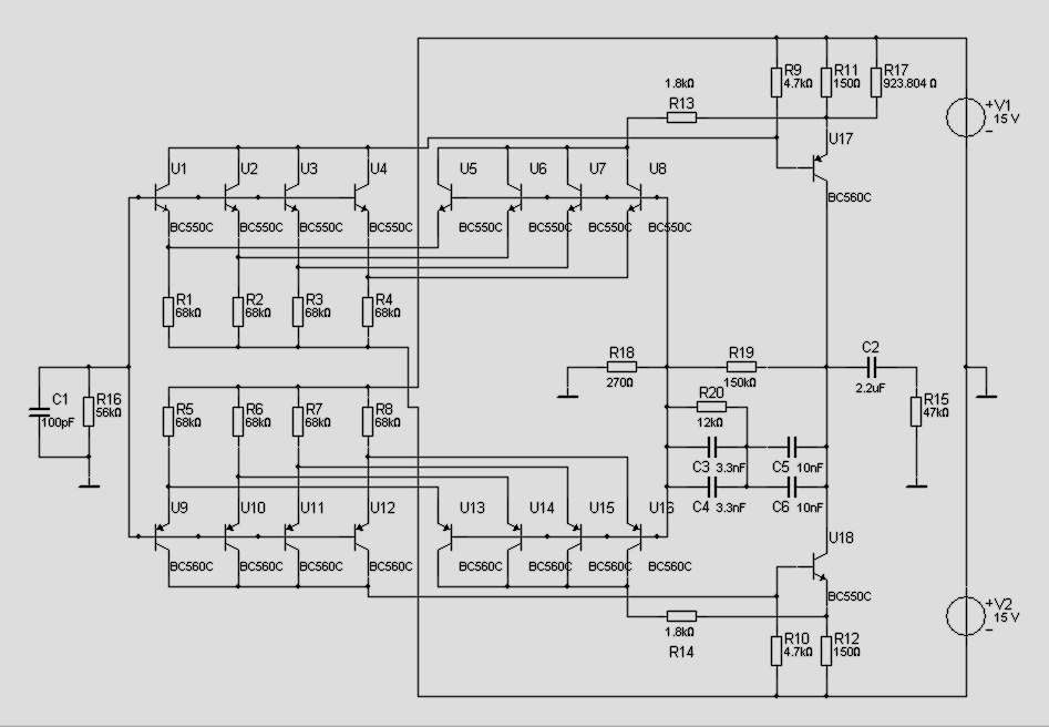

lineup said:
This low noise riaa
is easy to build - opamp style with common transistors
and will have very great performance - if my sims are somewhat correct.
I think a good PCB prototype silksheet
would be of interest and use for 'Analogue people'
Now 🙂
when the hype of the day is about Low Noise
this project is interesting.
It shows what we can do by using low cost transistors
---> in parallell
to achieve reduced input noise
2T - 3dB
4T - 6dB lower noise, as used in my symmetrical design here ~ half the noise
8T - 9dB
16T - 12 dB, same as 1/4 of noise of 1T
Lineup 🙂 good & low cost audio regards

Som links lownoise circuits to explore:
LowNoise multi parallelled differential BC550 bipolar input RIAA (from old Elektor originally)
http://www.diyaudio.com/forums/showthread.php?threadid=91497
LSK389 JFET input pair to LowNoise bipolar Op-amp
http://www.diyaudio.com/forums/showthread.php?postid=1519372#post1519372
Cicuit: http://www.diyaudio.com/forums/attachment.php?s=&postid=1519372&stamp=1211672608
syn08 circuit:
http://www.synaesthesia.ca/files/headamp.png
Let's hear what people think 😀
I just dont like to make gigantic and complicated circuits for the task here

please help me!!!!
hi!
My name is Paul Mesaglio. I'm from Argentina and some time ago I found the "super low noise RIAA phono preamp" magazine Elektror. I'm a big fan of DIY (indeed I create guitar effects called RETROHEADFX) and was about to make me one when I found this forum your modifications. I immediately began to do them but I have some doubts:
Finally the two 15K resistors (R17-R21) are removed or fall?
Is the final circuit of post # 16?
I hope you can answer me because I am very close to finishing the design (Corel do first and then step ALTIUM ... if you're interested I can send files)
thank you very much
ps: sorry for my english🙁🙁

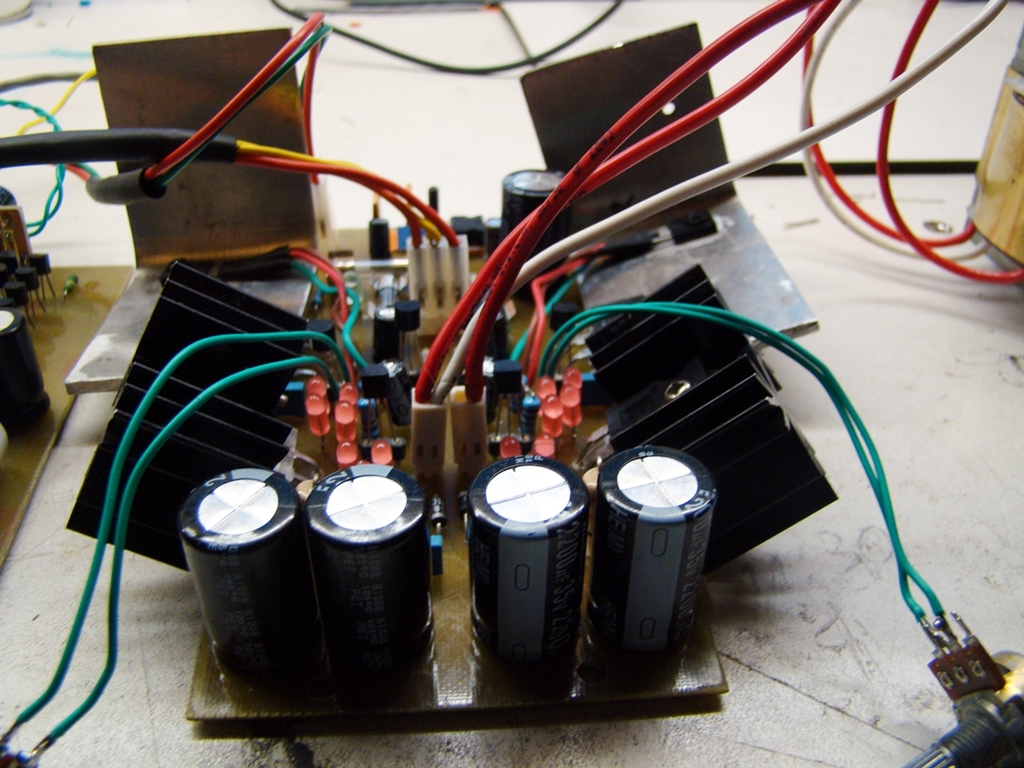

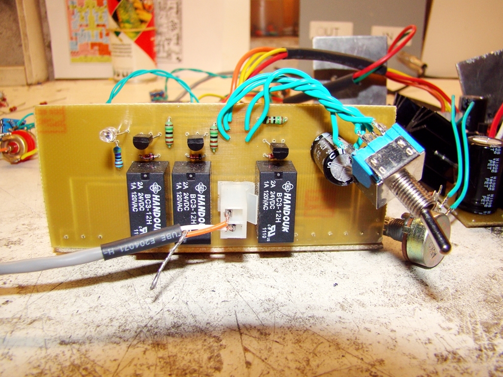

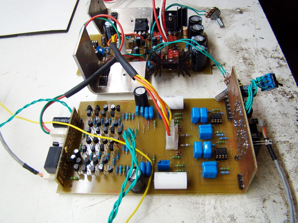

This was an old thread and all my links are changed. As I mention I have designed a massive overkill RIAA amp

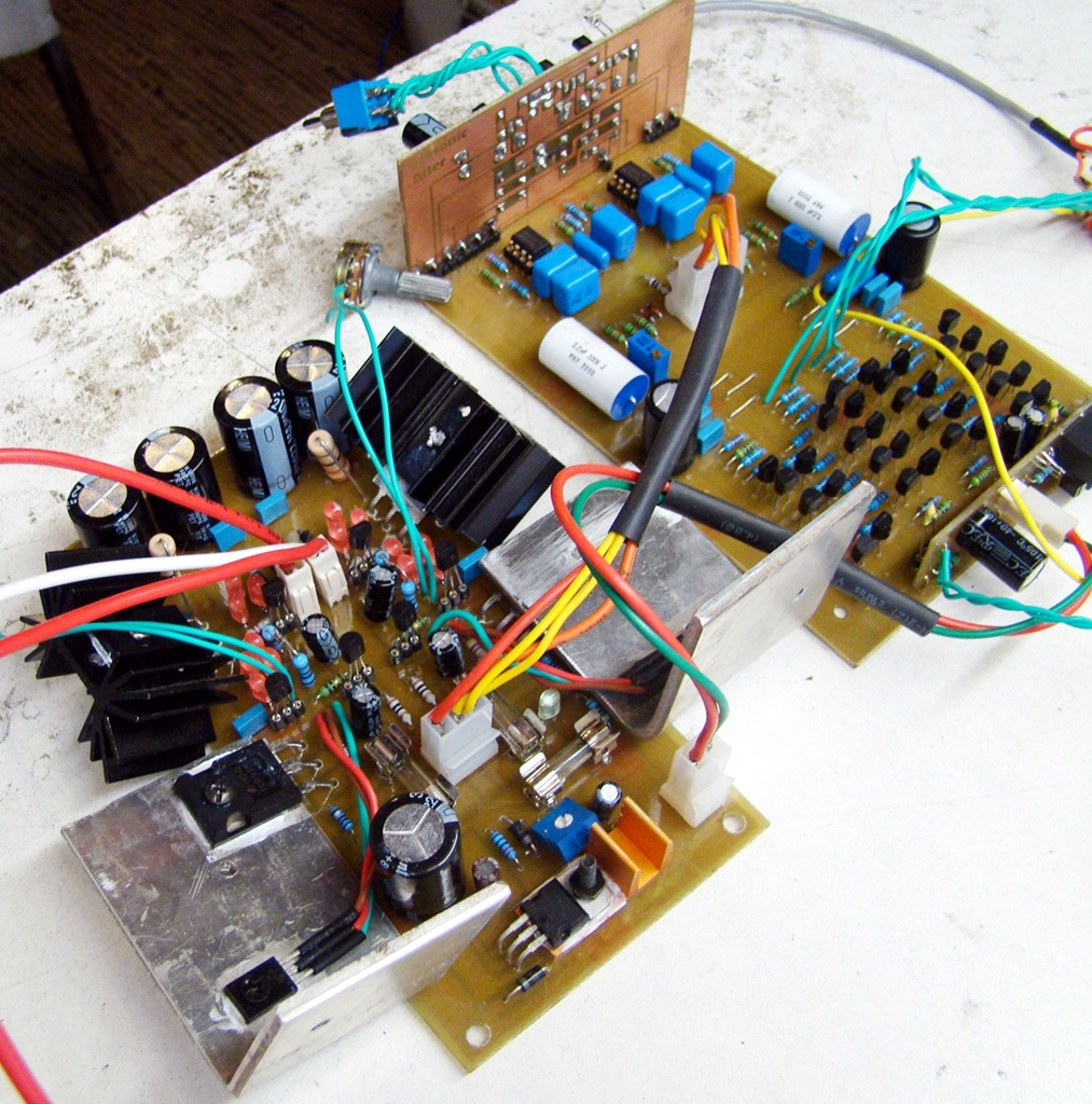

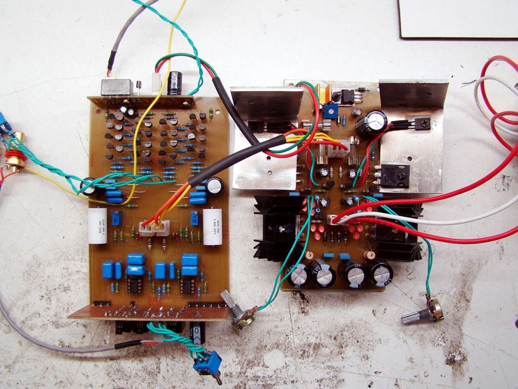

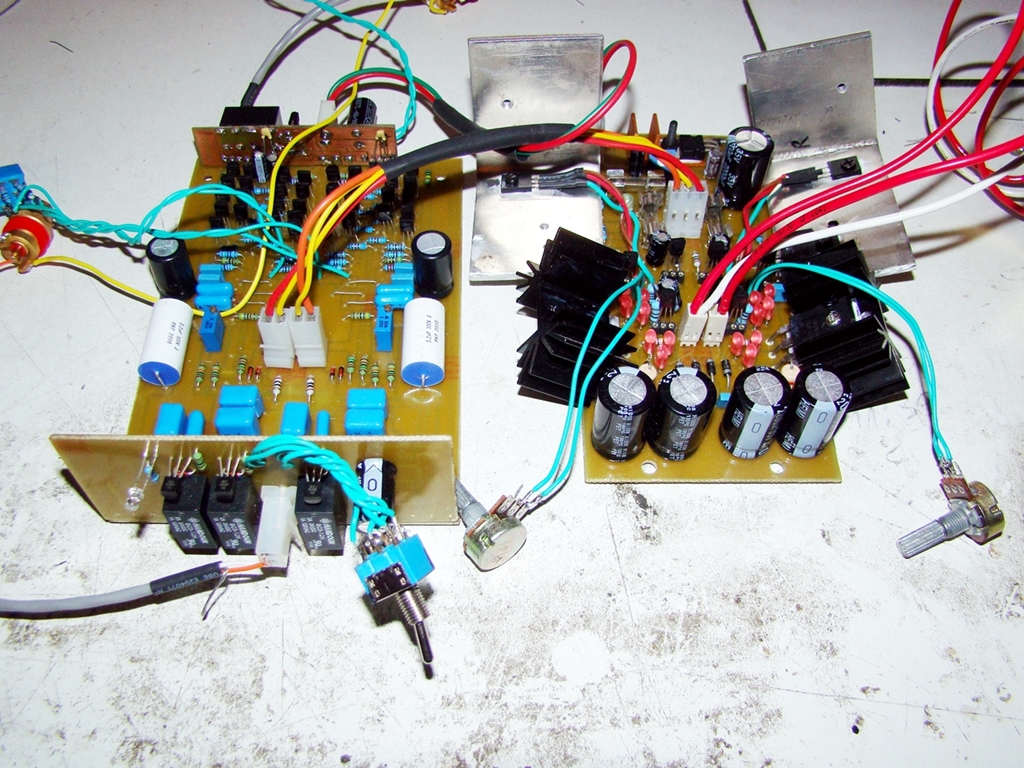

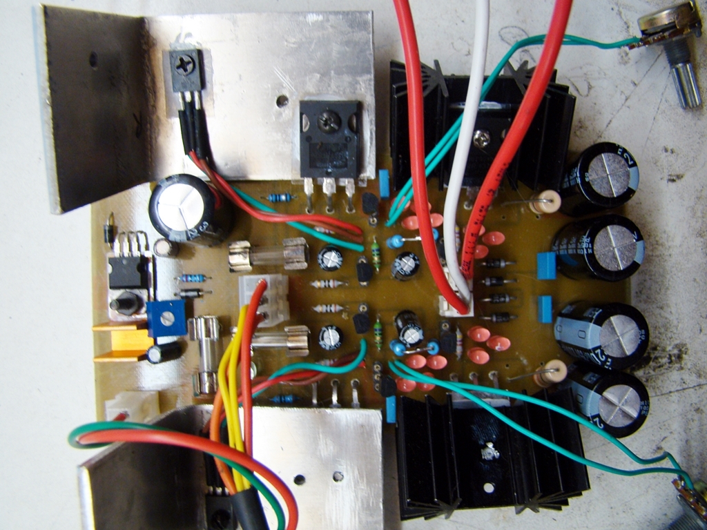

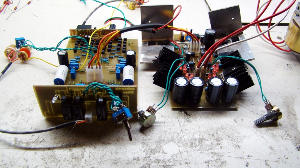

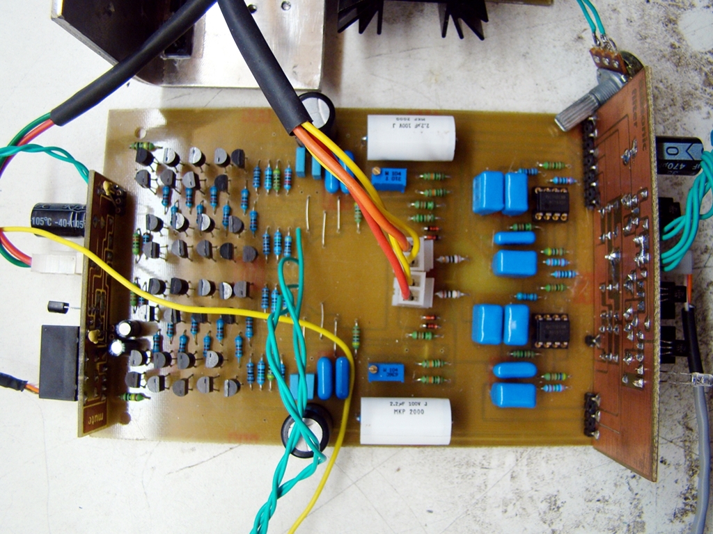

my version of SUPER LOW NOISE RIAA PREAMP
HI
This is my version of the preamplifier. I'm still working hard on it. I added a relay for switching the input to ground or sent to the circuit. I did it with the intention that when changing a vinyl avoid having to lower the volume on your power amp or preamp ... just flipped the mute switch and I can manipulate the vinyl without any noise. Also I added a subsonic filter that can be bypassed by relay. The power supply is also a version of the "salas shunt regulator" .....
again...sorry for my very bad english!!!!
HI
