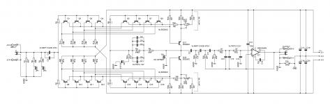

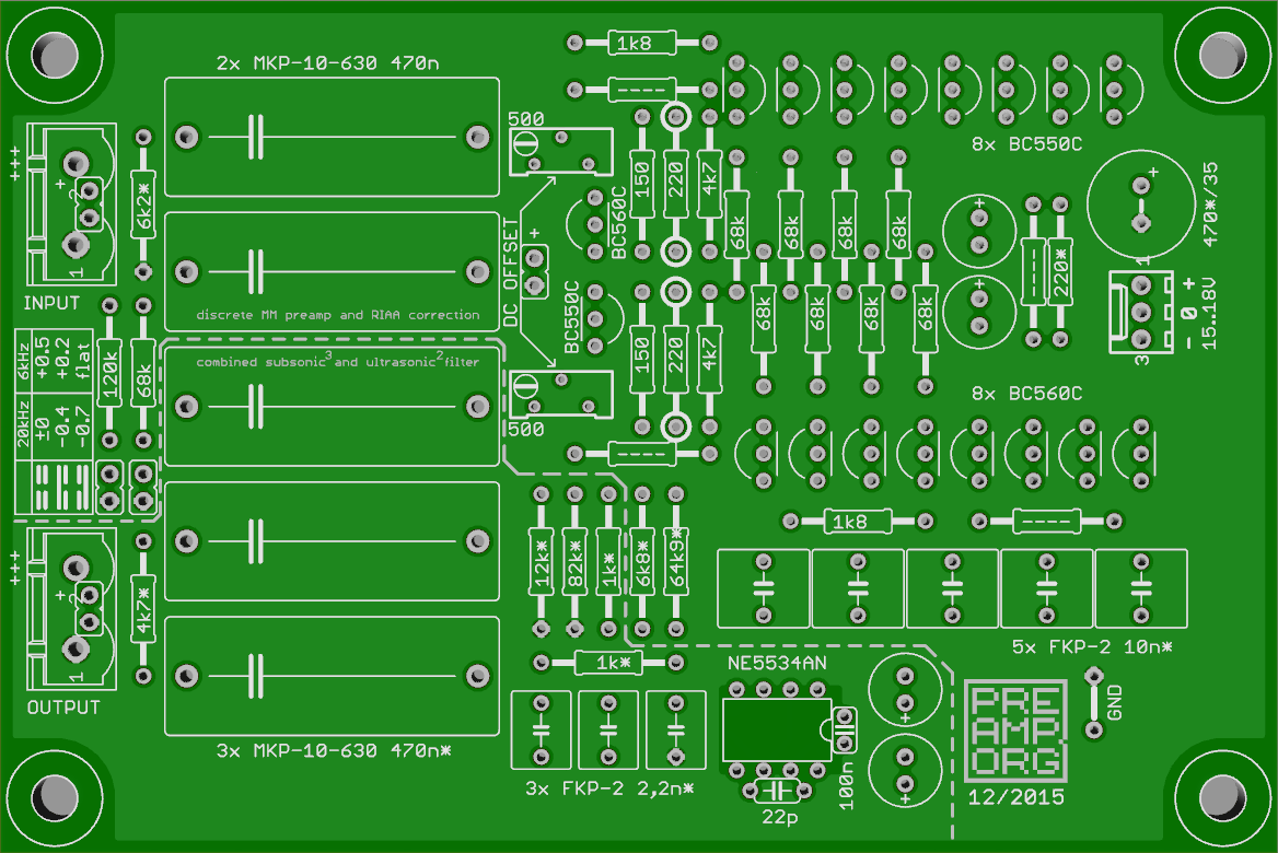

Here's my take on this design. Added some useful things on the board, like a subsonic filter used by Douglas Self and the damped cartridge loading scheme of Bob Cordell's VinylTrak. Simulates pretty good, I'll have to see how the reality stacks up. I had already built a prototype of the supra itself on a small pcb, but it showed some traces of oscillation. That's why I added in some base stopping resistors, hoping that they're sufficient in case they're needed (don't hope so; they add some noise after all). Won't have the boards made this year, though.
Hi
If you use cartridge damping a la Bob you have to lessen the impact of time constant 75us over 8kHz. How did you realise this?
In this case I damped the cartridge completely, so that the response has a -3dB point at 2122Hz already. This way I can leave out the cap for 75us altogether. Noise will be a bit higher, but the input is almost insensitive to input capacitance! If you go the way Bob went and find a compromise in between, you can put a resistor in series with the 75us-cap and adjust it accordingly.

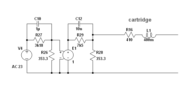

I for one use LTspice and rely on the sim being reasonably accurate in the real world, too 8). The values shown (with the cartridge shown, a cheap AT91) are accurate to within 0.7dB, even with real-world tolerances for the feedback components. Doesn't look like much, but using 47k and some picofarads for a MM cartridge you're off by at least 2-3dB at the high end, which, in addition, is heavily influenced by cable- and preamp-input-capacitance.
Hi
If I uderstood right you are setting in ltspice to the voltage source the inductance, capacitance and resistance identical like for at 91 and run ac small signal?
Elektor India wayback in 1982 July/August edition published "Super low noise Preamp for MM Cartridge". As per my memory the circuit used BC550/560C devices in parallel. Some of our Indian DIYAudio member may have copy of this edition.
That's right. Add an ideal RIAA curve to the source (there're many ways to do that) and the preamp's output should be a flat curve.

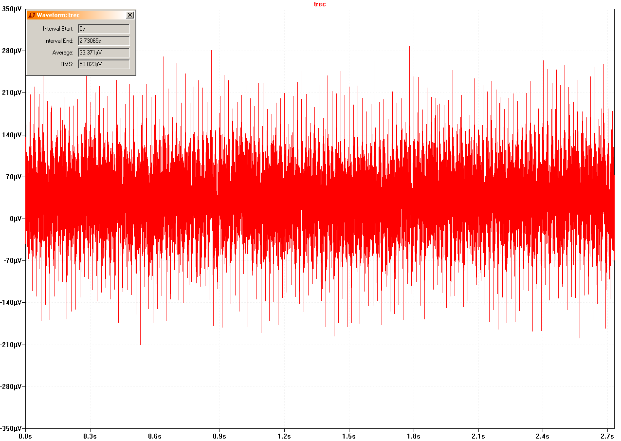

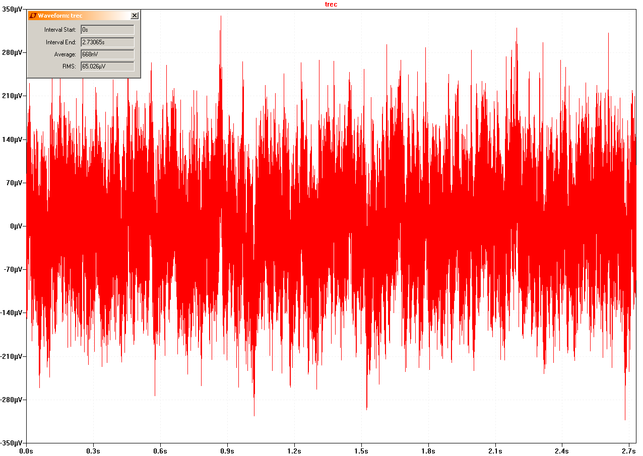

Built two prototypes - one of the supra and one of a simple non-inverting opamp circuit using the same RIAA network scheme and a socketed NE5534A. I powered them with a +-15V lab supply, shorted the inputs and recorded samples of almost 3 seconds each, using ARTA. The recorded data was then saved to a text file, imported into LTspice, and let the waveform viewer do the dirty work of integrating the voltage. Note that the waveforms show some periodically repeating spikes, which is simply noise picked up from the environment or the computer itself.
The NE5534A has a noise voltage of 65uV, while the supra is considerably lower with 50uV. Looks good so far 😎
In actual use the noise will be somewhat higher due to the cartridge impedance.

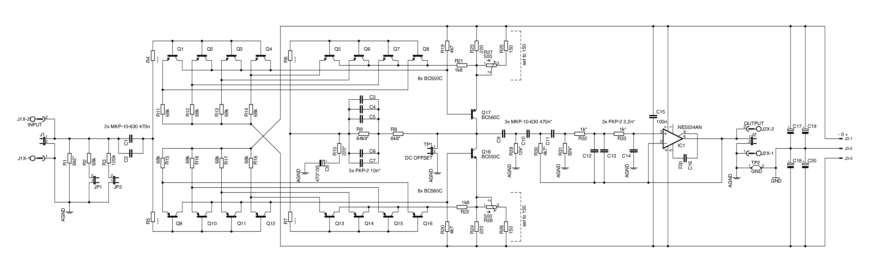

ELEKTOR themselves have an upgraded version of the SUPRA RIAA preamp!
Which is not thought through thoroughly, though. (What a sentence 😀)
First point is that the current noise of the LT1028 is rather high, which is detrimental at least for the MM version and totally swamps the better voltage noise specs. Second point is that the LT1028 has a built-in bias current cancellation circuit which makes the noise behaviour even worse in this case, as pointed out by Self in Small Signal Audio Design. Third point is that using several expensive (!) opamps in parallel totally defeats the purpose of this design. All that said, one would probably be better off using multiple NE5534A (not NE5532A, as they're a little bit worse) in parallel! That would be cheaper for sure and probably even better than with LT1028's - but not cheaper than the original supra.
