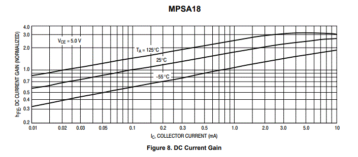

Someone mentioned the mpsa18 in this thread, and Mark's data about quasi-saturation - that is not an issue for me, as I will run them well below 10mA, if I use them for my I/V converter (yet another one).
My question is about the hfe. Is there a purpose to the slope in the hfe x Ic curve? Is the slope intentional, or just a byproduct of the proccess (which has high hfe)?
edit: is that slope useful?

I'm no device physicist, but the hFE roll-off at low currents is just due to non-idealities, irregularities in the crystal lattice and that sort of thing. In fact the non-ideal base current that causes the roll-off usually has a substantial amount of 1/f noise associated with it, so transistors with less hFE roll-off are likely to have less 1/f noise.
It is a result of recombination in the base emitter junction, and is more a question of the device geometry, carrier mobility and doping profiles rather than lattice imperfections.
The effect continues rolling downwards at the same slope down to pico-amp Ic.
Notice that although there is a clear effect with temperature, the slope is a constant.
