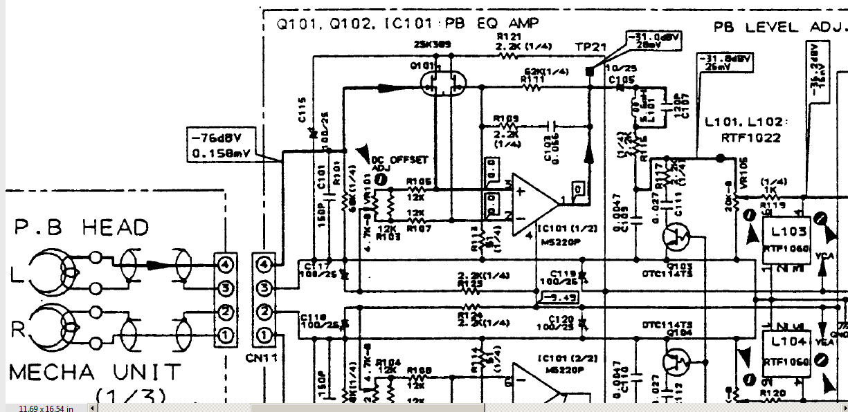

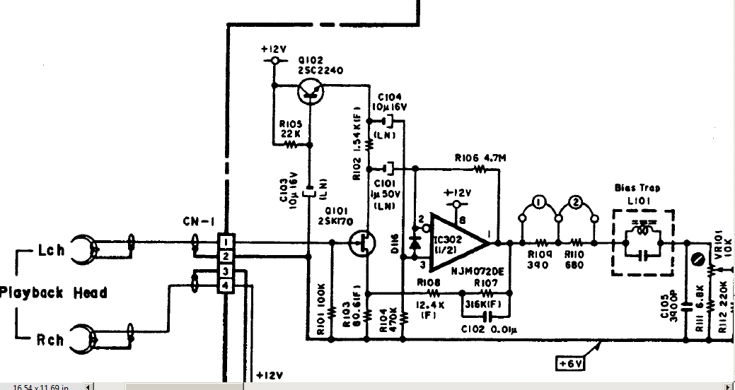

in this circuit, the noise of the first stage will be amplified by the closed loop RIAA gain of the op amp as that dictates the total amp gain. The JFET's have lower voltage (Hi-Z) noise then the op amp, so lower noise levels are achieved.
To clarify, the reduced noise in the opamp with external LTP circuit comes from said LTP having (a) lower voltage noise and (b) a good chunk of gain that amplifies said voltage noise so much that it dominates opamp voltage noise.
(You then have to get rid of said gain at high frequencies to make things stable by the time the opamp hits unity gain, as it obviously adds to opamp GBW.)
So here the extra gain is basically "hidden" inside the feedback loop.

* For reduced voltage noise you need to provide voltage gain -
* For reduced current noise you need to provide current gain!
So if you have a bipolar opamp with low voltage noise but plenty of current noise to contend with (especially with unbalanced impedances as typical for an MM RIAA), say an LT1115, what do you do? You give it a pair of low-noise JFET source followers as an input stage. Input voltage noise is now the RMS sum of JFET and opamp input voltage noise (and probably still quite low), while the low output impedance of the followers makes opamp current noise irrelevant, and only the JFETs' own super low input current noise is relevant to the outside world.
Obviously it doesn't make a great deal of economic sense at this point (super low voltage noise opamps are not generally cheap), but still. Using a follower input has actually helped out condenser microphones, which are a double-digit pF source impedance, as it greatly reduces input capacitance and as such made for substantially higher signal levels. That's how they managed to make LDCs with 3-5 dB(A) worth of self-noise, rather than the more typical 14-18 dB(A).

...Now, there's a problem with the Pioneer ct-93 design...the drain current and VDS looks like it works under the Miller plateau or very close to it ...and that means higher current noise, much less popcorn noise and much higher gm.
