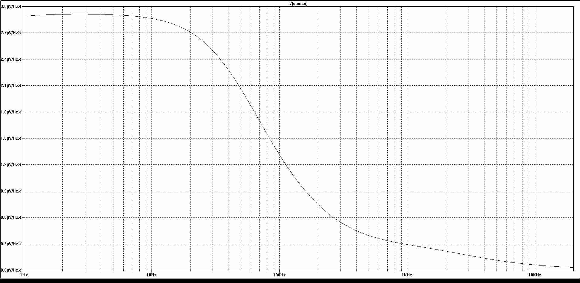

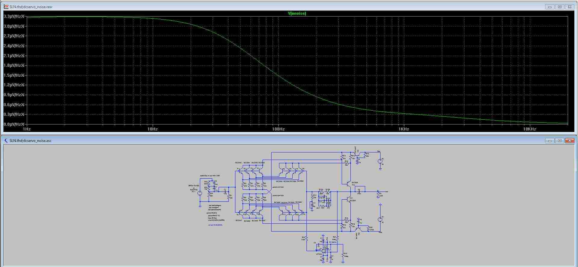

I made some noise simulations, shown above, but I need someone to interpret them for me, which they have such a shape, in frequency and phase.
In which post are those noise simulation results and are they in a format that can be read without LTSpice?

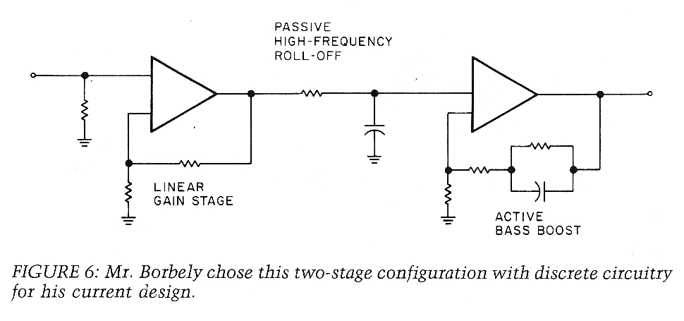

Erno Borbely had suggested a good compromise, using two preamp discrete stages. the first passive, the second active.
As the FETs he used are not available anymore, I have been looking for discrete or opamp stage to used to update that design.
What you mean passive feedback, nonsense. You have passive filtration between two stages, feedback is gain control. First stage is ultra low noise input buffer with appropriate gain (MC/MM), than passive RIAA filtration to ground; next step is stabilizing gain to output with max 100 Ohm impedance to exit. This is approximately lower phase shift possible solution. In opposite case you got maybe better curve, but dead sound. In my neighborhood there are many producers of classic turntables (Kuzma F. /Stabi-Stogi/ 15 miles away; Mezek P. /Pear Audio/ 5 miles away, MAG-LEV Audio 50 miles away) After 40 years’ research, maybe I know something.
Besides my wrong expression, as I meant passive RIAA instead of passive feedback (which doesn't exist), my experience with passive RIAA interstage feedback discrete preamp, resulted in quite an uninteresting sounding preamp. Boring to listen to.
Sorry if I do not agree with your expression that 40 years research make you "know something", as if that something was all there is to it. It maybe a hundred years and still know just part of that something, your version and opinion of things.
Erno Borbely, who also got world respect in the audio circles, certainly had a lot of years, and on his The Audio Amateur article he analyzes all the options, and got to the one I showed as the best compromise. He analyzes every option thoroughly.

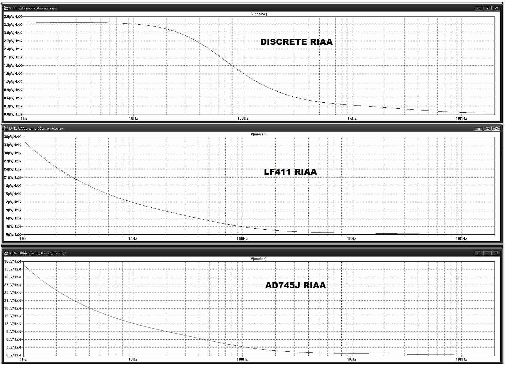

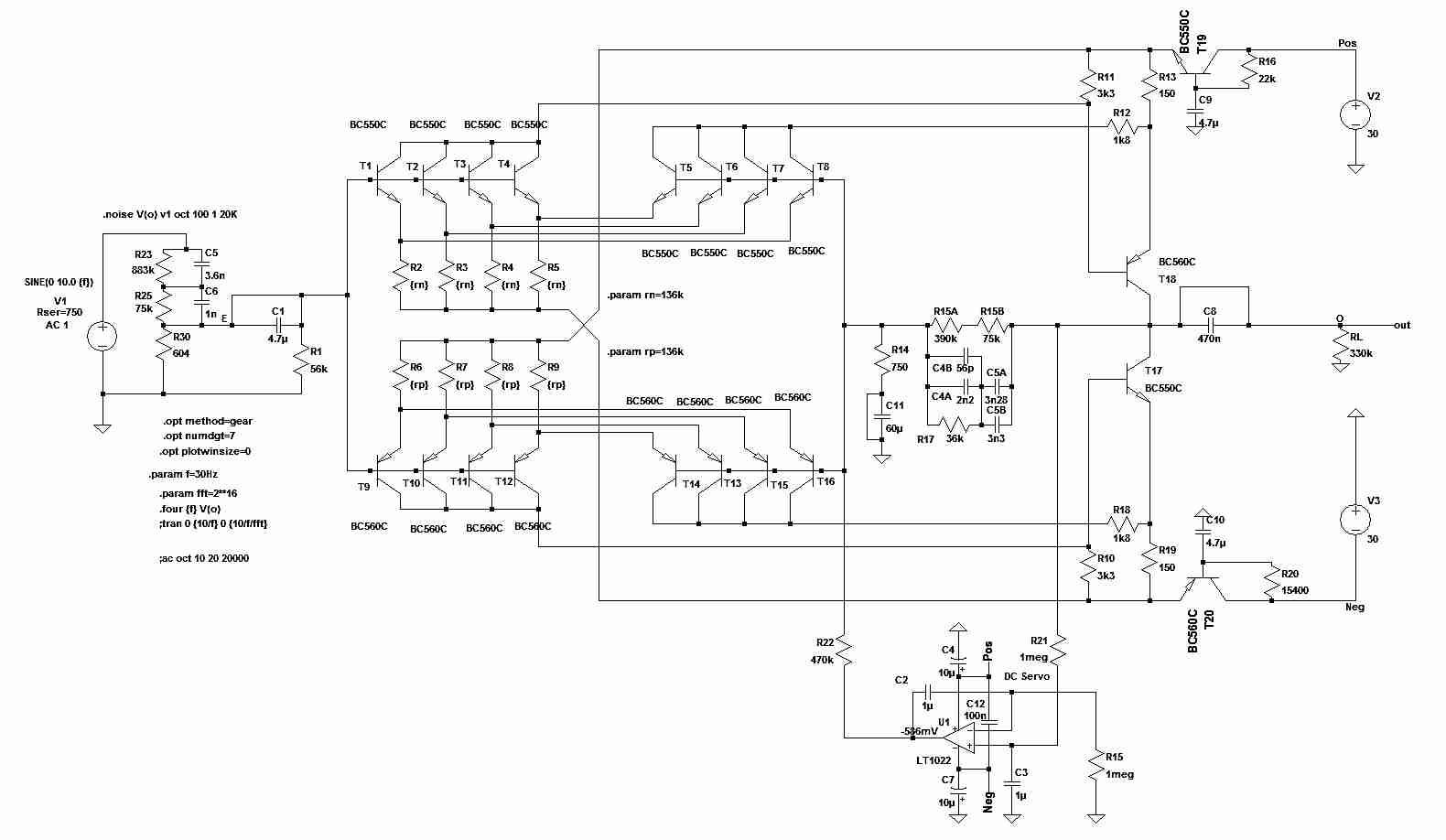

These are the noise curves I got from the SLN and from the opamp+buffer preamps.
The second and third plots indeed look suspiciously similar, although there appears to be some difference at higher frequencies. In fact the AD745 amplifier appears to be slightly worse than the LF411 amplifier at 1 kHz, which doesn't make any sense at all when the gains are similar. An AD745 produces 3.2 nV/sqrt(Hz) of noise at 1 kHz, while an LF411 produces 18 nV/sqrt(Hz), both with negligible noise current.
Could you plot the graphs with logarithmic Y-axes and check what the gains are at 1 kHz?
Did you look at the schematic IRIAA as source with a high enough resistance level there the op-amps will make no difference? A lot going on wrong here.An AD745 produces 3.2 nV/sqrt(Hz) of noise at 1 kHz, while an LF411 produces 18 nV/sqrt(Hz), both with negligible noise current.
I thought the output resistance of the inverse RIAA filter was <= 604 ohm, or was that a different version?
Sorry I can't read the schematic enough to tell what the resistive part is at @1k.
Why don't you use a voltage controlled voltage source and model the inverse RIAA with Laplace transform? You'd have more freedom do model cartridge impedance then.
