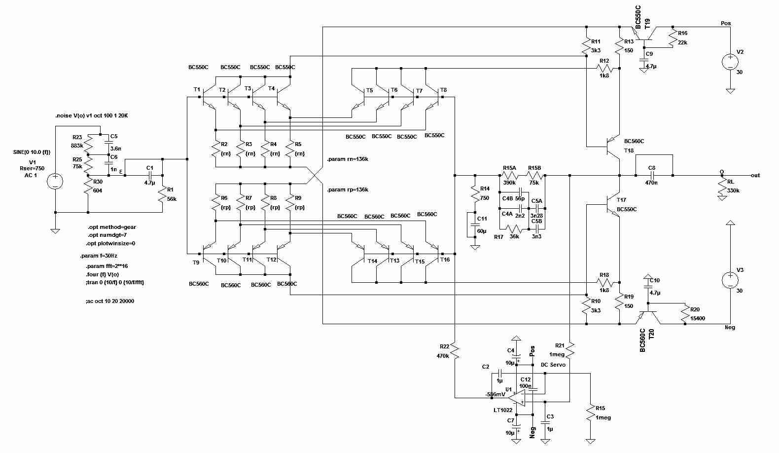

According to the schematics it's about 25uA per transistor (30V/160kohm/4/2) or 50uA/pair tail current. […]
That's certainly not right.
The Amp consists of paralleled differential pairs, each having it's own 136k resistor (8 in total) according to this schematic https://www.diyaudio.com/forums/att...-bc560-low-noise-riaa-sln_noise-schematic-jpg
The calculation is therefore 30V/136k/2(Diff Pair) = 110 uA
And I don't think there are some current sharing issues….

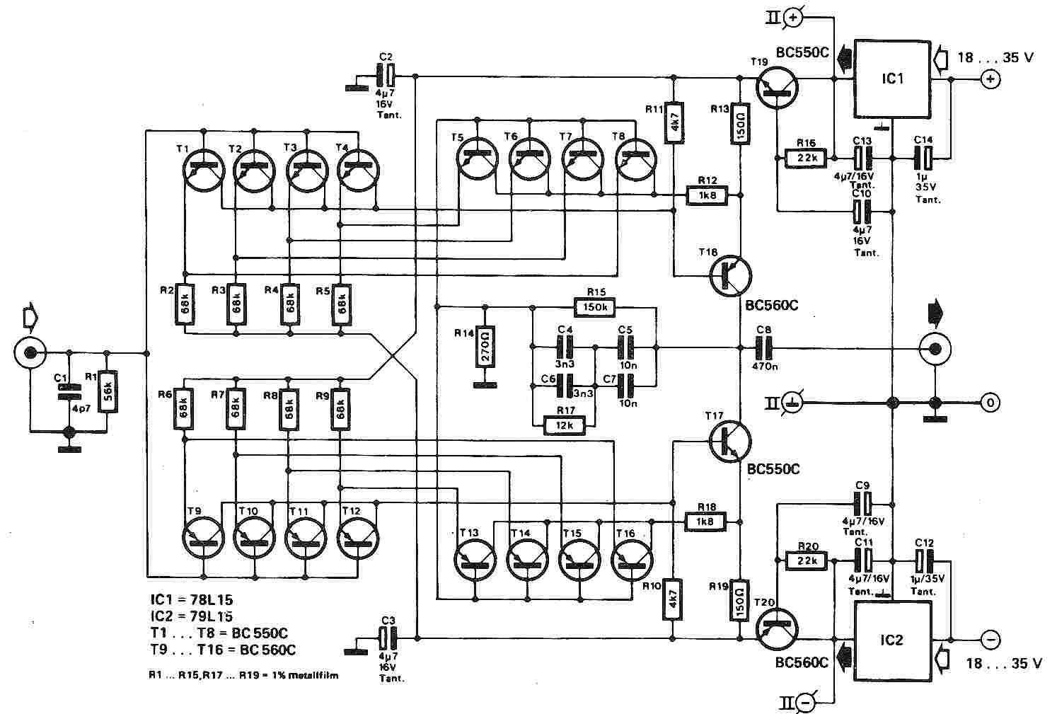

The original one, as published originally by Elektor magazine, is this one.
The transistors were supposed to be all C types, now probably hard to find.

For the Elektor schematic, you are correct. However, with these currents and C class transistors, the noise balance is about the same, improper (in my opinion) for a MM cartridge. It would work fine (noise wise) for a MC cartridge, however then you have the much debated trade between an input capacitor vs. DC current flowing through the cartridge (p/n base currents will never cancel out exactly).
For a MM cartridge, a low noise jfet input op amp (like the OPA827) is IMO all that is needed. Of course, then comes the "three legs good eight legs bad" debate. Low noise discrete jfets are still available to help.

According to the schematics it's about 25uA per transistor (30V/160kohm/4/2) or 50uA/pair tail current. The BC550 data sheet https://www.mouser.com/ds/2/149/BC550-888526.pdf goes as down as 1mA Ic for the DC current gain chart, but assuming the average Beta is still 200 at 25 uA (which I doubt) that would be a total current noise of about 0.5pA/rtHz. For a 0.5H MM cartridge inductance at 10KHz (~32Kohm) that's already 16nV/rtHz flat noise, or about 1.2uV averaged in 20-20k (napkin calculation). Almost too high even for a MM with 5mV @ 5cm/s since the S/N is 70dB, too close to the vinyl surface noise for my taste.
10 kHz is a bit exaggerated; when you take a weighted average with RIAA and psychoacoustic weighting, the impedance at 3852 Hz (A and RIAA) or 5179 Hz (ITU-R 468 and RIAA) is more representative.
Note that the infamous 47 kohm termination resistor already produces almost 0.6 pA/sqrt(Hz) of equivalent input noise current. This noise contribution can easily be reduced by using combinations of series and shunt feedback, like RF designers normally do.
An I haven't considered yet the flicker noise, the 1/f noise frequency corner (usually in the KHz range), the (rb+re)/4 noise and the 3dB noise loss because of the differential uncorrelated sources.
Actually the flicker noise of bipolar devices is mainly current noise, and the source impedance is low at low frequencies.
Perhaps with C class transistors with Beta=800 this schematic would make some sense (strictly from a noise perspective), although it is still lacking current balance resistors in the emitters (otherwise some of the transistors will certainly be blocked due to the Vbe dispersion), which in turn are worsening the input referred voltage noise.
It's usually not too difficult to select devices that match within a few millivolts from a bunch of transistors, but I agree that that needs to be done to be sure you don't get this issue.
But IMO paralleling so many bipolar transistors here doesn't make any sense and IMO, in general, using bipolars for a MM is a bad idea. That's why we still have low noise jfets that would do a much better job.
I agree completely with this. JFETs make much more sense for moving magnet as far as I'm concerned, although bipolars with a sufficiently low bias current can also work acceptably.
That being said, when you only care about the noise with a record playing, you have to make a very suboptimal design to really get decibels of SNR loss.

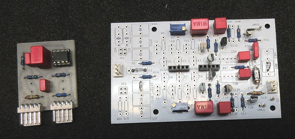

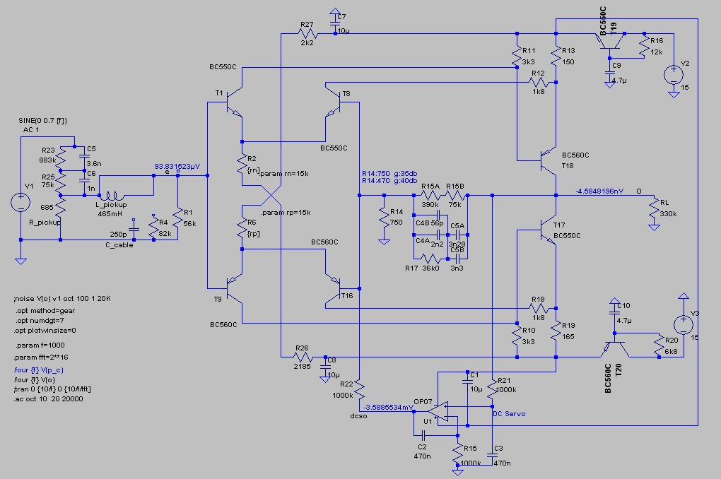

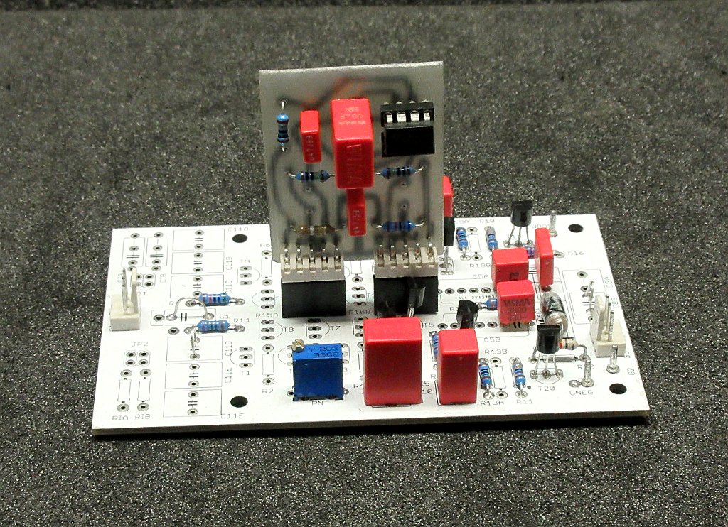

In the meantime, I've been working a bit on the Supra / SLN circuit as posted from #157.
As has already been criticized several times, the input capacity of the circuit with the BJTs connected in parallel can be too high for some MM cartridges. I experimentally built the circuit with just one input pair using the existing PCB, that works too. But I don't have any pickups that are critical in terms of capacity, so I can't say if that means an improvement for those.
In addition, I was able to modify the existing circuit board quite easily in order to attach a DC servo.

By capacity you mean capacitance?
What cartridges did you use the preamp with?
Can you upload the asc file so I can compare it with mine?
One thing that I did try was increasing the voltage to +/-30v, and the results were superb. I'm not sure you can use the 550/560, because I think voltage is too close to their maximum.
Another thing to consider is using THAT complementary transistor chips, which can be a good option.
Have you tried the SLB with and without the DC servo?
You will have to prepare voltage reductor for servo if you insist in higher common voltage, nonsense. If you measure transistor transition speed is current on first pair main factor, not increased voltage. I think 1mA is optimal. In any case, you have enough headroom for any kind input signal with +-15V. I already made own scheme and RIAA preamplifier with current feedback topology and have on output 20mA (BD139/140) in purpose of following stages with lower impedance to get perfect undisturbed sound.
