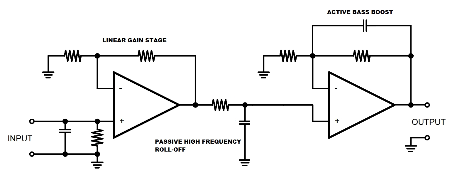

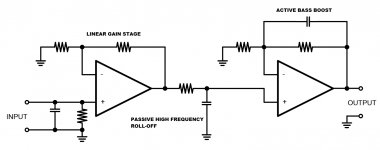

This implementation of passive LP and active bass boost might be the best choice of all possibilities for RIAA equalization. For an aqdditional 20 Hz roll off we might perhaps want to put a suitable capacitor in series with the bottom resistor of the 2nd opamp's feedback loop.

And I don't think there's worrying phase shift on the discrete or opamp preamps.
Yes, you have seen four transistor, but in real there are two bases (NPN II PNP) direct on input only, other pair are constant current source 300uA. On dipswitch you can find 100 Ohm; 470 Ohm and 47kOhm, 47p and 1nF. Phase shift is very important for real sense of music and 3D stage. This is not exist in OpAmp's configurations, maybe is a bit lower noise figure, but without any living. This is my opinion only.
Adjustments were made on the capacitor and resistor load. And by listening.
So excuse me if I do not quite agree with getting optimum results "by accident".
Not that I was expecting you to agree 😀.
You are conflating two different issues: loading the cartridge (with the side effect of possible resonances in the audio band) and the optimum noise figure. These are different issues, both related to the cartridge (source) impedance.
As others have already mentioned, you don’t need a very precise MM model to address both issues. The DC resistance and the inductance are usually both specified in the MM cartridge data sheet.
All the extensive high quality LP years passed by with no cartridge models, and comparisons were made between cartridges, usually with the same preamp.
Untrue there is a large body of literature on cartridge models dating at least from the 50's.
And how was it applied on reviews?
The cartridge manufacturers certainly had models, which they used to suggest C//R load for each model.
I don't understand your point, are circuit models applied to amplifier reviews? I was under the impression someone was trying to help you understand the noise sources in MM carts.
Yes, Scott. You're right.
The point, if I got it right, is that I am not including the cartridge inductance as part of the input arrangement.
Reviewers very rarely measured noise on their tests, Stereophile perhaps.
Even preamp designers seemed to worry on the noise of the active or passive parts.
Often with shorted input fairly useless.
