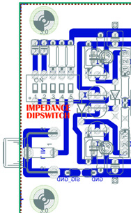

Yes, you have seen four transistor, but in real there are two bases (NPN II PNP) direct on input only, other pair are constant current source 300uA. On dipswitch you can find 100 Ohm; 470 Ohm and 47kOhm, 47p and 1nF. Phase shift is very important for real sense of music and 3D stage. This is not exist in OpAmp's configurations, maybe is a bit lower noise figure, but without any living. This is my opinion only.
There are eight bases in parallel: four NPN and four PNP. Two might be physically
closer to the input, but I don't think that matters, as they are all soldered to the same place.
If we leave just four input transistors, two NPN and two PNP, there are two LTPs at the input, with one resistor each to V- and V+ respectively.
Yes, you may use a dipswitch to select the right R//C combination, or you can simply solder them, eliminating four contacts.

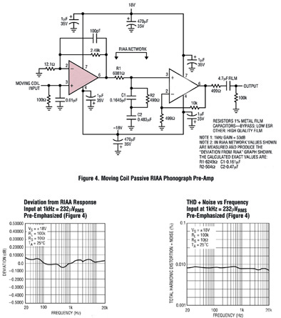

So I went to have a look at two reputable designs: one from Erno Borbely, in The Audio Amateur, and the other a mod made by Gary Galo on and Adcom preamp, which was based on a LT datasheet design.
None of them take noise into consideration, only the cartridges output level, to set the gain, and the LPs RIAA, to set the filters right.
But if I'm not wrong, the original Elektor article did raise the noise question, and why they used four transistors in parallel for NPN and PNP, exactly to lower the transistor's noise.

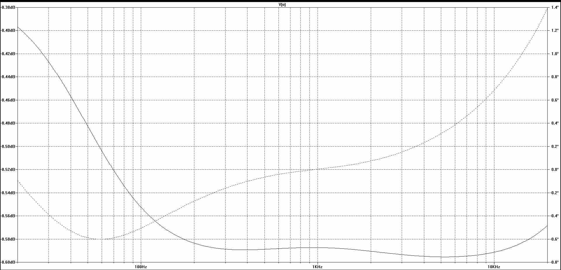

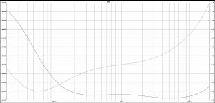

Well, well, well. It turns out the anti-RIAA model is OK, with 604 ohms resistor and all.
http://hifisonix.com/wordpress/wp-content/uploads/2016/12/Accurate-Inverse-RIAA.pdf
And the 604R resistor is not a load for the cartridge, but for preamp.
And the circuit is intended to cut 44.1dB at 1KHz. It was designed by Lipshitz.
http://www.hagtech.com/pdf/riaa.pdf
To simulate MC cartridges the input load resistor changes to 50 ohms.
Below is the FR curve you get from the simulation. Note that the margins in dB and degrees for the phase are very very small, so both can be considered flat.
It's still pending what inductance to add to simulate noise.
In any case, the FR curve simulation you get is quite weird.

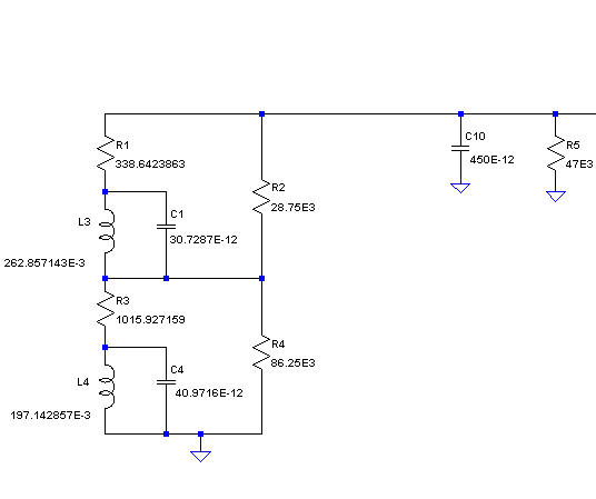

In any case, this is a reasonably accurate impedance model for a Shure V15-III cartridge and its 47 kΩ//450 pF load.
I don't quite understand what are the parts values.

Values are in scientific notation, in F, H and ohm units.
Curious, what are R2 and R4 modelling?
I don't know, but I guess iron losses and to some extent skin effect losses of the coil of the cartridge.
In the 1990's a former colleague of mine measured the magnitude and phase of the impedance of a Shure V15-III cartridge using a fancy HP impedance analyser. The phase didn't approach 90 degrees for high frequencies, as it would with an ideal RL series network, but flattened out around 72 degrees. That means that there were more losses than just a fixed series resistance.
In 2013 I hand-fitted his measured results to the LRC circuit I posted earlier today (but without C10 and R5). It's not a real physical model where each component corresponds 1:1 to some physical effect, it's just a circuit that has nearly the same impedance modulus and phase as the cartridge had.

I am not sure if putting the anti-riaa filter AFTER the preamp and RIAA would be "realistic" for calling it somehow. On all reviews measurements I have seen the anti-RIAA is always applied at the preamp input.
Of course that in tests they also use an LP with an FR sweep track, incorporating the cartridge and disk surface distortion and noise into the picture. Which is what we are trying to simulate.
Perhaps what I was proposing is not the ideal thing, but I have seen very little about RIAA simulation in the web. Maybe because it was not important anymore.
