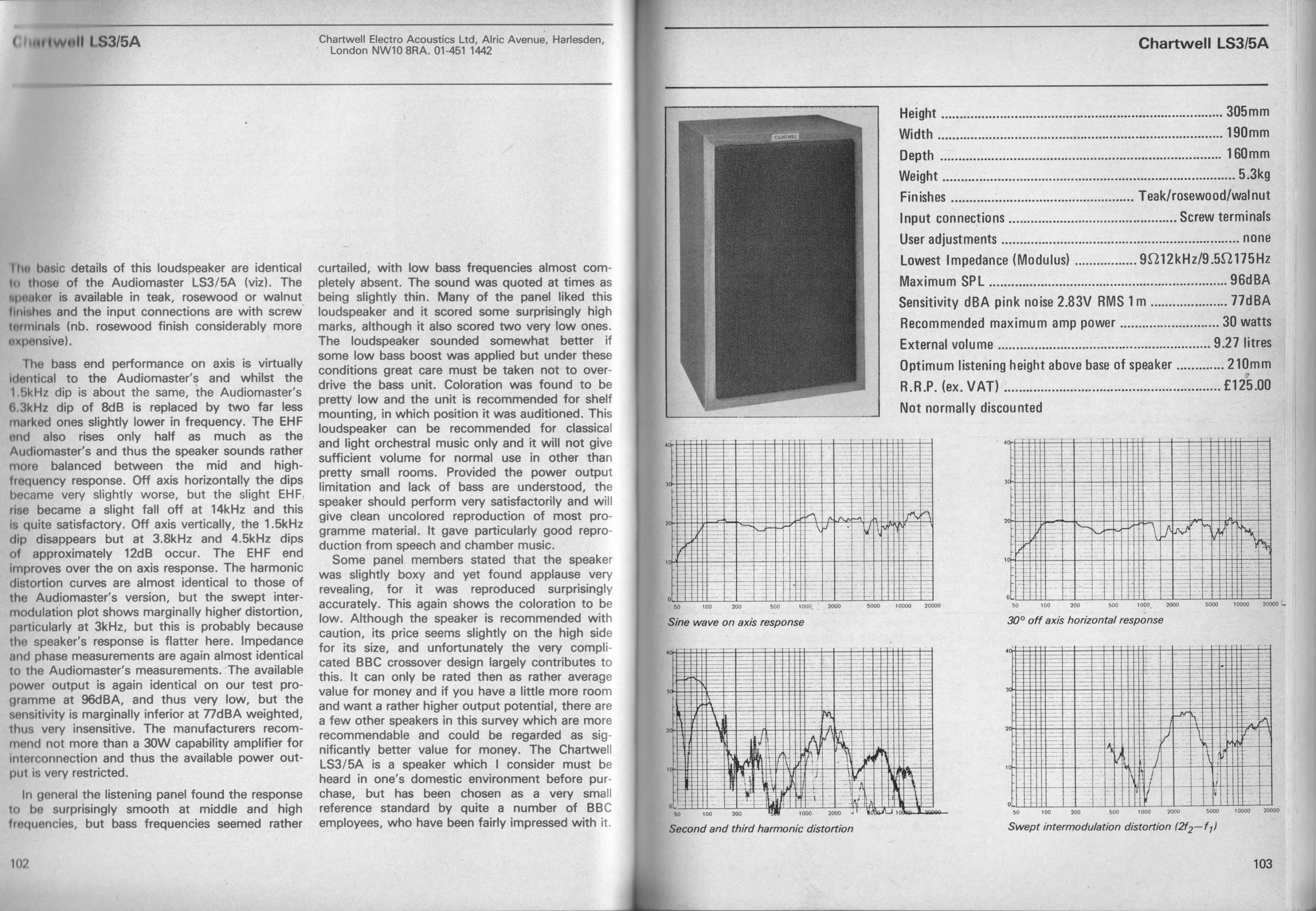

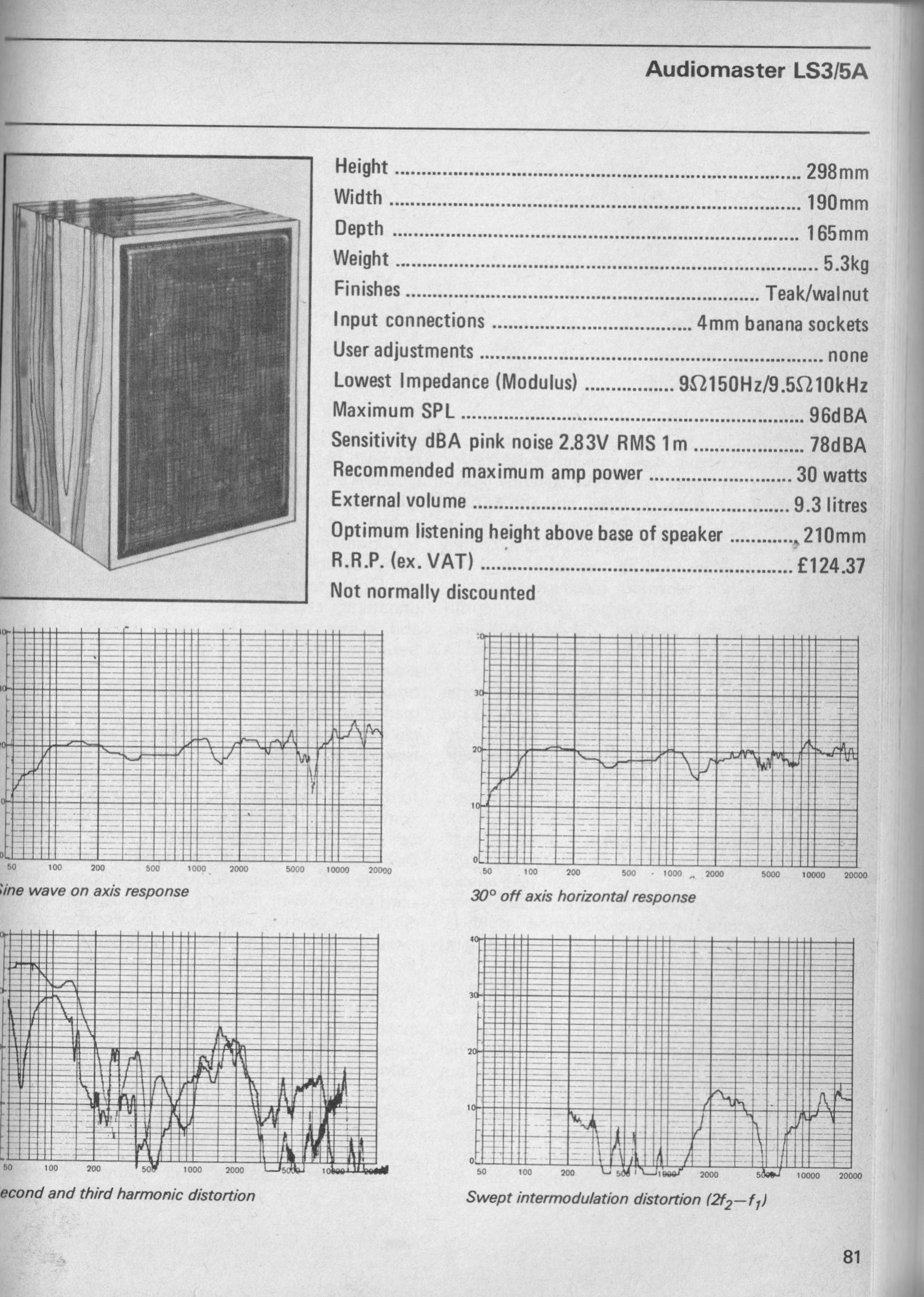

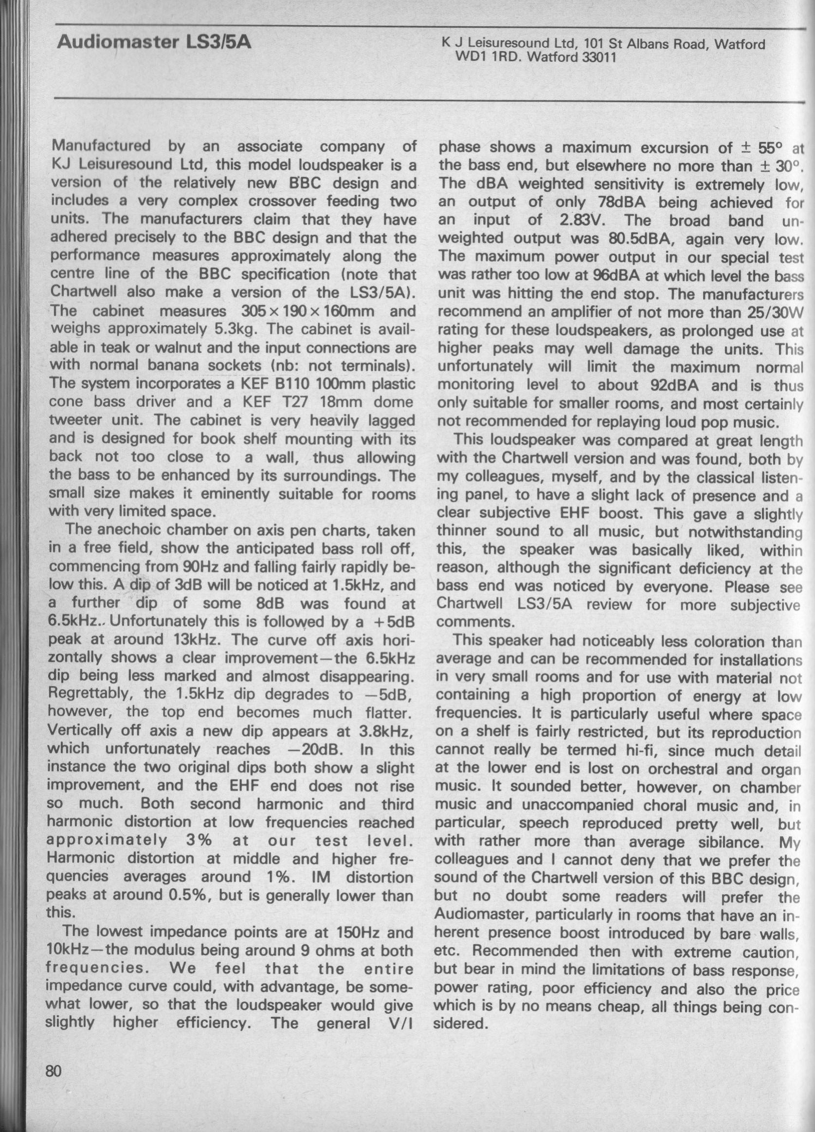

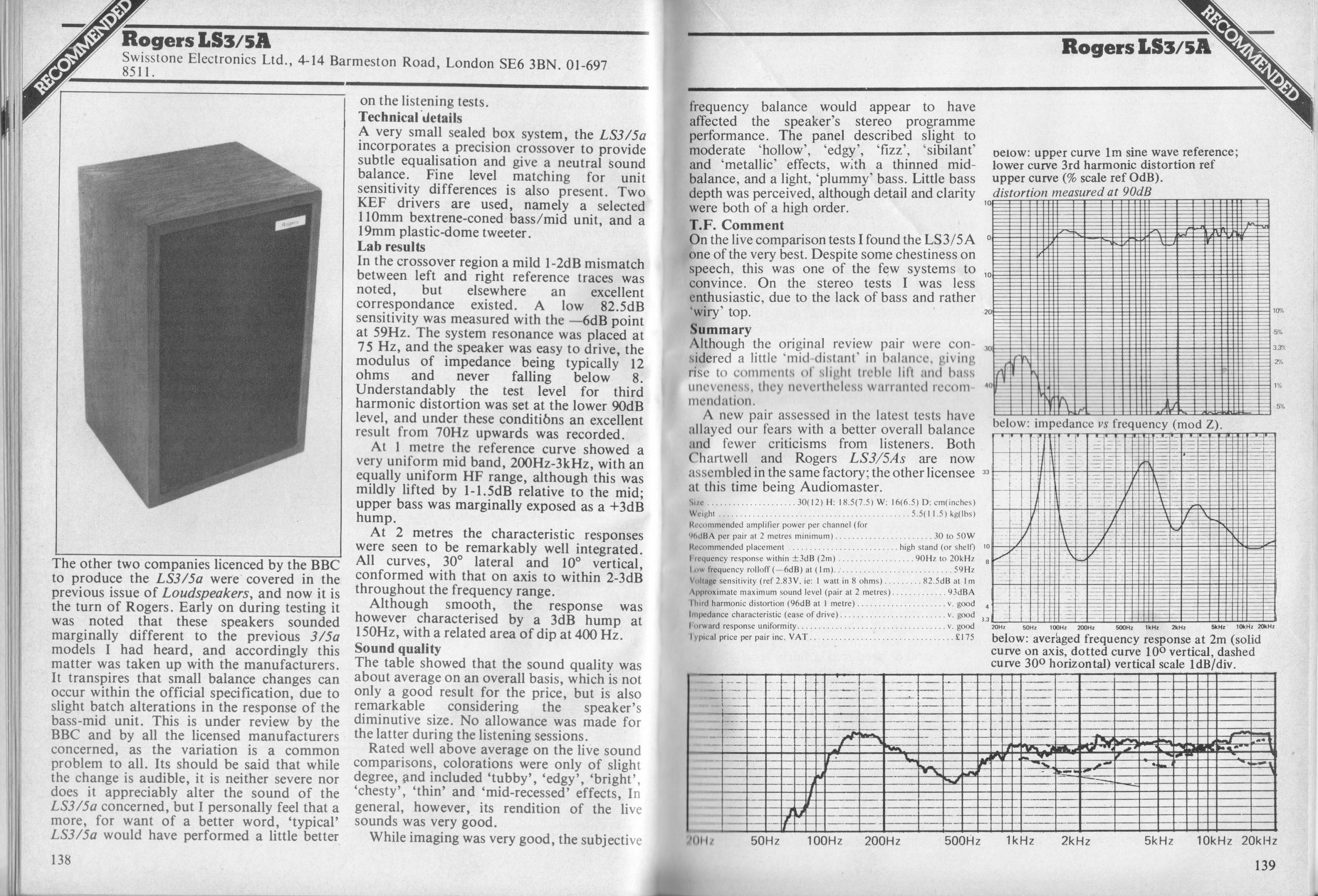

Er, all the LS3/5a I've seen measured by Stereophile measure differently.
Ones in Stereophile could well be out of spec due to age... but my Hifi Choice Loudspeakers review book from 1976 also shows some differences between Audiomaster and Chartwell LS3/5as.
In the review, they like to talk about objective frequencies rather than their emotions towards certain tracks, like they do today... Those were the days!
Here are scans from the relevent pages. Also a scan from a later 1979 review of the Rogers version when chartwell and Rogers were apparently made at the same factory . (My scanner software automatically split the first scan into two pages, but not the others).
