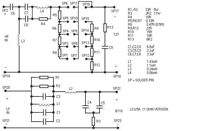

Btw, is this the bonafide LS3/5a (11ohm) XO?
The Yamaha NS10 Story

AMT tweeters are the bomb. I bet it sounds great, probably better than an LS3/5A. Although making a XO without measurement or simulation software is probably not ideal.
