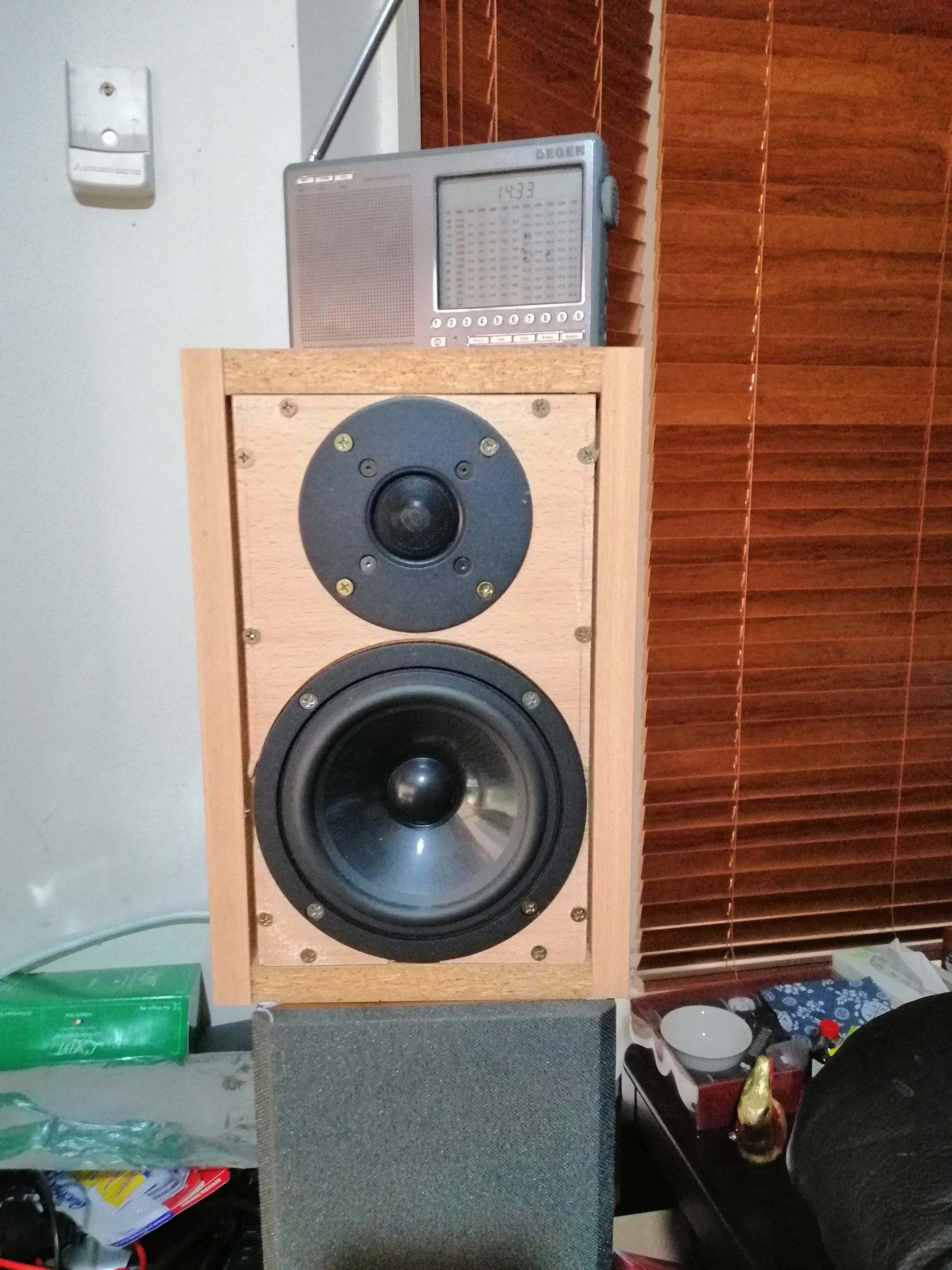

And i did copy the mass damped lossy cabinet system for the tops i use now (see picture). The driver is a Mark Audio Alpair 10M fullrange in an 11.5L sealed cabinet build following that principle, and it's the best speaker i did hear with this driver (and i did build many already) but it also needs a sub...

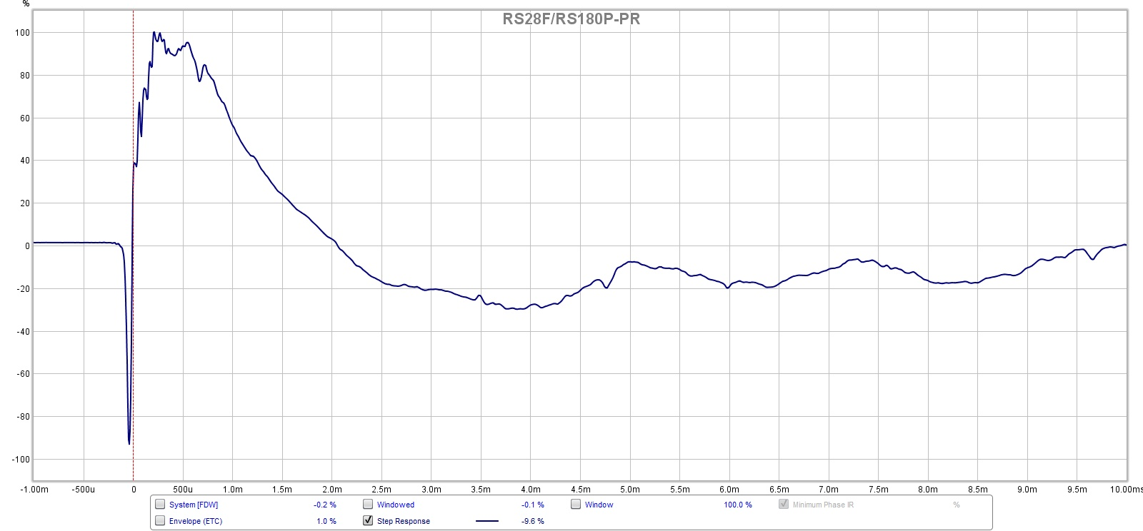

Those are nice measurements for sure. I have a lot of respect for Danny Ritchie’s designs. You might be interested in this bookshelf monitor that I just whipped up a simple crossover for the other day. Uses a Dayton RS28F silk dome tweeter in a Visaton waveguide, paired with a Dayton RS180P paper cone woofer and passive radiators.
Simple crossover in XSim:
Here is the measured response of the simple XO:
The waveguide allowed very good time alignment:
But most importantly, a very wide uniform dispersion (roughly 0deg to 60deg):

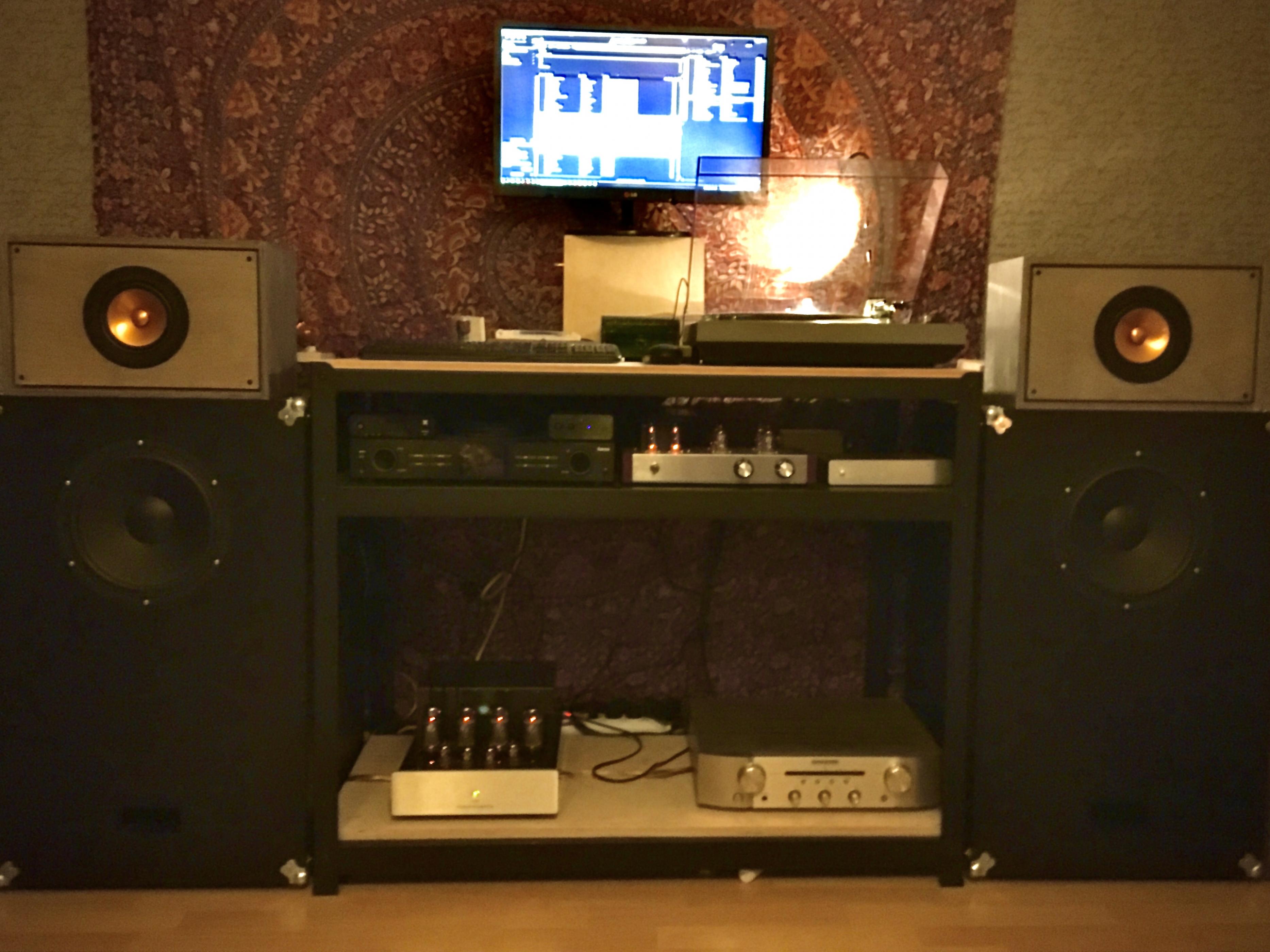

I have been interested in them because it seems possible to use OB in a normal room. Once you listen to an orchestral mass with OB in a very large room, change your perspective. With two DIY 18" closed subwoofer -> MAGIC.
DIY OB, from 2011. Metal body. Digital crossover with Behringer (without mod). The Ultracurve I think was the main responsible for it being unable to differentiate between MP3 and FLAC. And the DAC and... too many bottlenecks.
