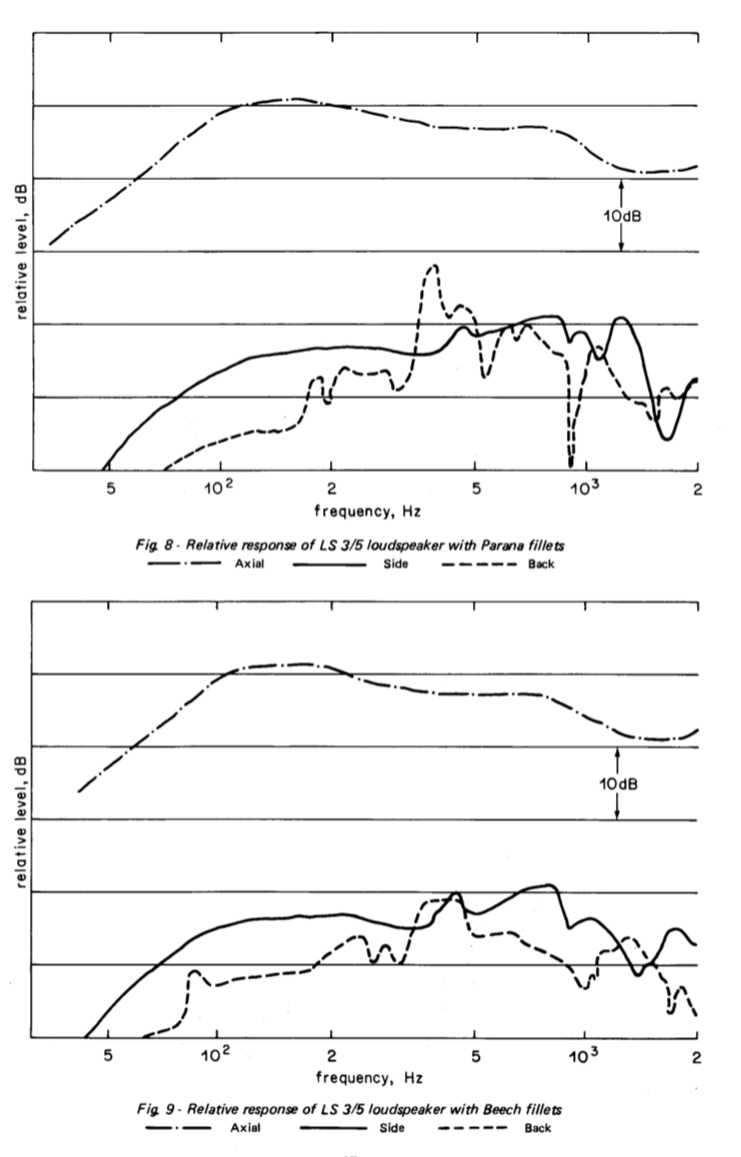

Some interesting graphs of the frequency response and side and back emission of LS5/3 as measured by the BBC in a research report on cabinet materials. The choice of beech fillets (internal spars) was quantified to give lower panel resonance.
http://downloads.bbc.co.uk/rd/pubs/reports/1977-03.pdf
