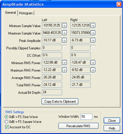

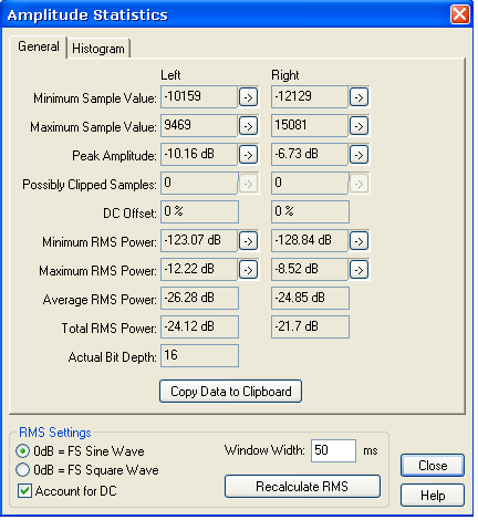

Of possible interest, my Realtek setup does have improved sound at certain times when fed 24, vs. just 16 bits, with everything else the same - in particular, the treble quality improves, becomes more 'pristine'. What the actual reason is, I can't say - possibly an artifact of the processing environment ...

Here is a link to 2 files, both in 44.1/24 bit format. One of them is internally 16bit, (tpd?) dithered. The 2nd is true 24 bit. For those who are interested, please try ABX test in foobar and post a screenshot of your result. The files are amplitude matched, as attached.
https://www.dropbox.com/s/03825zeagilumok/test192_1.wav
https://www.dropbox.com/s/tpobdp76yd2u6ke/test192_2.wav
Have fun! 🙂
One of the files is redbook.
And you, as you claimed a better performance for 24 bit, need to participate to.
