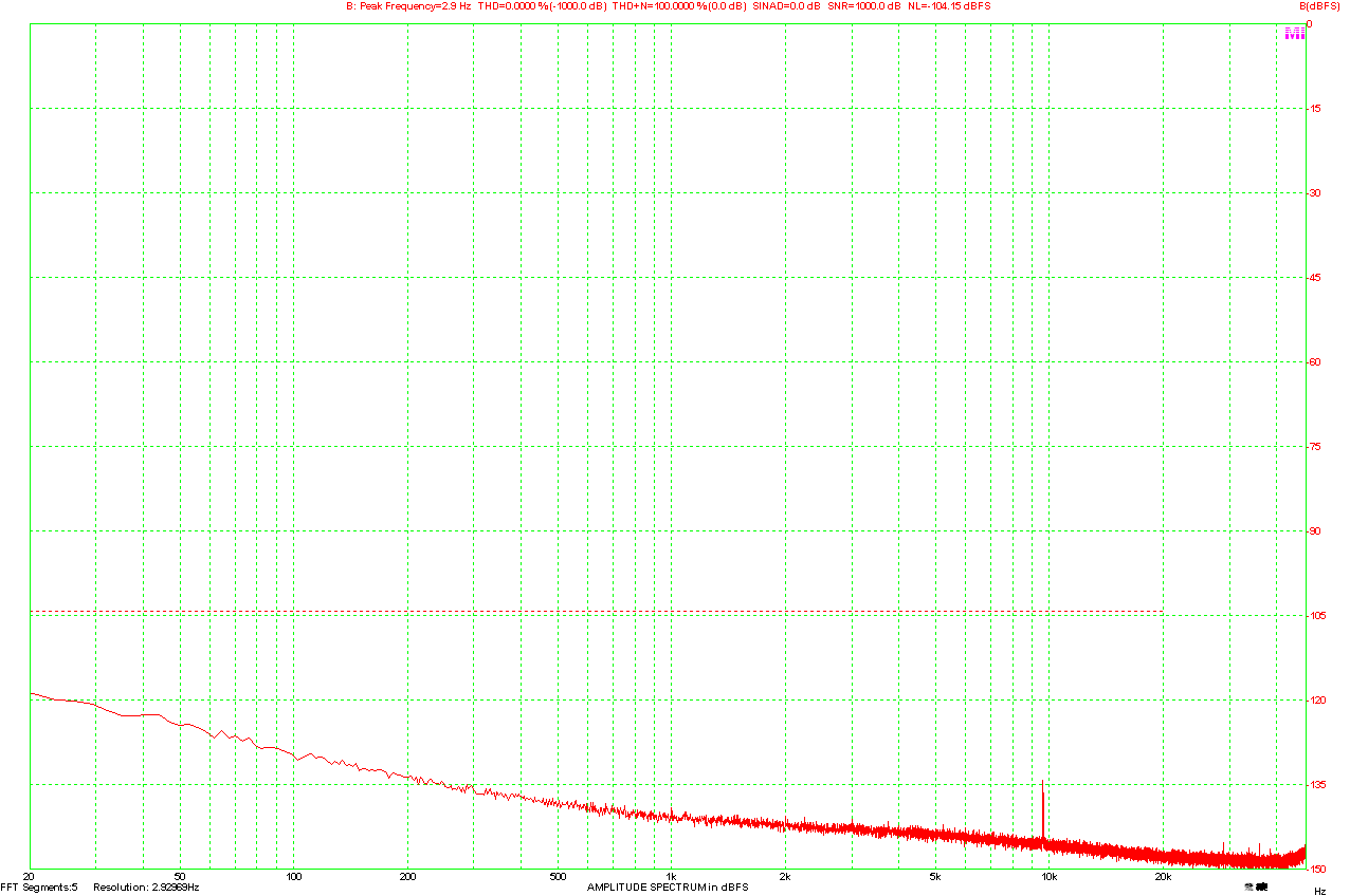

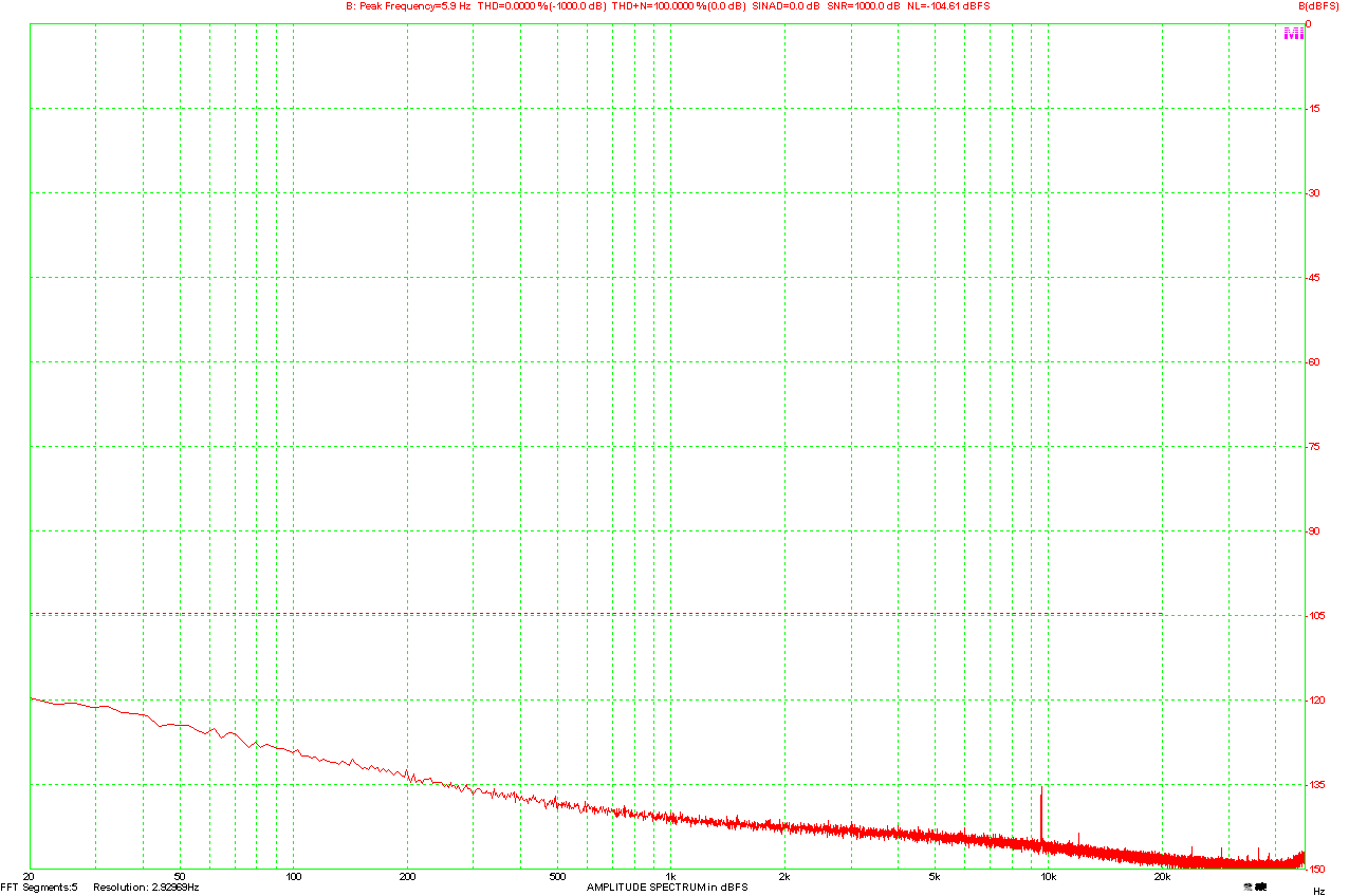

Regarding ground loop obsessions, I am attaching two measurements, one with ground loop and one without ground loop. Can you tell me which is which?
Can't tell. If you say there is one and I had to guess, would also say left.
Yes, the image '10.png'. 10.png is ADC only with input shorted by 50 ohm resistor. 11.png is DAC --> ADC (loop), in fact the 'blue' chain from my 'ultimate' test. The very very small increase in HF is the noise of the DAC. As the DAC has higher quality than ADC (both lower noise and distortion), both plots are almost indistinguishable. The -135 dB line about 9.5kHz is ADC artifact. It doesn't change after DAC is attached. So, with careful design, small groundloop does not matter. If I put signal link transformer to break the ground loop, there is no improvement. The only effect is higher LF distortion then. The DAC/ADC is outside PC case. I agree that with DAC inside PC case there are usually more troubles with interference and with loops that are created through PC chassis.
