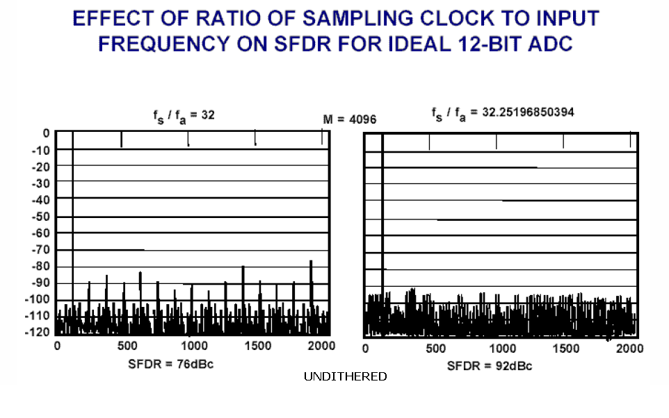

If it's correlated with the signal, wouldn't it be distortion rather than noise?
No, the components are also non-harmonic.

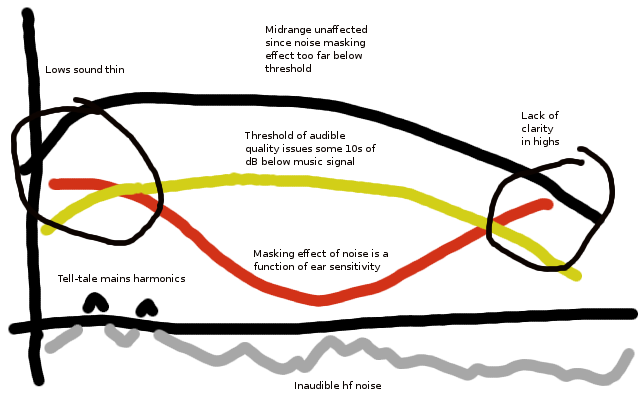

I've drawn a picture of my ground loop hypothesis to try to make it clearer.
It's consistent with all my observations and I've successfully used it to fix the sound of my amp. That doesn't necessarily mean it's the real explanation of what has been going on in my system though.

What is this picture supposed to explain? Aren't you just saying that interference from ground loops is bad?
Yes. But not because of the visible low order mains harmonics but instead because of the higher frequency noise in the part of the spectrum to which the ear is most sensitive which masks the detail of the audio in the regions where the ear is less sensitive.
It's an explanation of why 3kHz interference at -100dB is maybe more significant than it looks.
That's not at all how masking works. A louder signal will mask a quieter one at a similar frequency. Low-level noise in the midrange can't somehow sneak around and mask louder signals at completely different frequencies.
Masking means that the -100dB signal at 3kHz is less significant than you think, not more.
Not that I care since I have no spurious tones like that in my system anyway. 🙂
