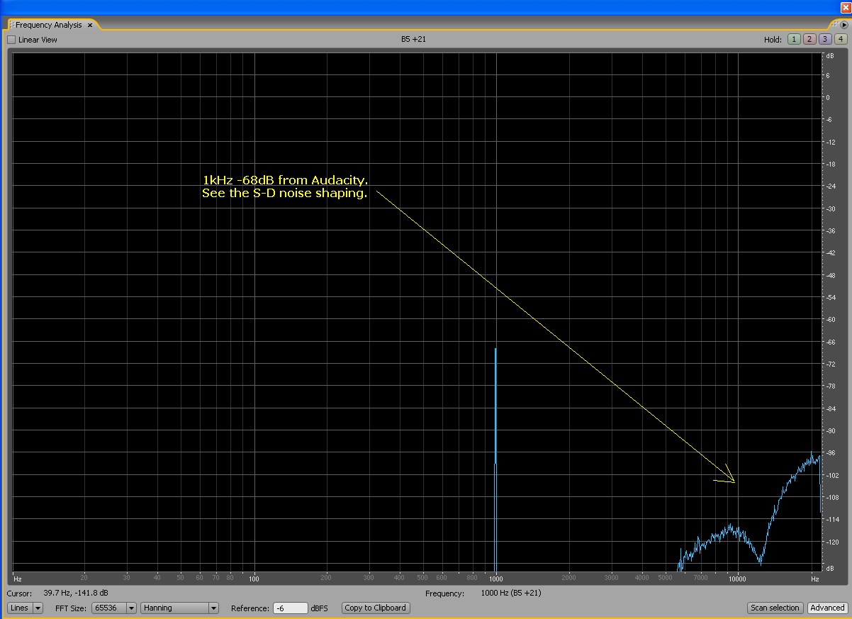

Mooly, the sigma-delta modulator you use is funny 😀. Is it DAC or software that makes all that noise shaping???
I assume its the ADC doing it. I've nothing more sophisticated that a Dell Vostro 3750 and Acer 9301 (an old Acer but it keeps on chugging) laptop for producing files and more importantly A-D conversion.

Mooly, it is the Audacity multi-bit generator that makes the S-D noise shaping (math algoritm). Just evaluated in the file I have generated myself from Audacity. Same is in your files. Was just curious, now I have the answer. Anyway, noise shaping is inaudible, of course, if we use one level. But, it may say something about experiment that Frank (fas42) did yesterday ....... interesting.
P.S.: the plot is moved 12dB up, so the level of the peak is -80dB
Anyway, noise shaping is inaudible, .....
I must make a correction of my statement. The audacity noise shaping is very audible, I have just compared it with cleanly generated files. The noise above 10kHz is audible. For those who need to try low level signals, please try

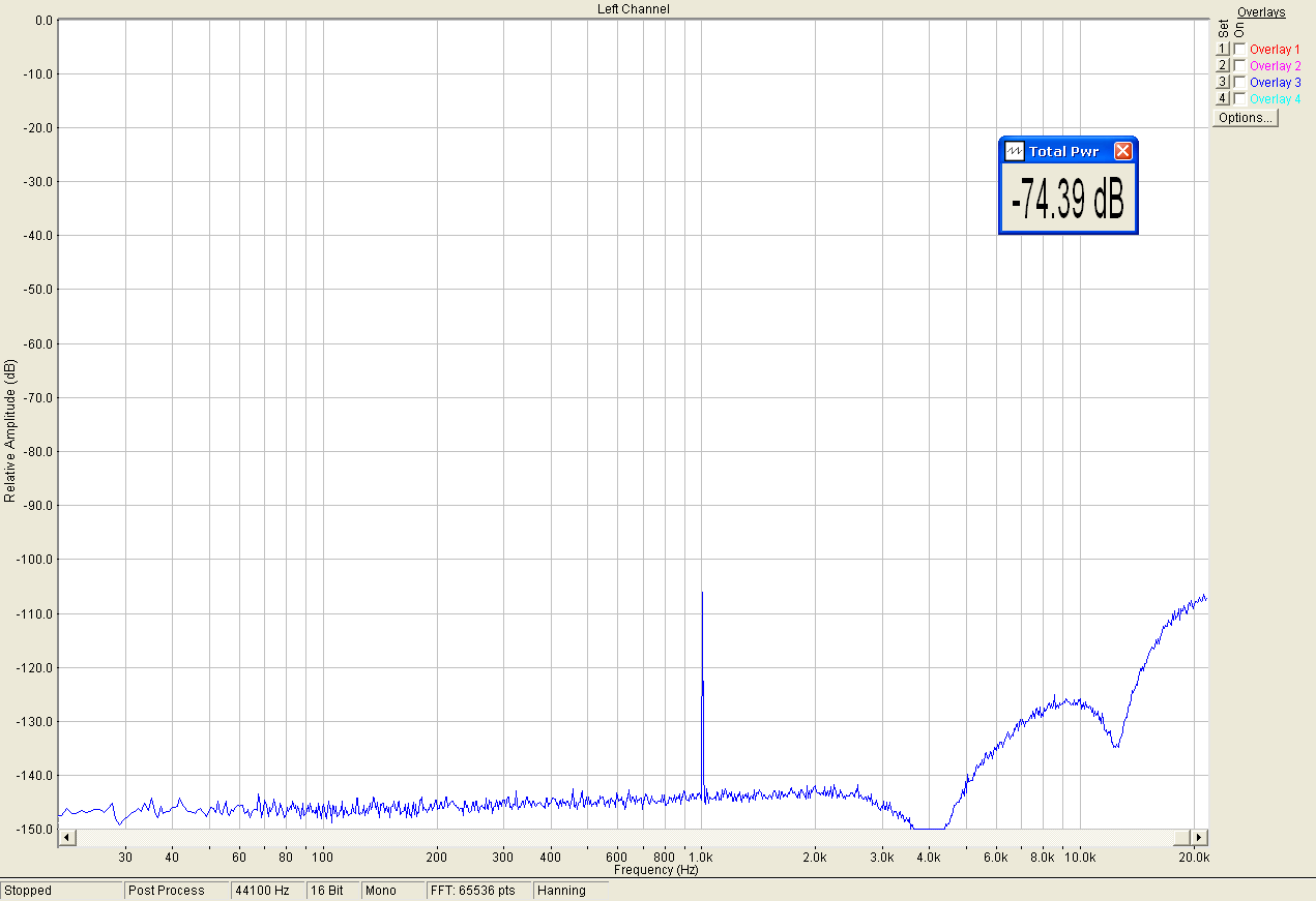

The main problem with the Audacity test file that Mooly have provided is a very high level of noise integrated over 20kHz. It is -74dBFS and the audible signal (there is an audible signal) is buried in noise. The right question asked is WHEN (after what time) it becomes audible.
Total power (-74dBFS) is a rms noise here. For those not familiar with FFT it might be confusing, but the spike you see is in fact buried in noise.
Yuk! Can you recommend a software signal generator that works better than Audacity? 😱
I think you can turn off dither in the quality settings.
Of course!! From freeware, please try ARTA
ARTA Home
Then you can generate completely clean 24-bit signals without noise shaping. Audacity is tricky for serious work. Useless, in fact.

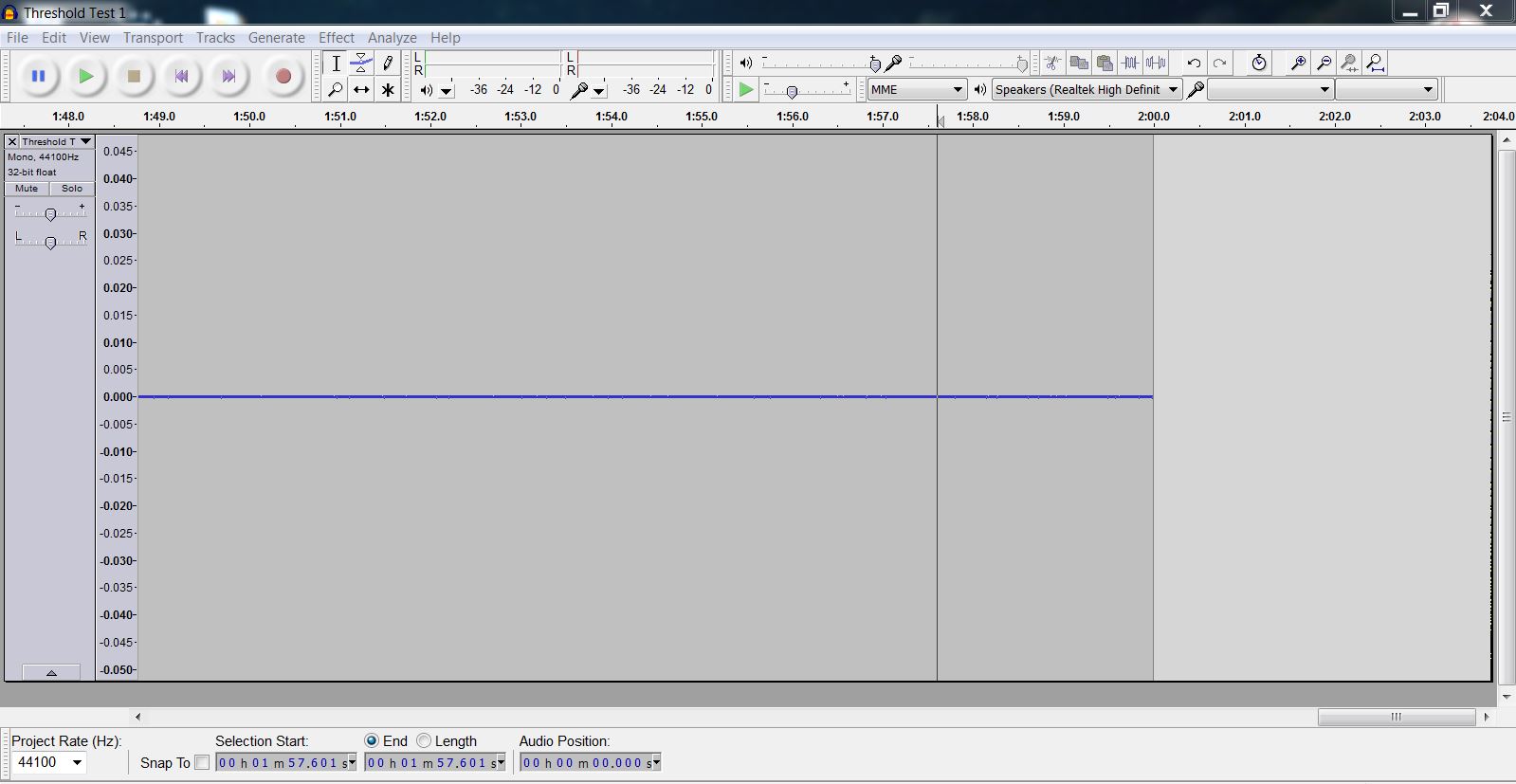

Worse system may perform better in this last test![]()
So mine is seriously seriously E+6 bad then
On speakers listening approx. 9 ft away I can reliably pick the tones out of the noise at around 17 to 20 seconds in. That is playing the files direct off USB in the Marantz. The white noise I hear isn't from the amp because it drops off to next to nothing when I pause the player. The tones stand out quite cleanly though.
Pretty similar picture with the Sony headphones plugged into the Dell too.
The picture showed how the signal looked in 😱 Audacity.

Yes we know it was the amplitude sweep 🙂
😛 I am in awe at your skills handling the files 😀
Its all new to me... I was just thrilled to find Audacity had a record level control after you all complained of clipping in the opamp test on the Bach... but I'm learning slowly.
